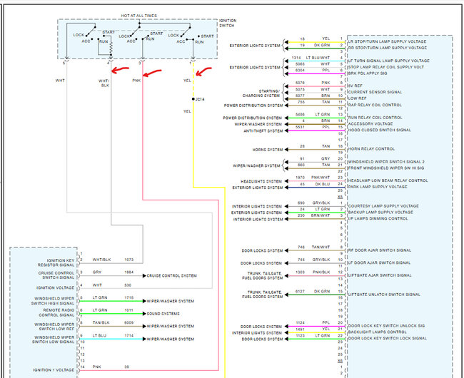

Had RAC out to look at my car and unfortunately couldn't get it to start. I was told that the immobilizer is possible faulty.
non start
cranks wont fire
onlive data showing good rpm signal and good fuel pressure
immobiliser fault logged on scanner
suspect immobiliser fault

With the key on, not cranking the engine over there is no security light on steady? Let's check for power coming out of the ignition switch when on.
Here is a guide to help with the ignition switch wiring diagrams below:
Check out the images (below). Let us know how it goes.
May 5, 2025 at 3:00 AM

Okay, that is normal. Please check the power above again, I updated it. It seems like the modules are not getting power.
May 5, 2025 at 3:05 AM
KNIGHTY06041
  • 7 POSTS
12.16v at the ignition switch.

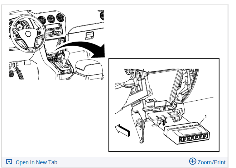

Disconnect the battery, then I would try unplugging the BCM electrical connectors and check for corrosion. Then plug them back in and clear the codes, this can reset the system, Also, I would do a hard system reboot.
This guide will show you how:
https://www.2carpros.com/articles/step-by-step-guide-performing-a-hard-system-reboot-for-your-vehicles-electronics-systems
Here is the location of the BCM, also does this car have interior water damage? Check out the images (below). Let us know how it goes.
May 5, 2025 at 4:18 AM
KNIGHTY06041
  • 7 POSTS
Checked BCM wires all look fine, battery fully charged, and master reset as in your helpful guide but still won't start, starting to lose hope on this one.
