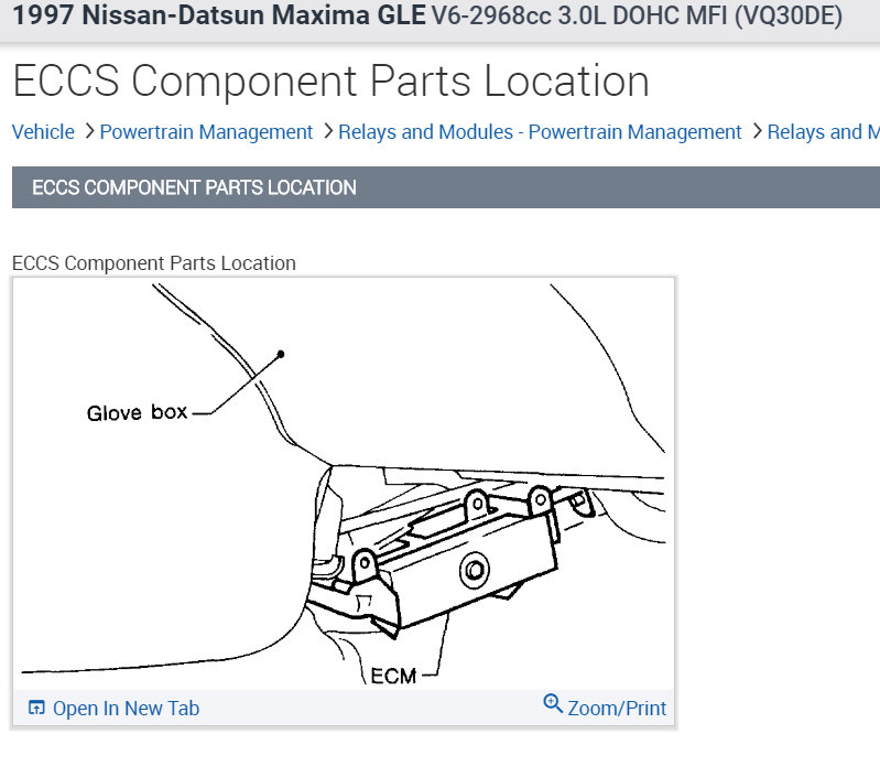

I have codes p0100, p0500, p0600, and p0731. Replaced speed sensor but odometer still doesn't work and changed MAF. Car starts easy and runs at 1,200 rpm in park. If i try to drive it, it chokes out at 2,500 rpm or it just turns off when slowing to stop or turn.

This sounds like the PCM has gone out. I would get a used one and plug it in to see what happens. Here is the location. Check out the diagrams (below). Please let us know what happens.
