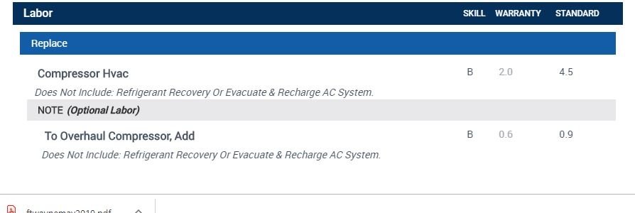

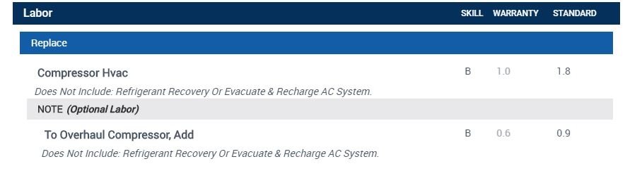

Good morning,
A lot of shops do not like to install owner provided parts because they lose profit on a part plus if there is an issue with the part, the customer tries to hold them liable for a free replacement.
https://www.2carpros.com/articles/replace-air-conditioner-compressor
The worse case is the 3.0 DOHC motor which pays about five hours for the repair. That comes to around $650.00 in labor. Add evacuate and charge the system plus the belt, and the price goes up to around $800.00.
The price is a bit high.
I would try Pep Boys, Firestone and Goodyear to see if they would help you.
