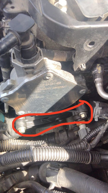

Good morning, everyone, I need help to save the name of the piece of the marked image, to buy it. The only thing they tell me is that the coolant sensor goes there.
Thank you and sorry for my bad English.

I'm having trouble orienting myself as to where on the engine I'm looking at in your pic.

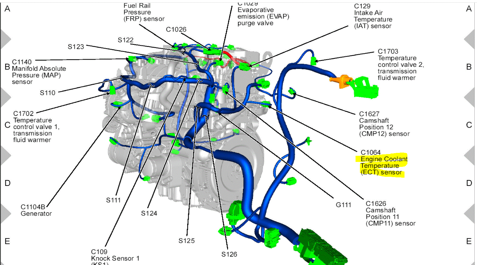

I can tell you the engine coolant temperature sensor is located on the rear of the engine. If you look at the pic below, I highlighted where it is located.

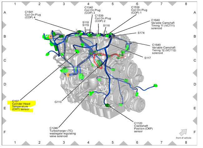

Keep in mind, there is a cylinder head temperature sensor as well. However, that is under the valve cover and attached to the cylinder head. Pic 2 shows its location.
Let me know if this helps.
See pic below.
