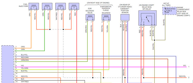

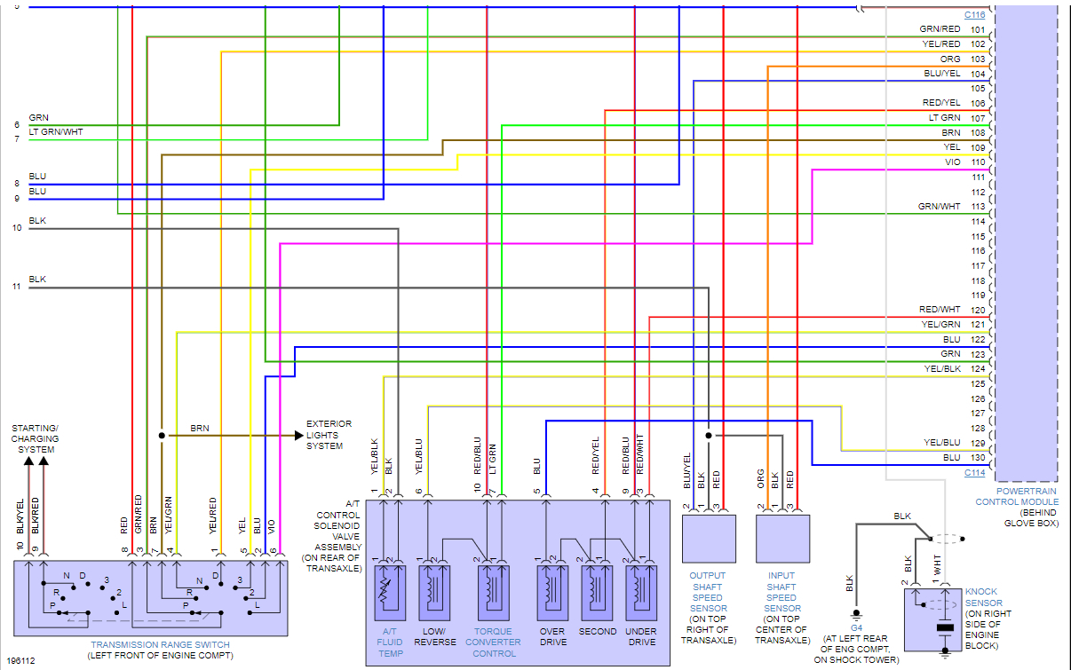

Hi, maybe you could help me to get electrical diagrams for my car listed above with a 4G13 motor. I have been looking online without no success.
I would appreciate your help. Regards, Miguel
Mar 11, 2022 at 1:30 AM
AL514
  • 5,703 POSTS

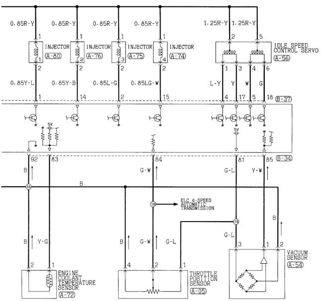

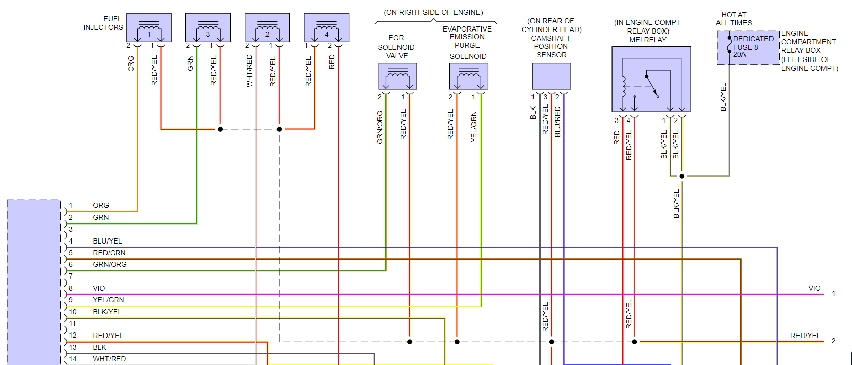

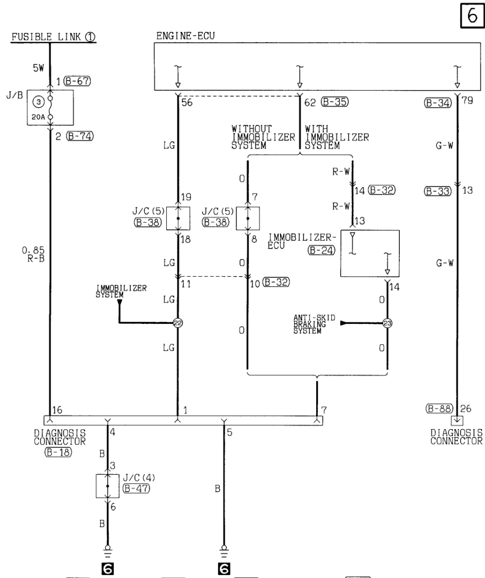

Hello, this seems to be a pretty rare engine. We don't have it in our data banks because it's a European model, but also just finding any information at all on the 4G13 engine is very difficult. It has been marketed as a bunch of different names as well, but I don't see that engine in any of those models either. What we can do is I can give you a couple different engine wiring diagrams for a specific part of the engine, such as a certain section of wiring harness and you can see if it matches what you have on your car. I have pulled up the 2004 Mitsubishi Lancer 2.0Liter 4G63 which seems to be the next in line from the 4G13. So, here's the Fuel Injector Harness section that includes the EGR Solenoid, Purge Solenoid, Camshaft Position sensor, and MFI Relay. See if this has the same wiring colors as your car.
I'm sorry we can't do more. We run into this with a lot of foreign made vehicles.
If these are the same I'll give you the whole engine block wiring diagram.

Thanks for your prompt answer, I checked the color wires and none of them matched, but I think will be good idea if you provide me with the all the diagram since it will help me to troubleshoot the system, it is better than nothing. thanks again.

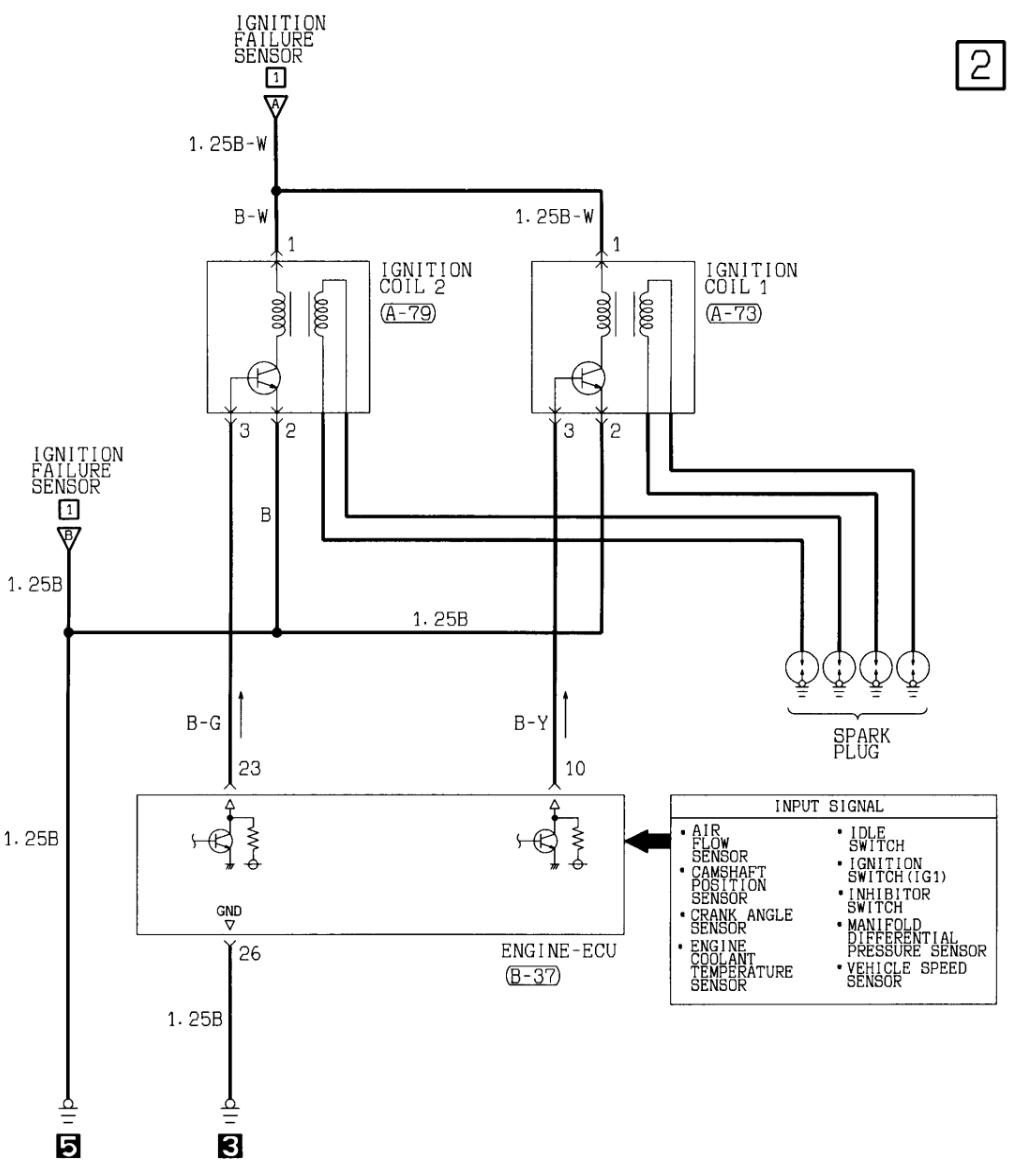

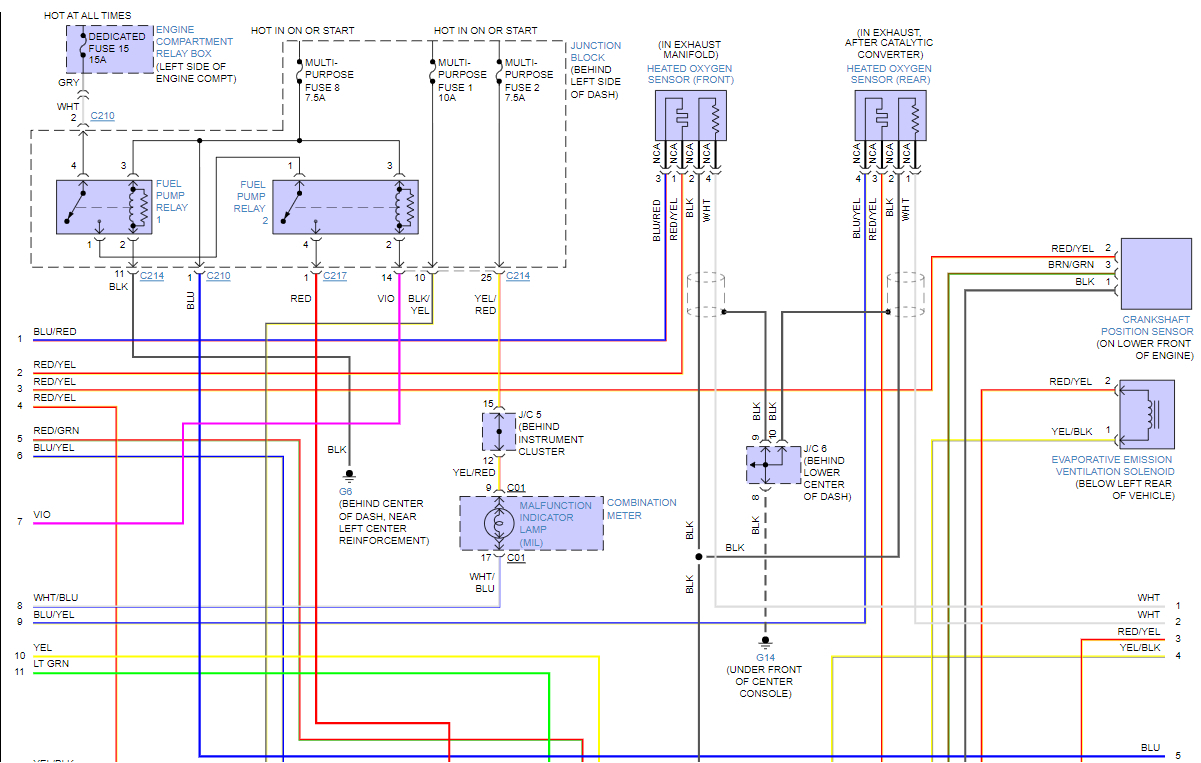

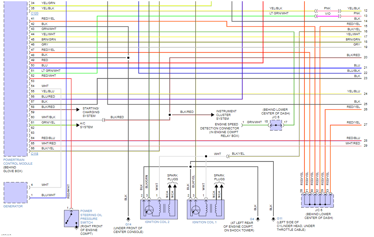

What kind of issue are you dealing with? sorry for the slow response today, Having an issue with internet this morning. I can walk through some testing methods if I know what's going on. I will try some other wiring diagrams as well. Also, what colors are the fuel injector wires? I sent a message out looking for the wiring diagrams for that specific engine also. So, it might turn up today some time.

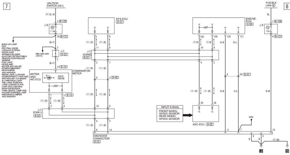

So, these are the diagrams for the 2.0liter. Pages 1 and 2, 3 and 4, 5 and 6, go together. If I can find the diagrams for the 4G13 1.3Liter engine I'll post them here.

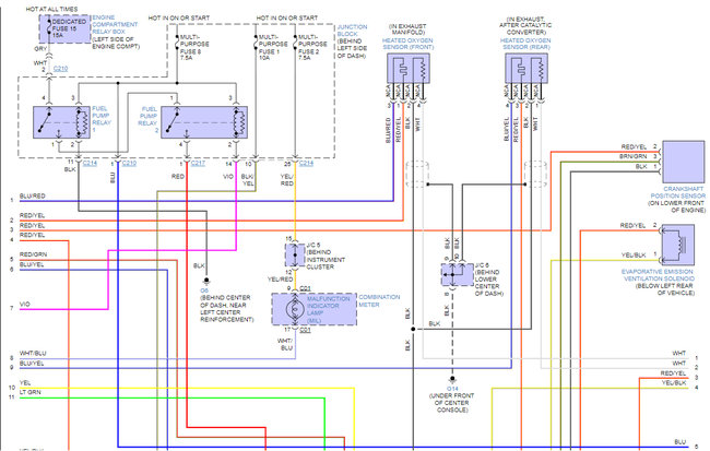

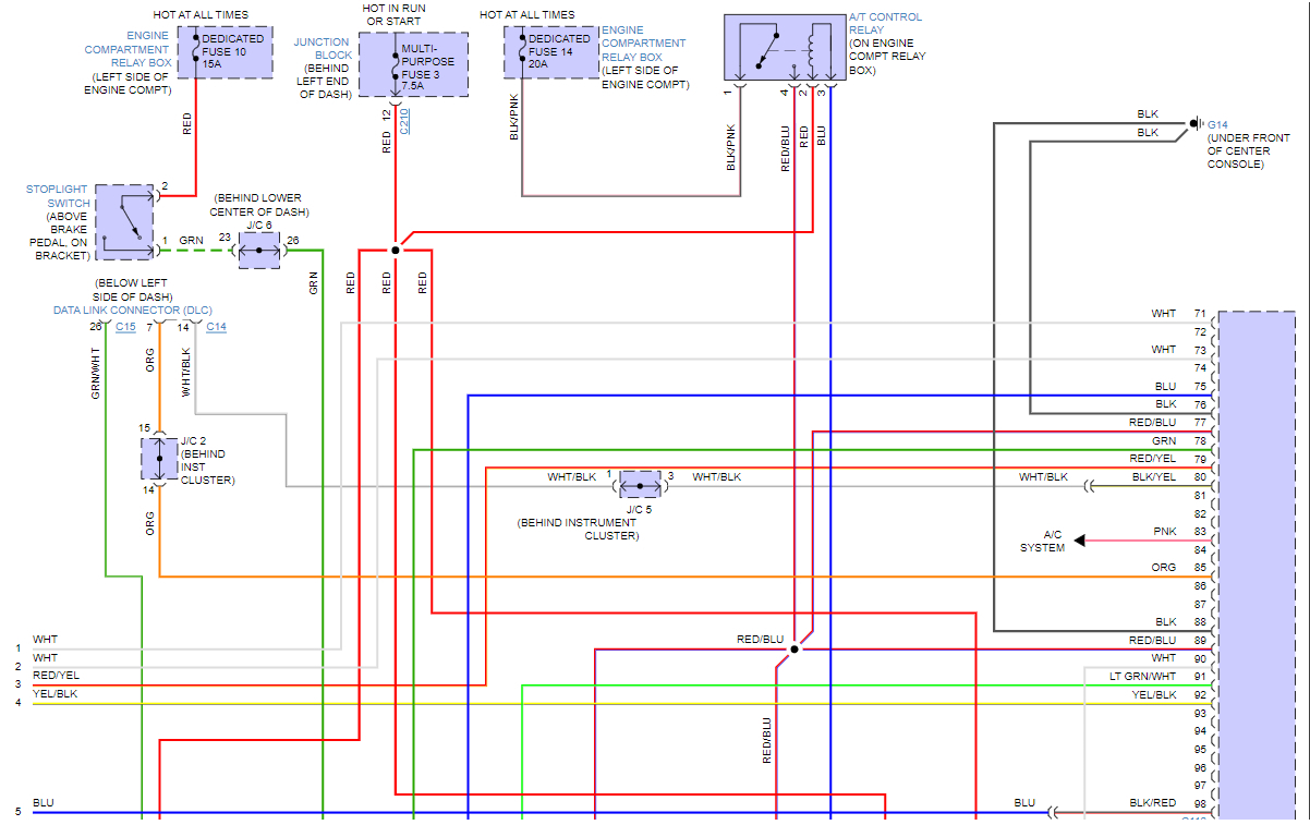

I think I found a place that has the diagrams you need. Does this car have the steering wheel on the right side of the car? Right-Hand-Drive?
This diagram is from the 4G15 engine, does any of these wiring colors match? Hopefully you can see these okay, I had to edit them a lot because the print was so small, but the fuel injector wires are yellow/violet, yellow/red, yellow/green, blue, with a red power feed wire.

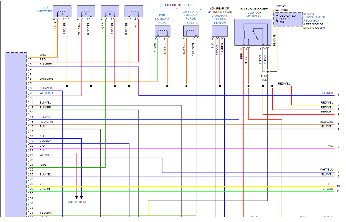

Hi, I just Checked the color wire for injector, and I found the following:
red, yellow/yellow green
red, yellow/yellow black
red, yellow/yellow blue
red, yellow/green white
The color does not match but as you say, it is better than nothing, please send those, I will use them, the 4G15.

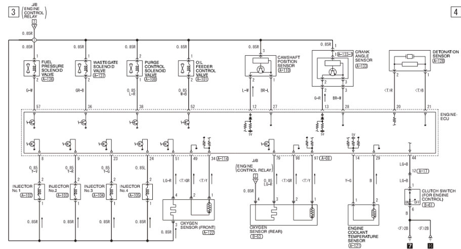

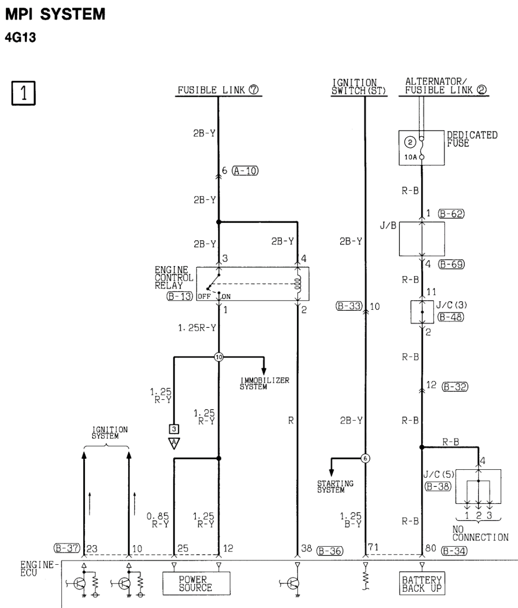

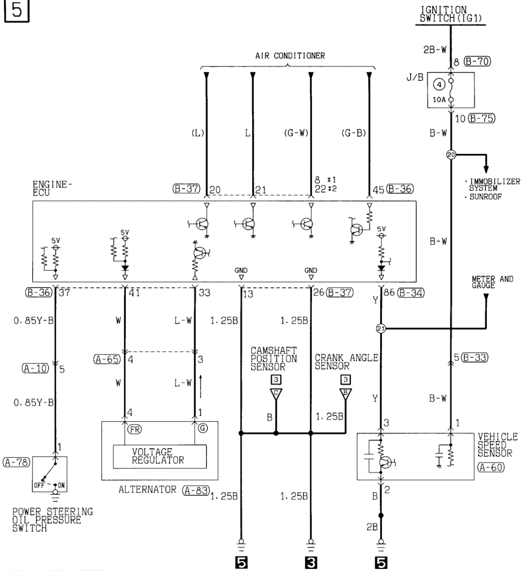

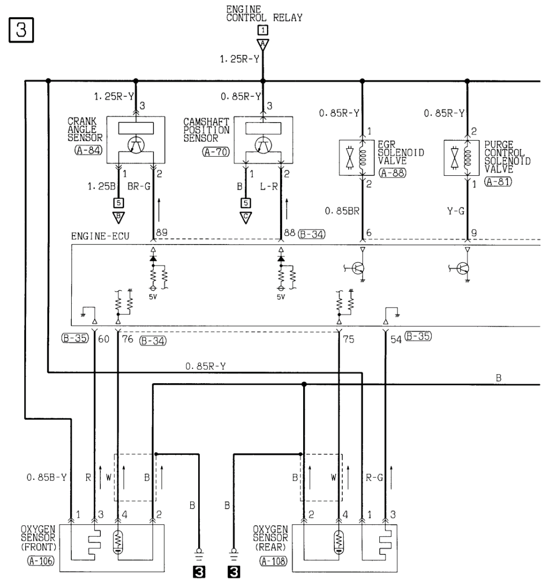

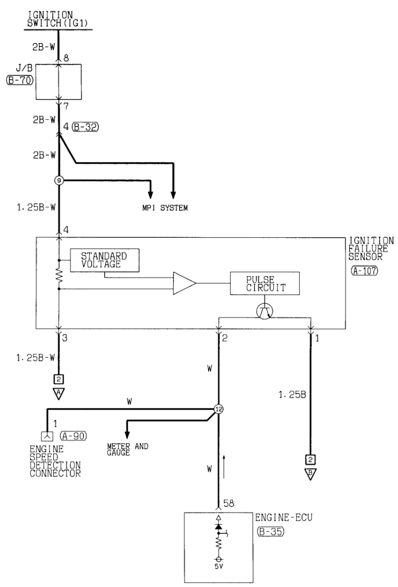

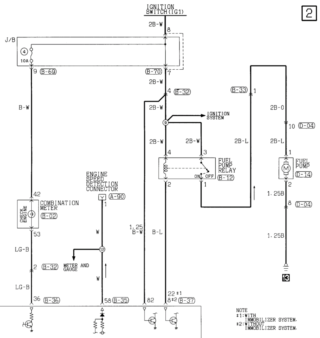

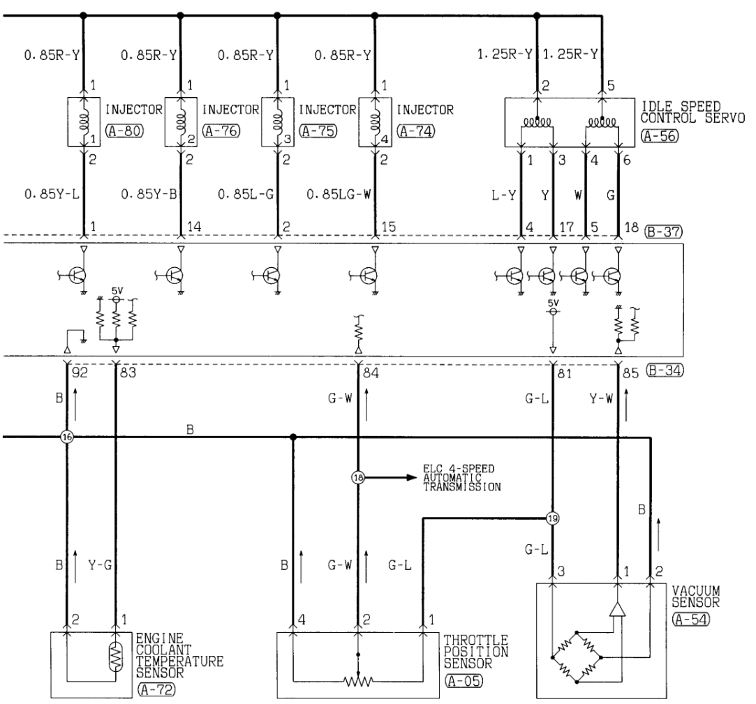

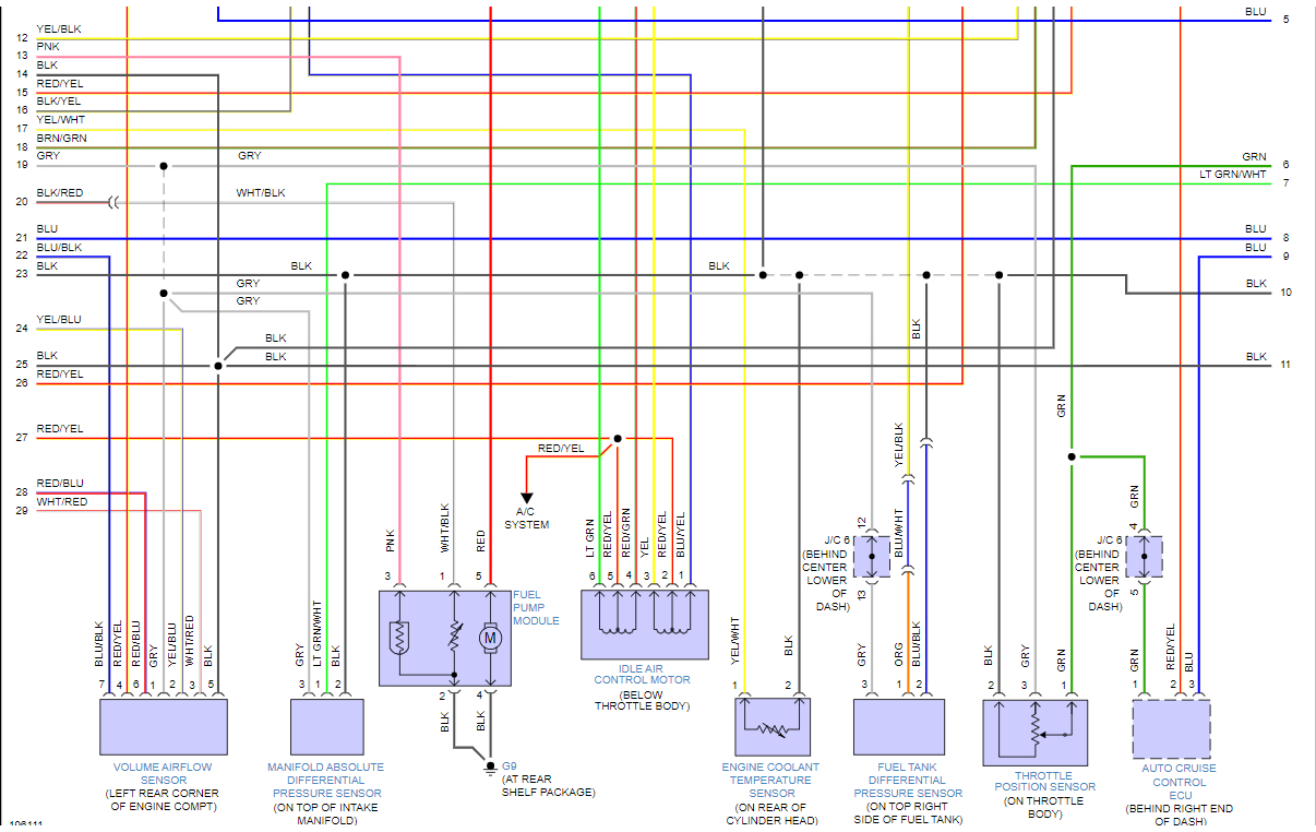

Okay, here are the four pages for the 4G15, if I come across the 4G13 I'll post them right away for you. I couldn't find any with fuel injector feed wires that were red/yellow.

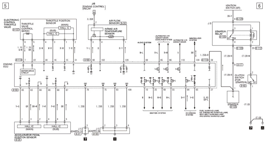

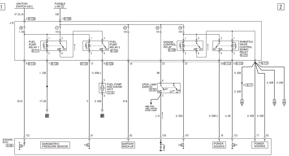

Okay, good news. I just found the 4G13 with the correct fuel injectors wiring colors. Give me a few minutes to upload them.
The first four diagrams are incorrect, it wouldn't allow me to erase them, so 5-8 are for the 4G13 engine 1.3Liter.

Hi Sr, thanks for your time and considerations, this informational is helpful.
