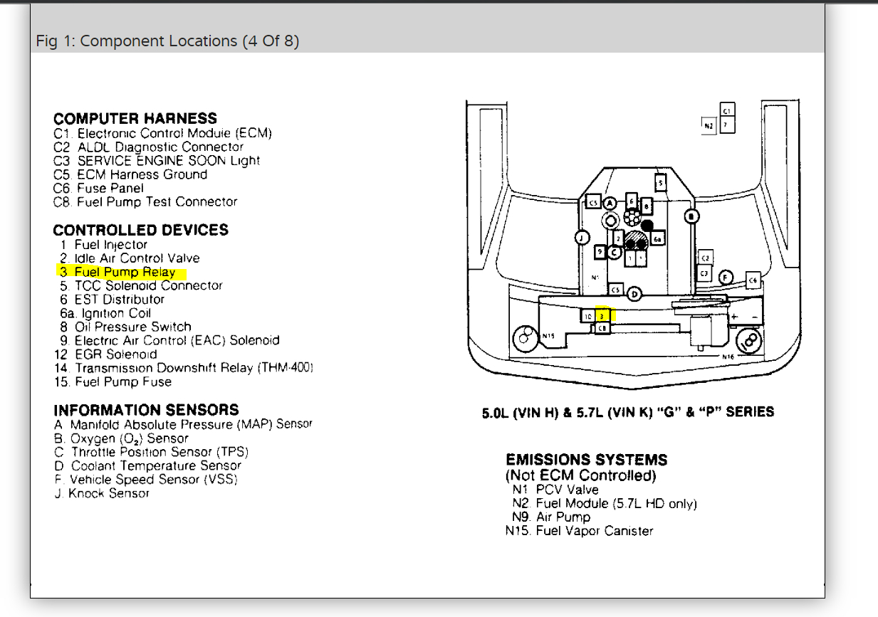

Hello again,
Did you guys install a new fuel pump relay? I have included a diagram of where the fuel pump relay is located in your vehicle. Please get back to us.

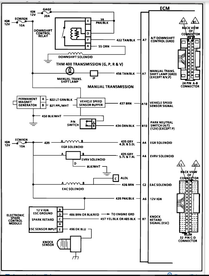

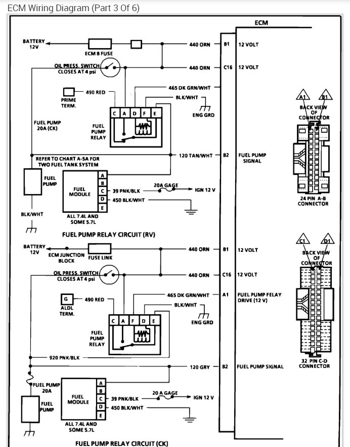

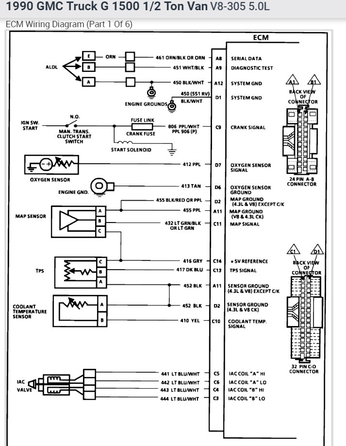

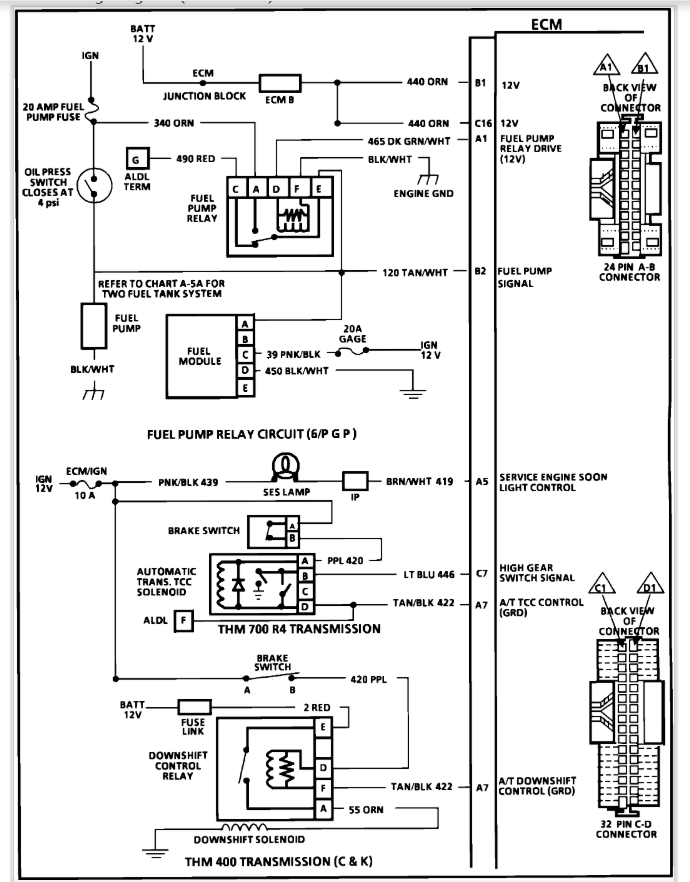

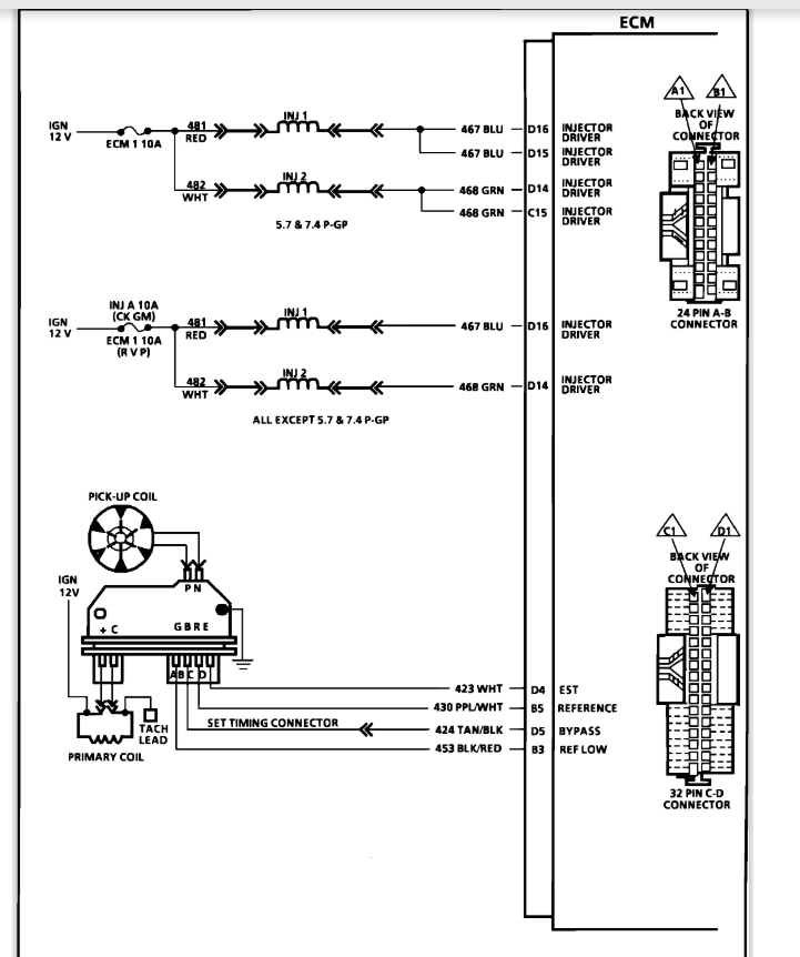

When the engine stalls can you see if power is getting to the ECM. Check b1 and c16. here is a guide to help and the engine wiring diagrams so you can see how the system works:
