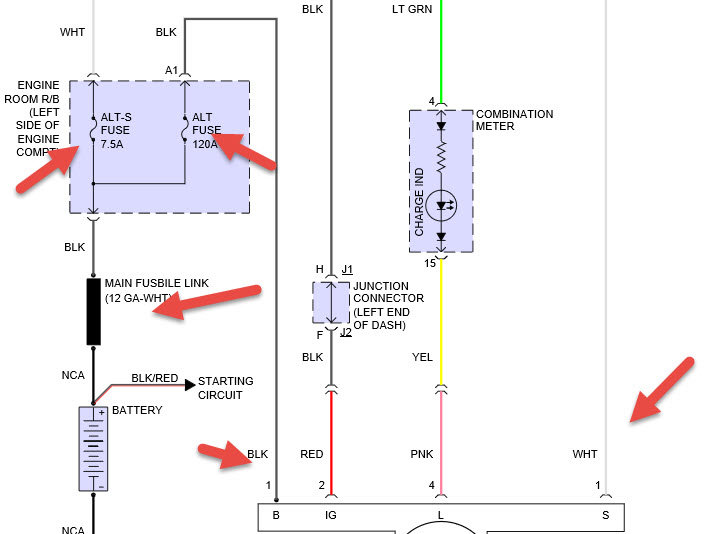

I just recently bought my and nothing is working. Example: my windshield wipers, windows, speedometer, rpm is very low, stuck in park. Just basically my car has stopped working. I have checked all the fuses and they are fine. I have changed the battery and alternator twice. When the alternator is on a bench is works great, but when I put it on my car it does not work. Please someone help me, I do not know what else to do.

check fusible link and fuses in picture. then see if battery is getting over twelve volts when car is running. if not check the two wires in picture to see if power is there. if not it may be a short. then check battery/body ground and battery/engine ground.
