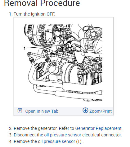

2013 Chevy Traverse with more issues than I can keep up with.
1. A/C light blinks 6x
This was recharged and did not help
2. Warning comes on "oil pressure low. Turn off engine".
Oil level is good.
I need my car. Can someone please help me?
I'll add this...my Brother in law said it was the radiator fan. I purchased a new one and had it installed. Needless to say, that was not the problem. I was ignorant for believing him.
No codes are coming up on the OBD scanner. I have tried 2 different ones.

If the low oil pressure light is coming on, that is likely why the AC isn't working as well. The system is designed to reduce the load on the engine.
When the light comes on and says low oil pressure, do you ever hear any ticking or knocking from the engine area?
If you do hear noise, that is a concern.
Take a look through this link:
https://www.2carpros.com/articles/engine-noises

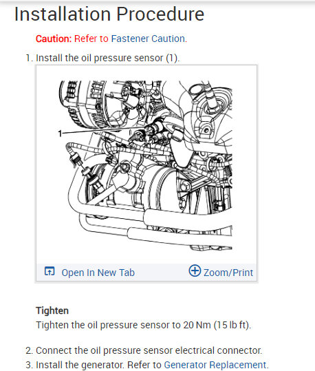

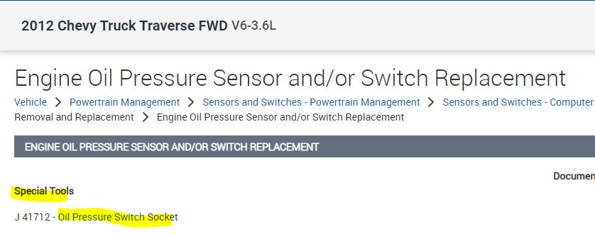

If not, chances are the oil pressure switch/sensor is faulty. It isn't an expensive part and it's not too hard to replace. I attached the directions below for you.
Before you replace it, inspect it and around it for evidence of any engine oil. If you don't see any, disconnect the sensor connector and see if oil is present in the electrical connector.
If you find oil, replace it. When you do it, please note that it is right behind the alternator. I recommend disconnecting the negative battery terminal before working in that area.
Let me know if this helps.
