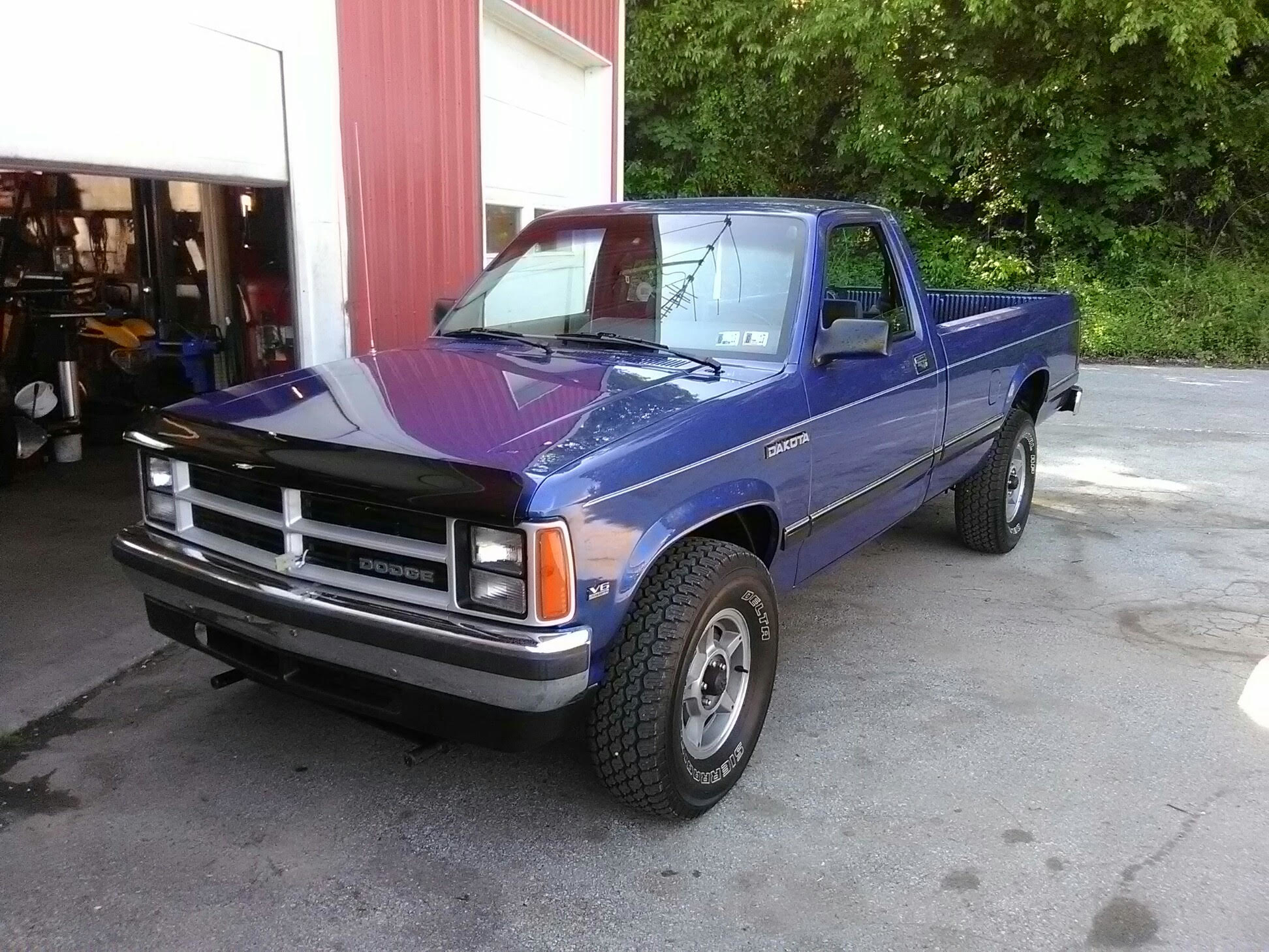

No question is dumb. lol Honestly, it should be okay, other than federal law prohibits it. Funny I restored a 1990 Dakota a little over a year ago and drive it every day. Great little truck.

Let me know if I can help in the future. I turned nearly every bolt there is on mine. lol Plus a lot of body work and welding... I hate body work!
