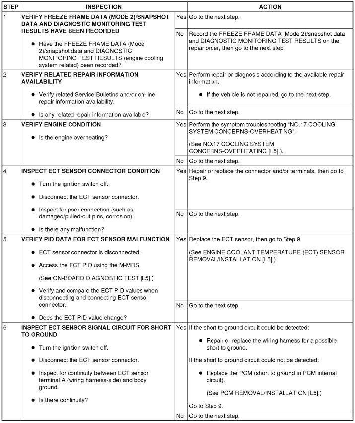

SQM
  • 6,383 POSTS

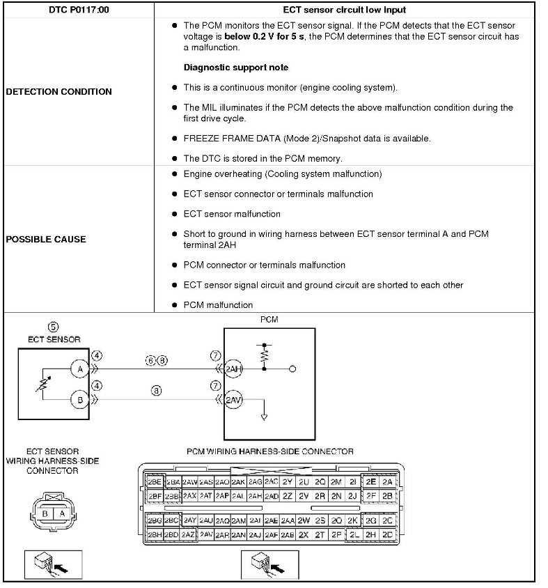

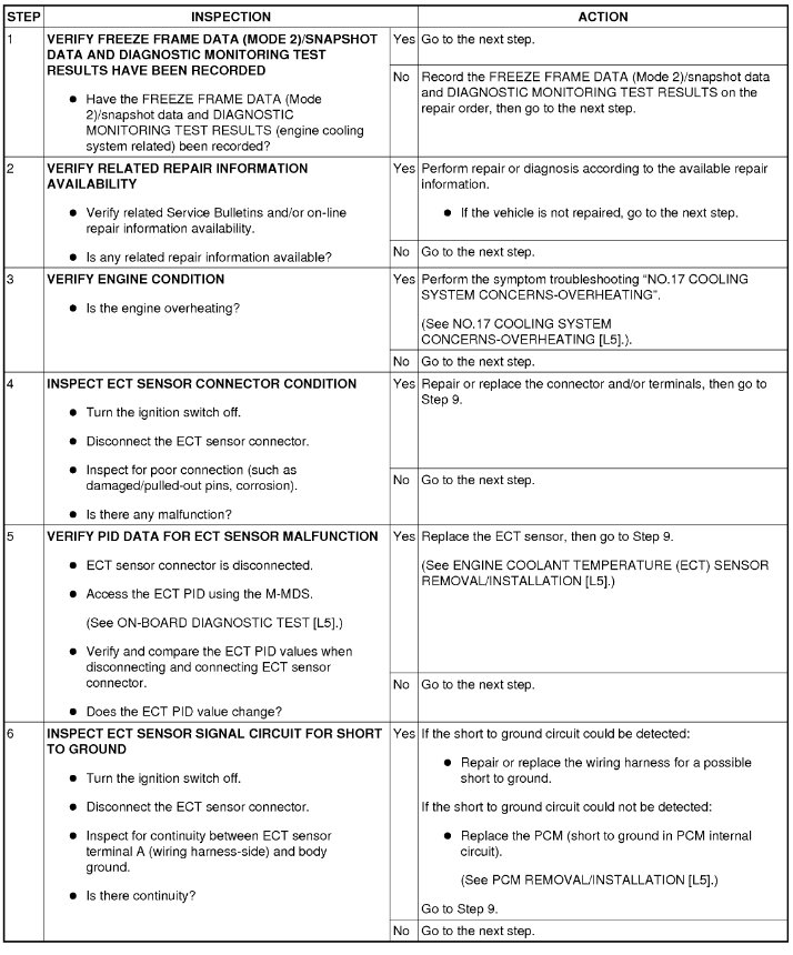

Are getting any code besides the P0117?
First make sure all the fluids are at correct level. Typically, you will see smoke when there is fluid burning. It could be oil that got on the exhaust or coolant.
A faulty coolant temperature sensor can prevent the engine from starting, but it does not explain the smoke.
I have attached the troubleshooting steps for the code P0117 below.
Nov 23, 2021 at 3:07 AM

I have seen cars to not start at all due to a bad coolant temperature sensor. As the sensor can send signal that the engine is 'too hot' to start.
Let me know if you are able to go through that trouble shooting guide.

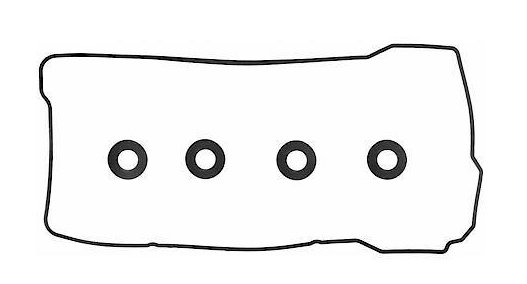

So, it is likely due to leaking spark plug tube seals. Which is a part of the valve cover gasket.
Try cleaning out the plugs and the hole and make sure they are dry and see if you are able to run the engine. Then check again for the leak.

You can try cleaning it out with a rag, or a shop vacuum to suck it out if possible.
Best course of action would be to remove the valve cover and replace the seals.

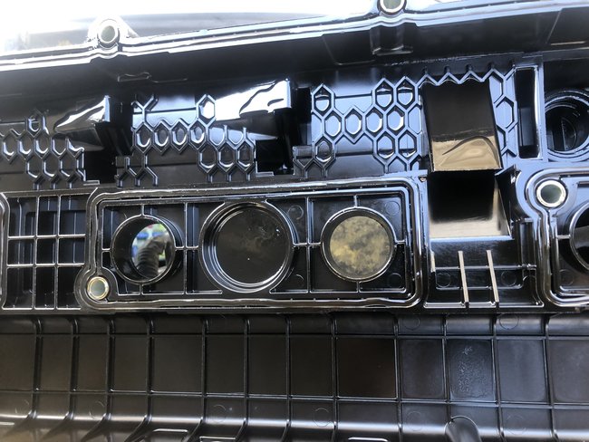

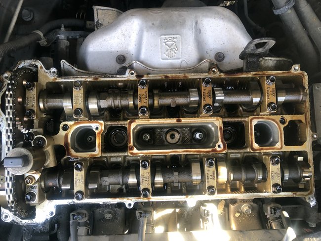

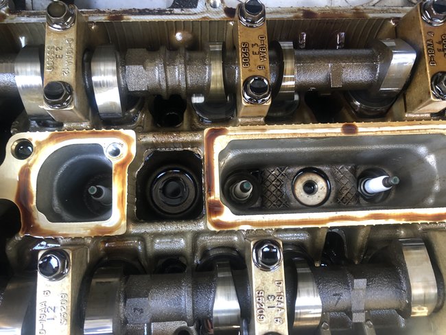

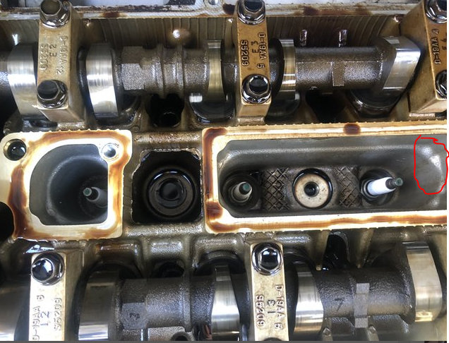

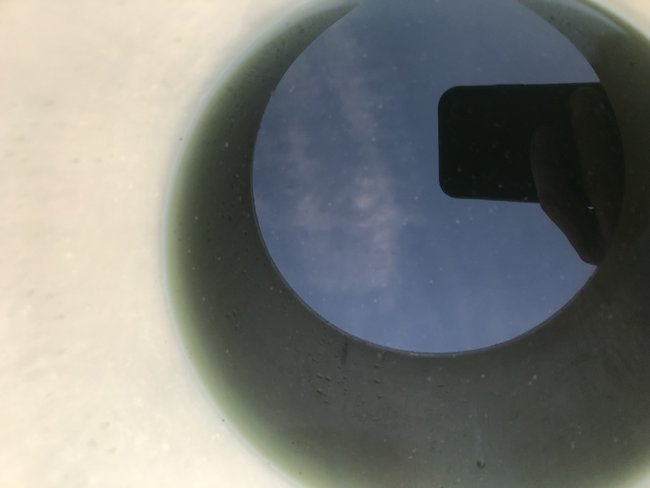

Here is what looks like with valve cover off.
Dec 14, 2021 at 12:24 AM
STEVEN1984
  • 29 POSTS
I’m not sure how to tell if bad. But I’m sure the three in the middle should not have that oil there? Right? Would this have caused the white smoke from the oil cap once it blew filled with oil and caused smoke? Thanks for all the help so far!
Dec 14, 2021 at 12:27 AM
SQM
  • 6,383 POSTS
You can kind of see the oil mark on the inside. So that is where it is likely leaking.
So, did you get smoke out of the oil cap but not the exhaust right?
The oil can smoke if it is under excess heat.
Dec 14, 2021 at 4:45 AM

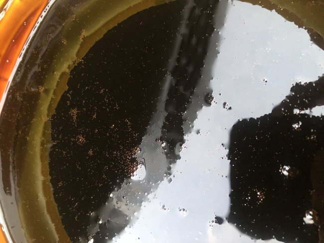

Coolant dark. But green tint and smells like coolant. Oil dark black.
Dec 14, 2021 at 7:09 AM
SQM
  • 6,383 POSTS
Those look to be typical used fluid and does not appear to be mixed. The oil would be a different milky color if coolant got in it.

STEVEN1984
  • 29 POSTS
P0117 temperature sensor is only code I got.
Jan 4, 2022 at 9:29 PM

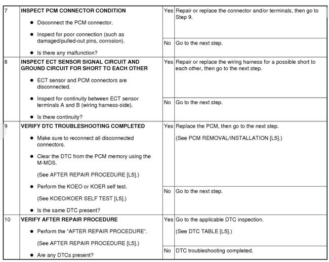

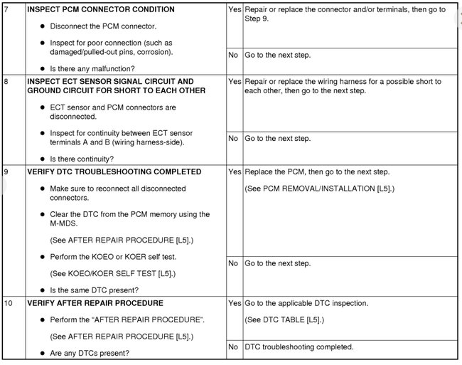

SQM
  • 6,383 POSTS
I think trouble shooting the code would be a good idea. As that can prevent the engine from starting.
This code is related to low power input to the temperature sensor. Take a look at the diagnostics steps below.
Jan 4, 2022 at 10:04 PM

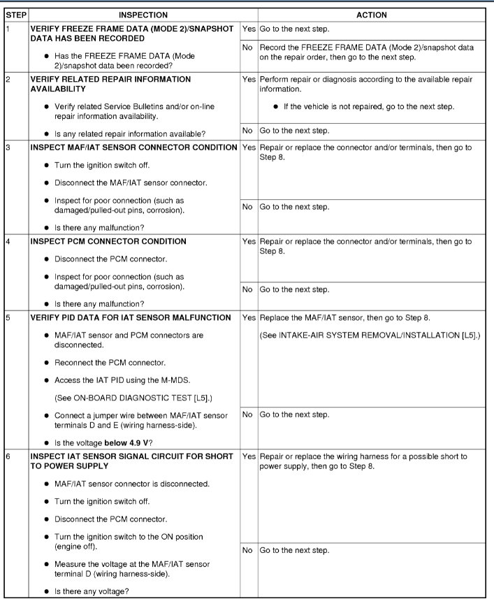

Hooked code reader back up and got more codes this time! :(
P0117
P061B
P0113
P0102

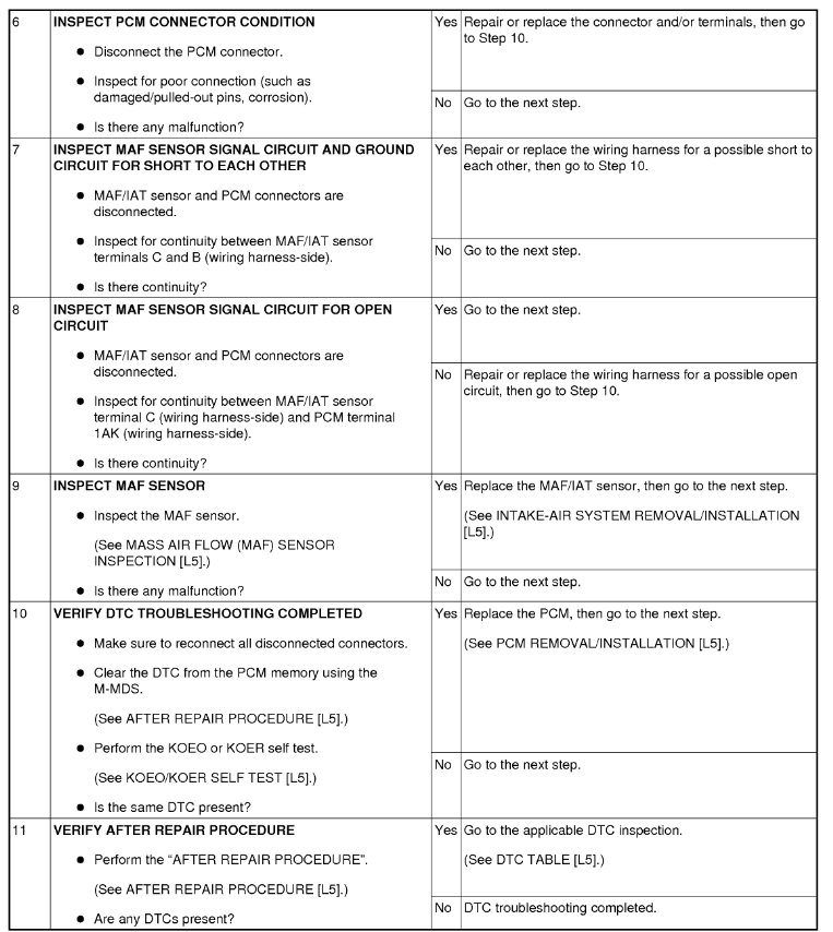

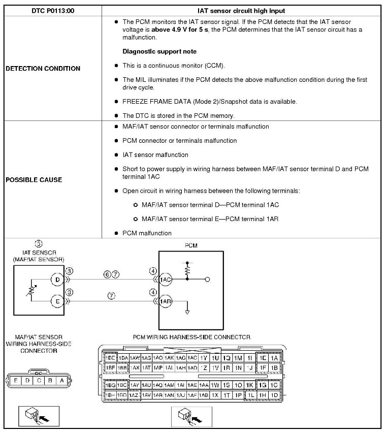

Jan 5, 2022 at 12:43 AM

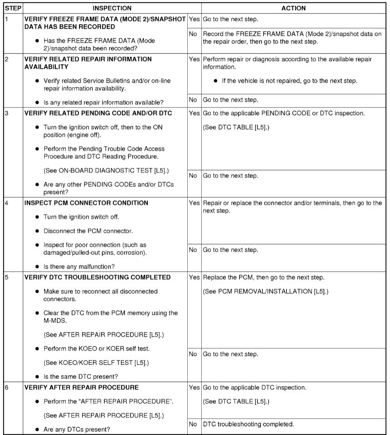

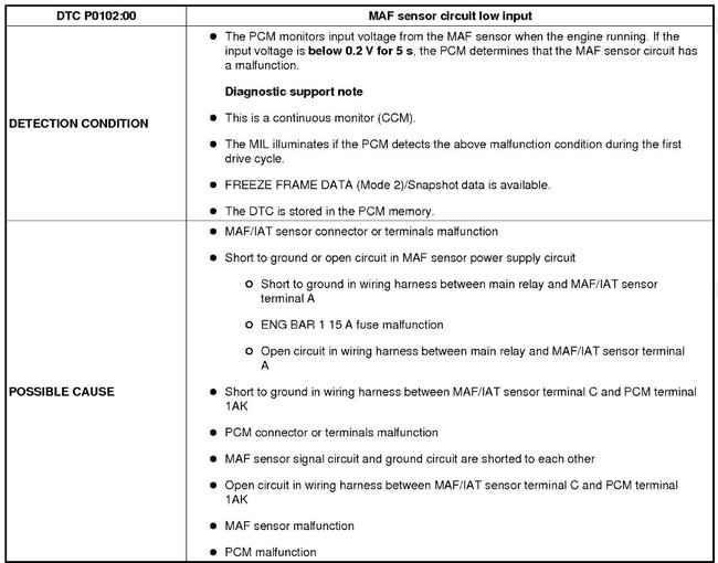

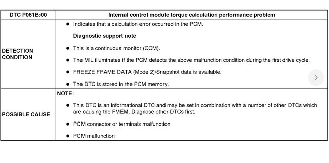

SQM
  • 6,383 POSTS

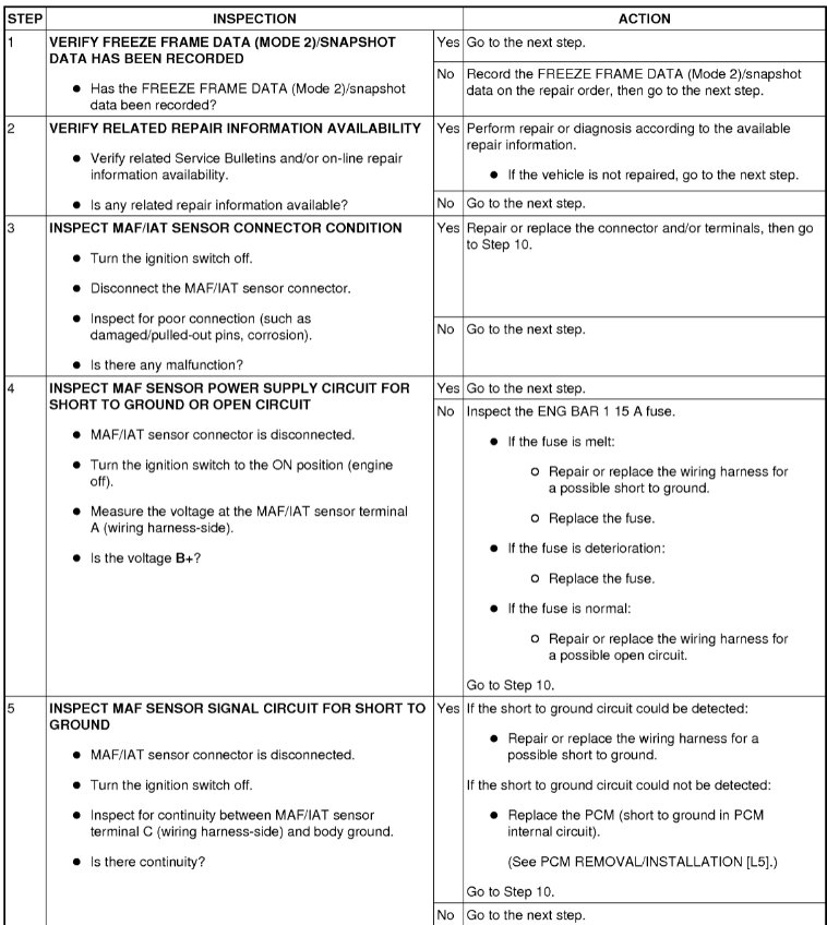

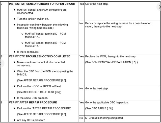

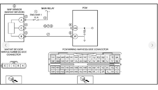

Strange, it appears that the vehicle really wants you to go down the rabbit hole :(
These codes are for Mass air flow sensor, intake air temperature sensor, these could be wiring or PCM issues.
I think a good step would be to diagnose the P0117 first and see if that gives you an answer.
I have attached the diagnostics for the other codes as well just so you have it.
