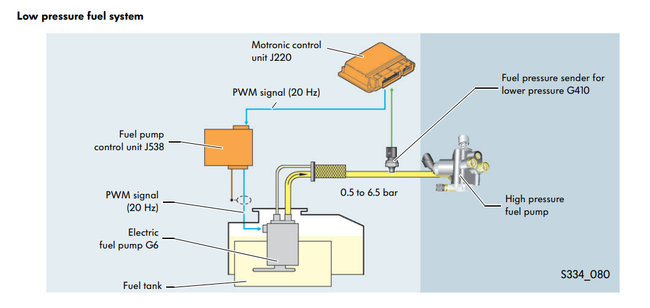

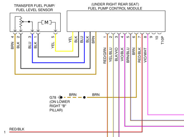

Can I get the fuel pump wiring diagram and the inertia switch location?
2008 VOLKSWAGEN PASSAT
1,000 MILES • 2.0L • 4 CYL • 2WD • AUTOMATIC
KATHY.LOPEZ1609
Gas need help with fuel pump relay wiring diagram color diagram and inertia switch location.

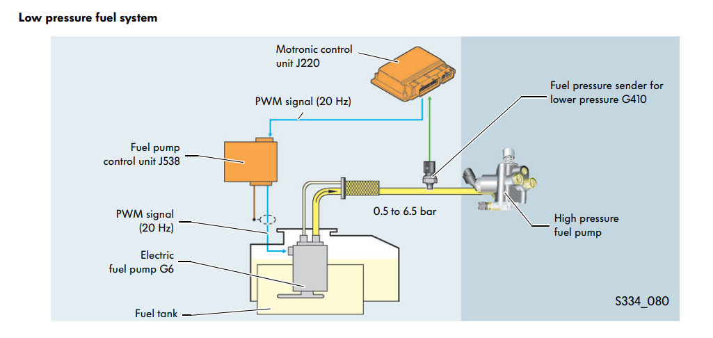

Your vehicle does not have a fuel cut off switch/inertia switch.
This fuel system is equipped with two fuel pumps.
Transfer or pre-delivery pump fitted in the fuel tank and a high-pressure pump which is mechanically driven by the intake camshaft.
The transfer pump is controlled by the fuel pump control module located under the right rear seat near the access port for the in-tank fuel pump, see diagram in image 1
Pin 7, red/black wire is the 12V supply.
Pin 6, brown wire is ground.
12V and ground can be checked with a test light or voltmeter.

Image 2 shows the low-pressure fuel system layout, showing in tank fuel pump G6 and fuel pump control module J538.

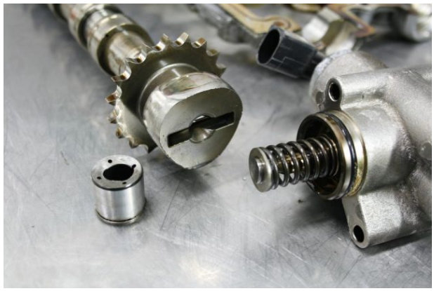

A common issue is a failed/worn cam follower which drives the mechanical high pressure fuel pump.
https://youtu.be/wUP9xhHQk8E
Also see image three below.
