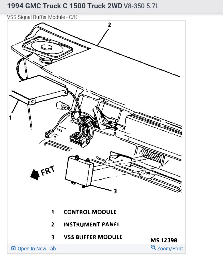

I have changed ignition switch (I was told they can go bad and are on the same circuit), VSS in tail shaft of transmission, VSSB (3 different tries), and have 2 different instrument clusters, I’ve run continuity test on all the wires everything checks out good I even replaced the ECM/PCM. I am at a loss what am I missing? Any help would be greatly appreciated.

There is a speedometer buffer module just behind the instrument cluster. Here is the location so you can change it out to fix the problem. Check out the images (below). Please let us know what happens.

Yes, I’ve changed that out already with 3 different modules with the same numbers on it QDM followed by some numbers it’s about the size of a deck of cards a white plastic box.
Mar 13, 2023 at 4:52 AM
FRAWG85
It’s behind the glove box on my truck next to the brain box.
Mar 13, 2023 at 4:54 AM
  • 55,770 POSTS
Okay, let's check the signal out of the tail housing, remove the connector and use a voltage meter set to AC millivolts. Then raise the rear to the truck and put it on jackstands to allow the rear wheel to spin, then have a helper put the truck in drive while the engine is idling. The voltmeter should show a reading here are two guides to help us with the test:
