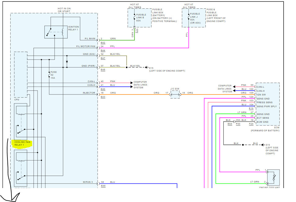

Hello i live in Dubai. Recently we had rain so much and all the water came inside. what i did was I disconnect the battery terminal as it was raining so much so bought car home remove all the seats check the oil and fuse box all the things were perfect, but only the radiator fan and A/C compressor is not working on the A/C, also but the fan is not working. I already checked the fuse’s but am not able to check fan relay. can someone please tell me the location of the fan relay? Thank you

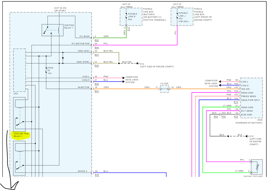

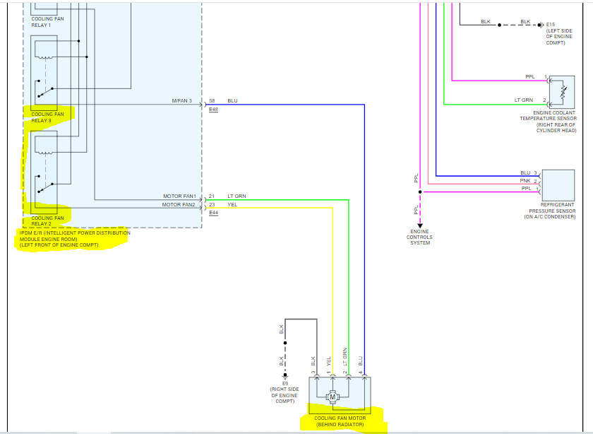

The Sunny isn't offered in the US, so there are no listings in my manuals. However, I believe it is very similar to the Nissan Sentra which we do have.
I attached the wiring schematic below for the Sentra. There are three relays for the fan. See pics below. These are located in the intelligent power distribution module (IPDM) under the hood.
Take a look and let me know if this helps.
See pics below. Note: I had to cut the pic in half to make it readable. I did overlap the two so you can follow from one to the next.
