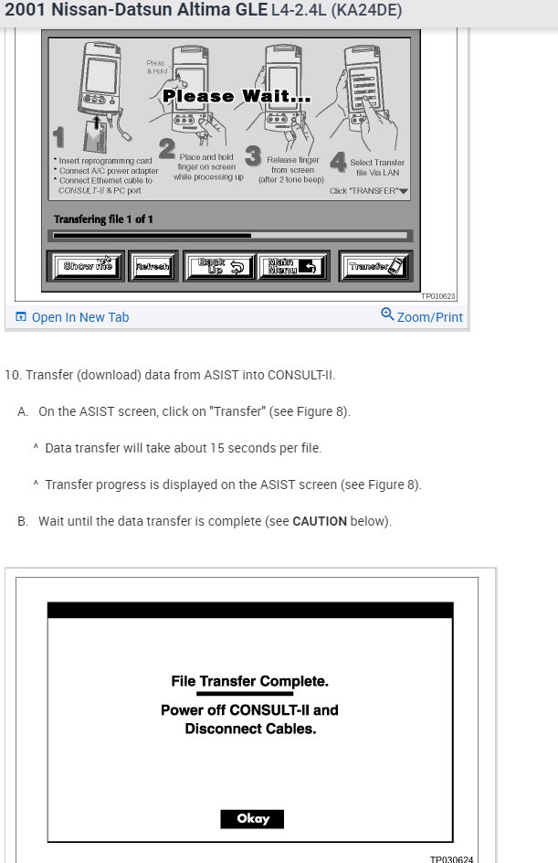

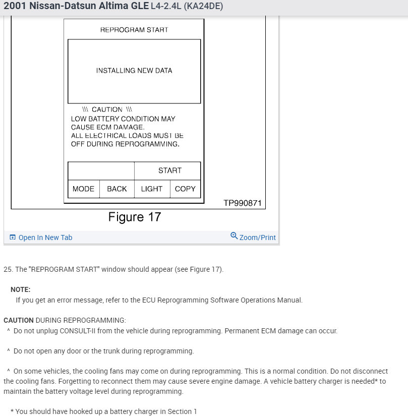

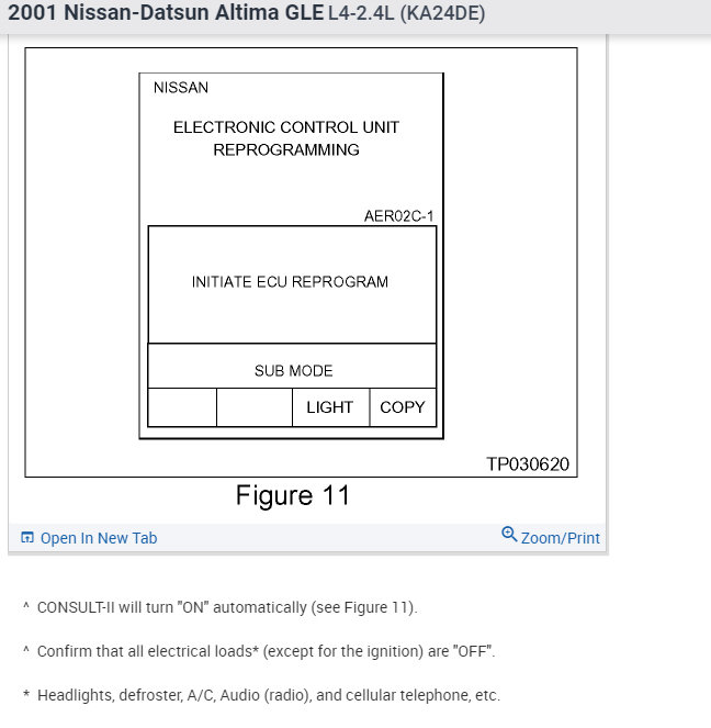

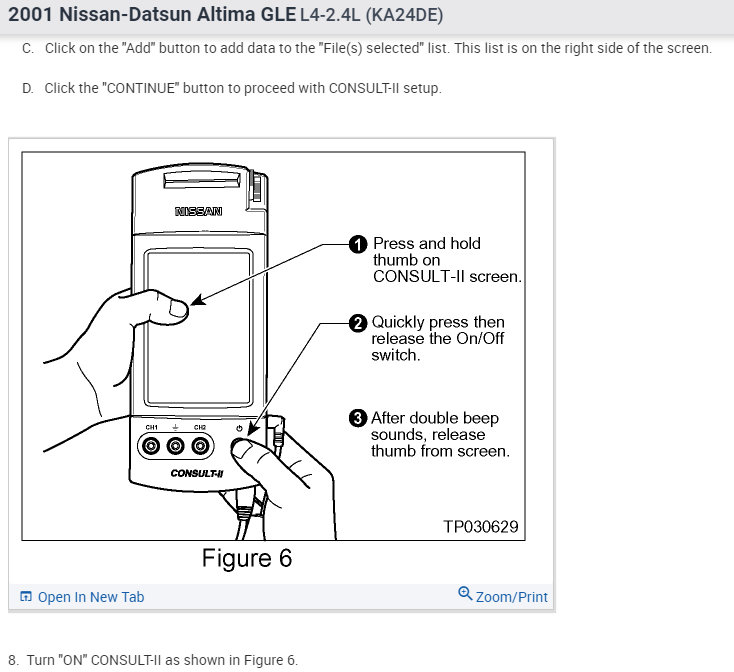

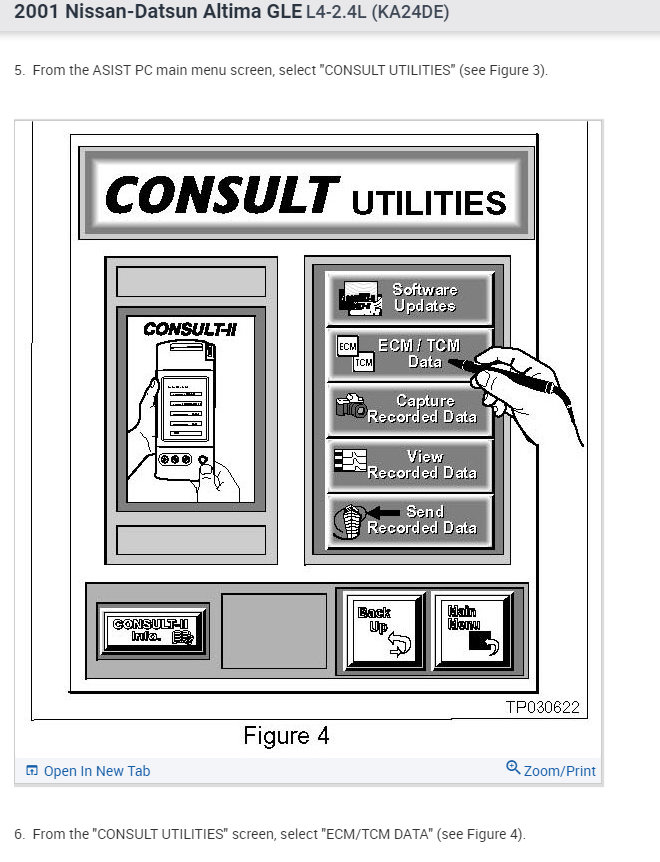

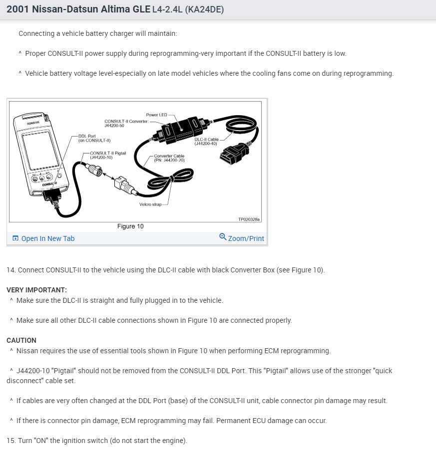

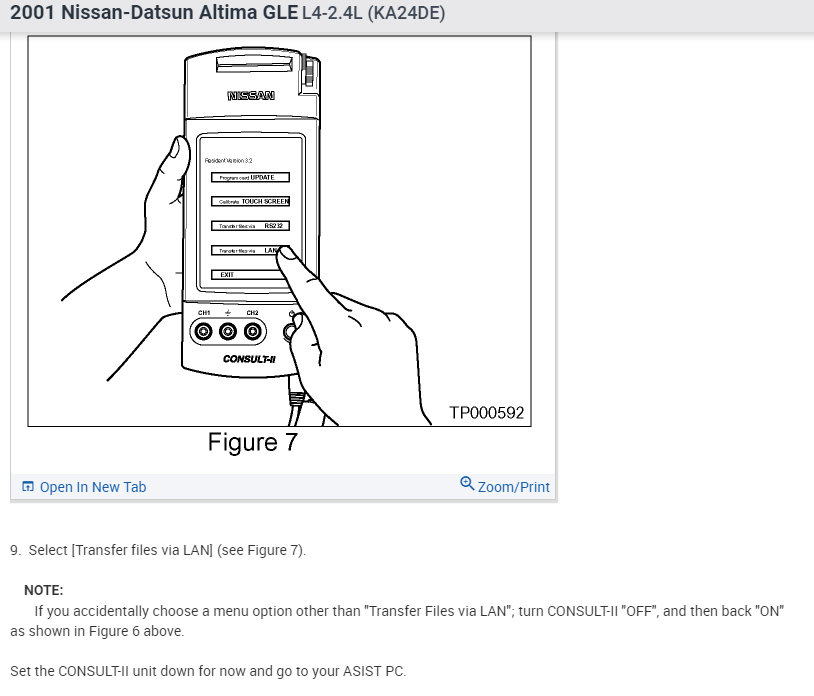

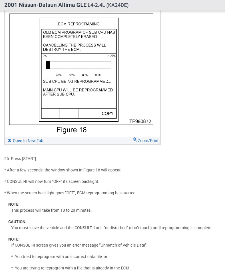

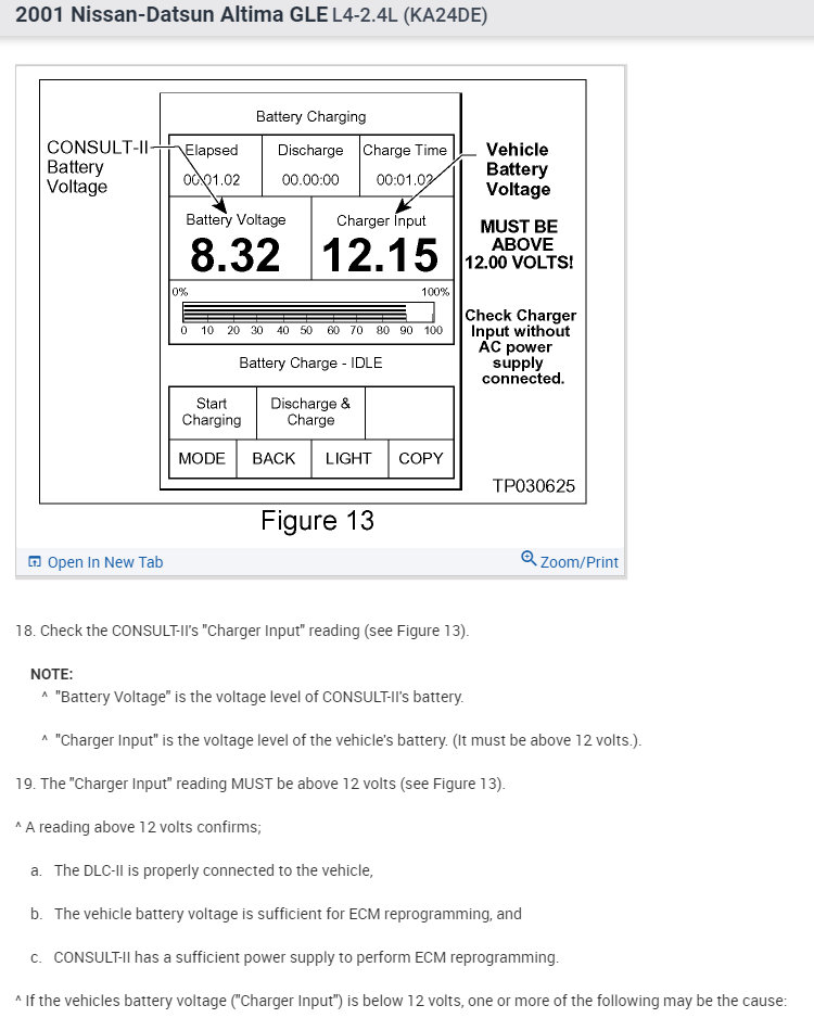

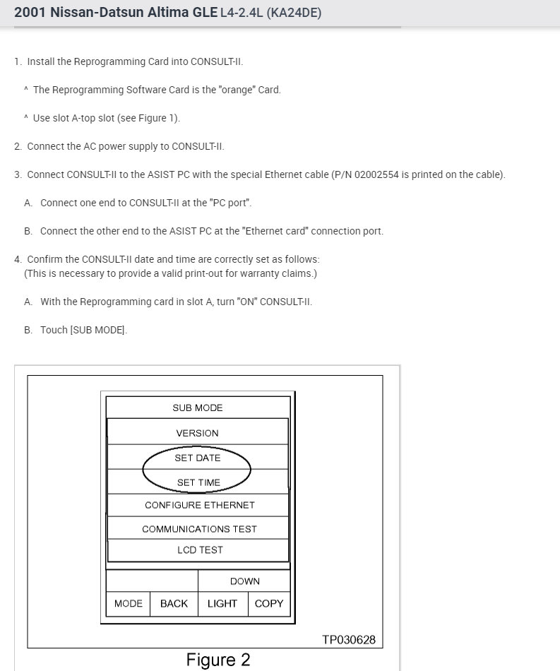

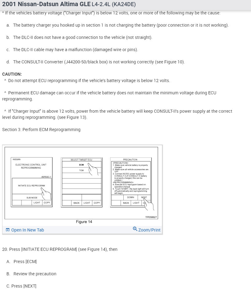

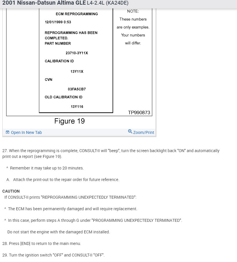

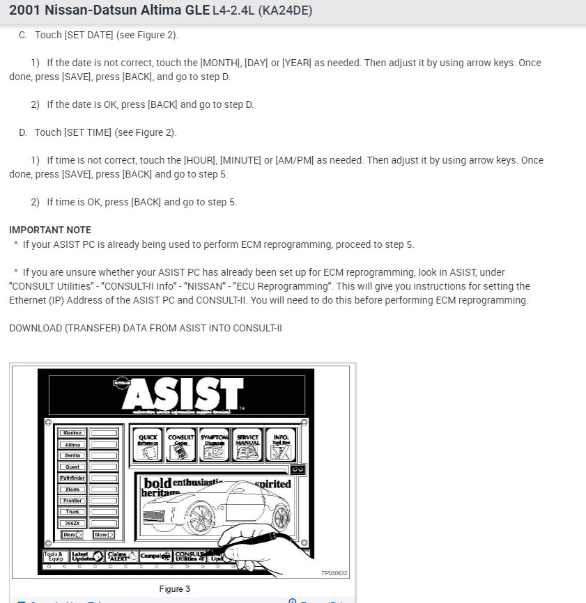

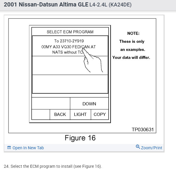

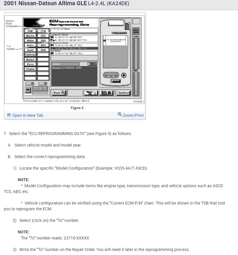

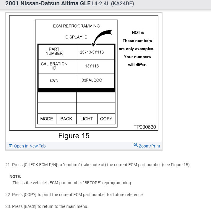

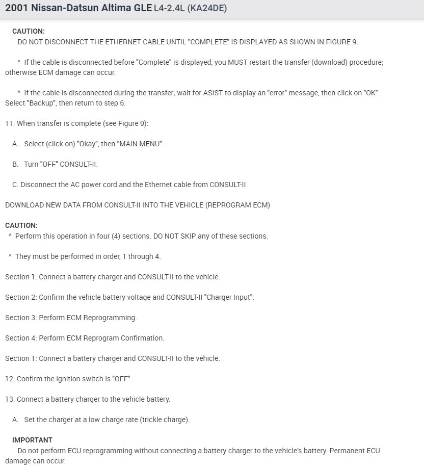

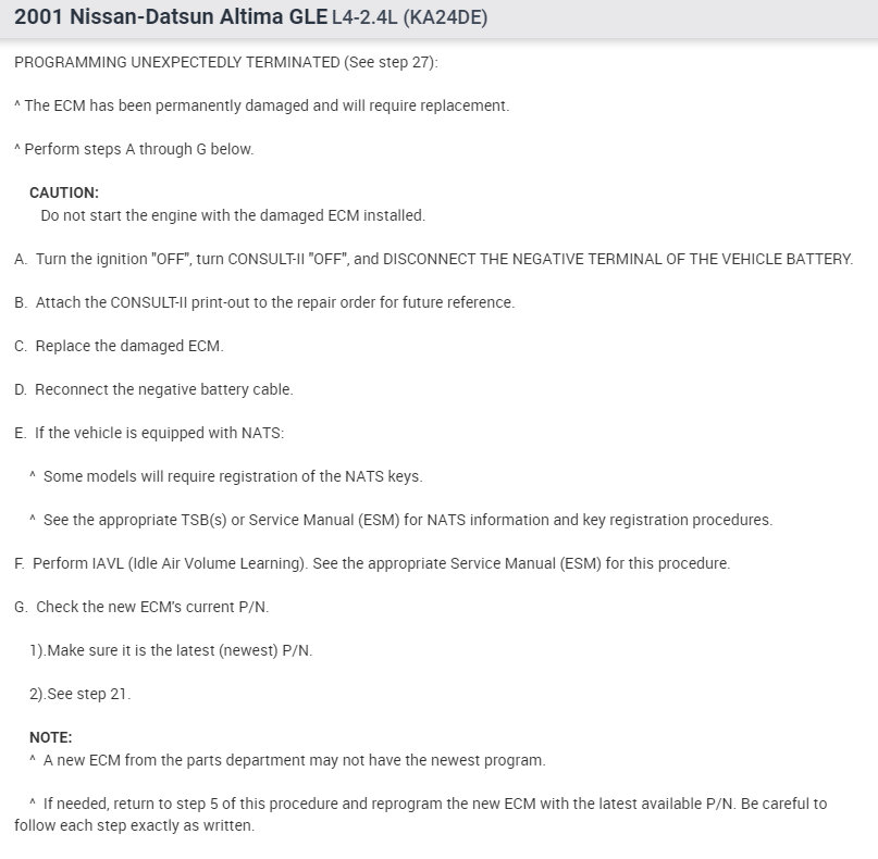

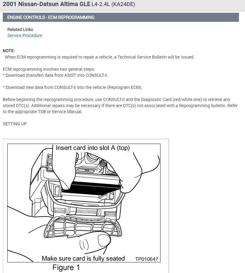

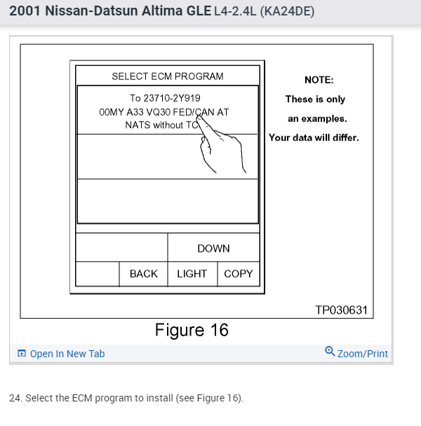

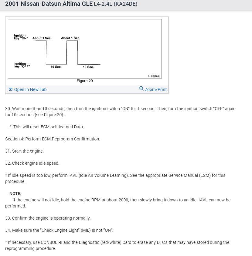

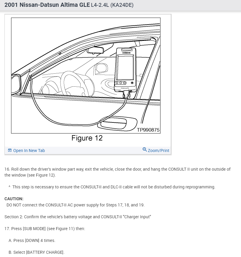

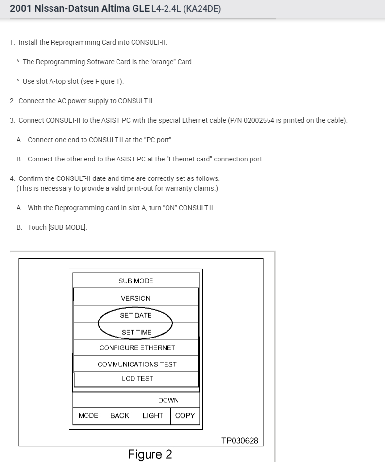

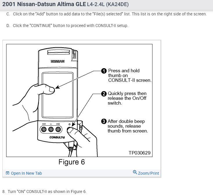

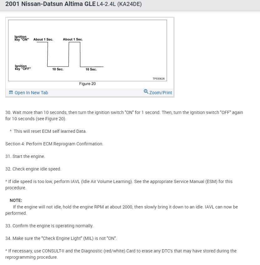

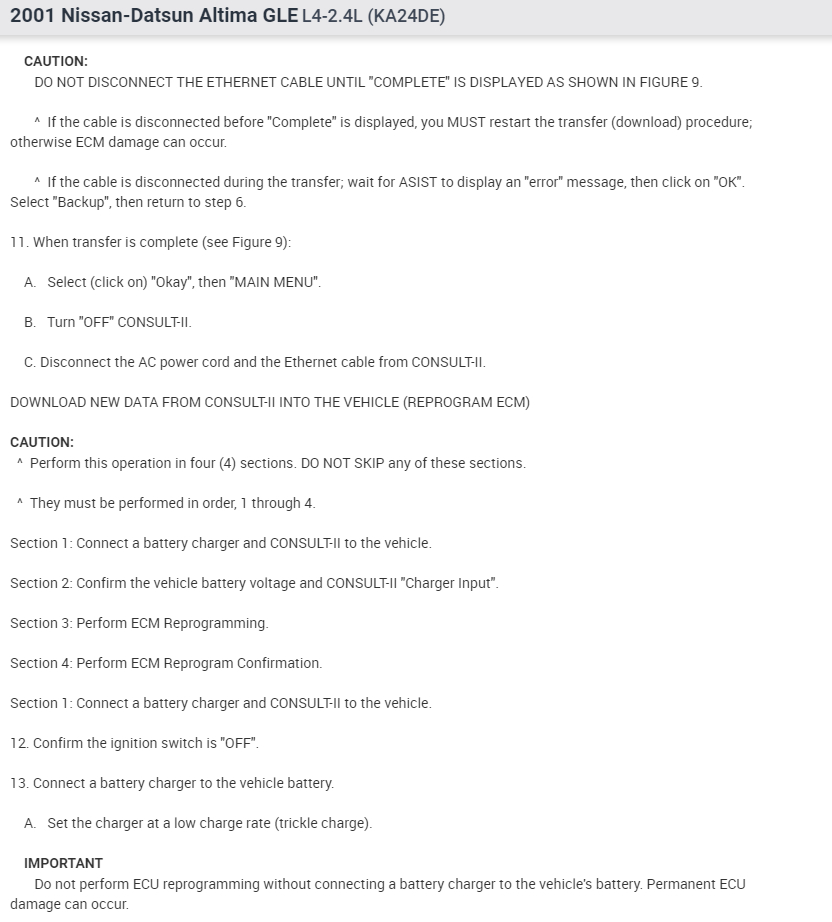

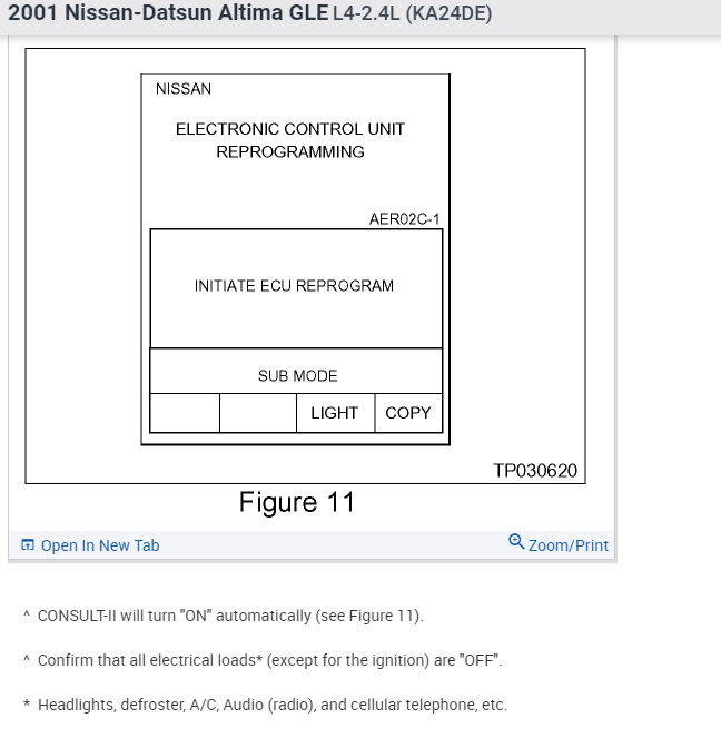

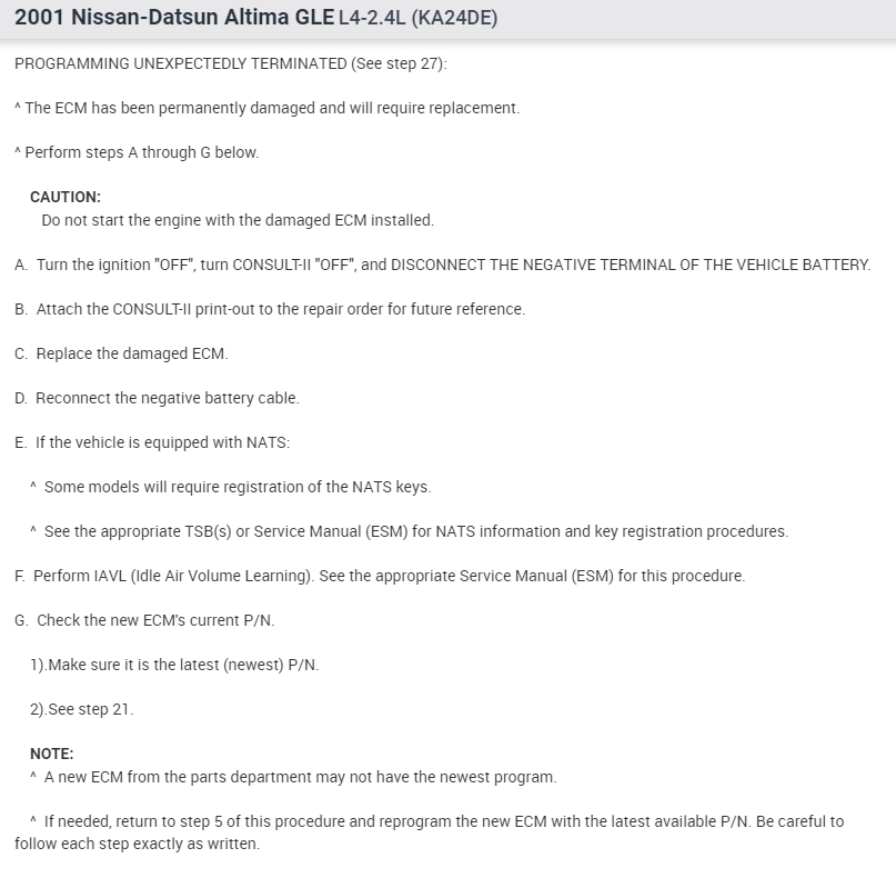

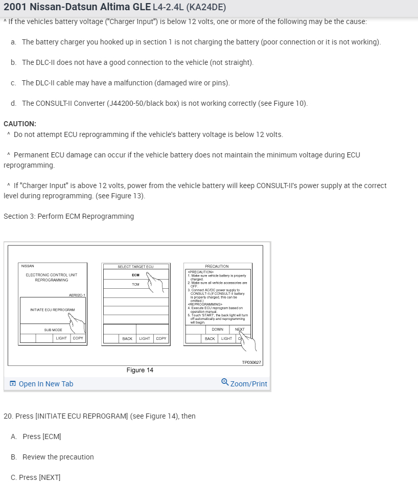

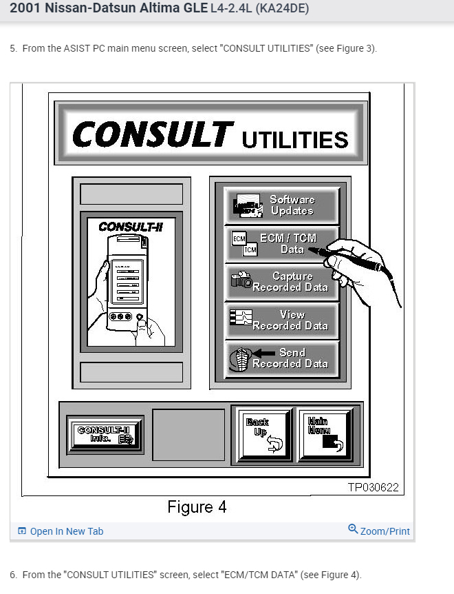

Monday, September 26th, 2022 AT 8:59 PM
SQM
  • 6,383 POSTS
I have attached the ECU programming procedure that Nissan recommends. It does require scan tool to perform.
Wednesday, September 28th, 2022 AT 9:38 PM

Tuesday, October 4th, 2022 AT 7:53 PM
SQM
  • 6,383 POSTS
According to Nissan any replacement ECU will have to be programmed to the vehicle.
And the procedure is the steps that I have attached on the previous post. It shows step by step process.
