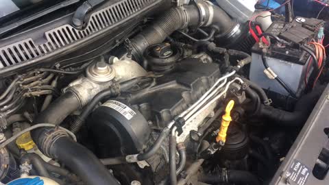

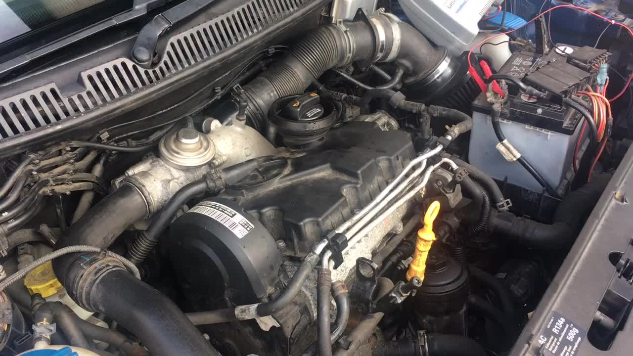

Put a new engine in as old one had cam belt damage. It turns over but has started making a scrapping noise sounds like metal. It ran for a short time but would not stay idling. Now we have this horrible metal sound when trying to start.
Aug 20, 2018 at 6:12 AM
  • 55,272 POSTS

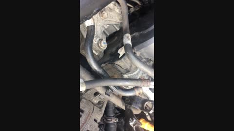

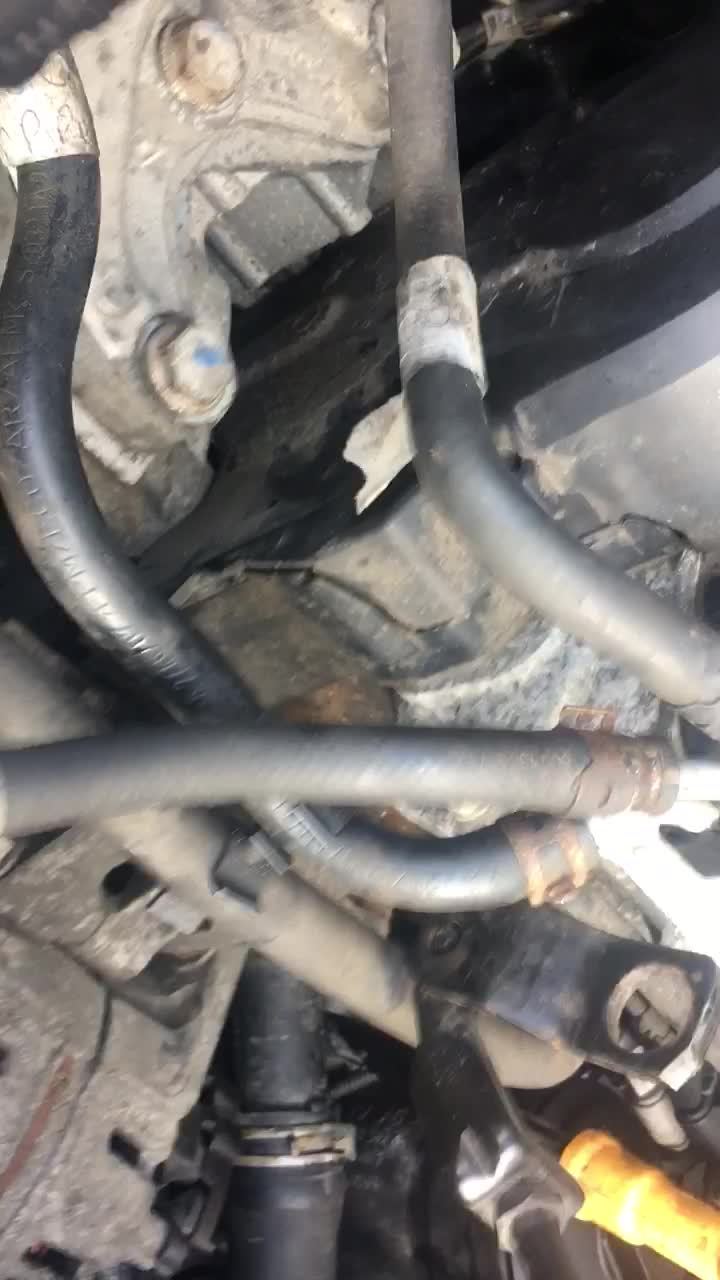

It sounds like the starter is not disengaging, but to be sure can you please shoot a quick video with your phone so we can hear the noise? That would be great. You can upload it here with your response.
Aug 22, 2018 at 4:49 AM
POLO17
The noise gets louder, but it has also ran for about five minutes with revs held on.
Aug 24, 2018 at 10:10 PM
POLO17
Now it will not start just turns over.
Aug 24, 2018 at 10:12 PM
  • 55,272 POSTS
Oh ya, thanks for the videos they really help. I looks like you may have a blown head gasket between two cylinders but to be sure lets do a compression test. Here is a guide to help diesel engines have higher compression but it should still be uniform:
