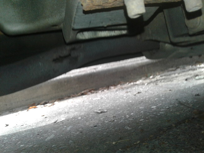

after I put 87 octane gas in my car, I had lost power of acceleration on highway. then my car just shut off once I restarted it and it started to overheat. I check reservoir it is still full, but my car does not start and when trying to start it again it makes a clicking noise. Can you tell me what could be the problem?

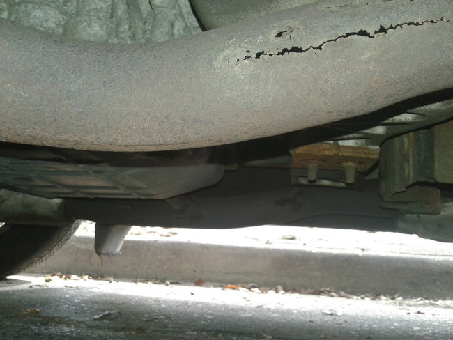

DAVAUGHN DUGGINS
  • 6 POSTS
I think this my problem right here a exhaust leak I have cuts and holes in both of my pipes
Oct 4, 2016 at 6:05 AM
  • 55,433 POSTS
That will do it, please repair and get back to us so it will help others
