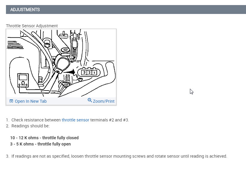

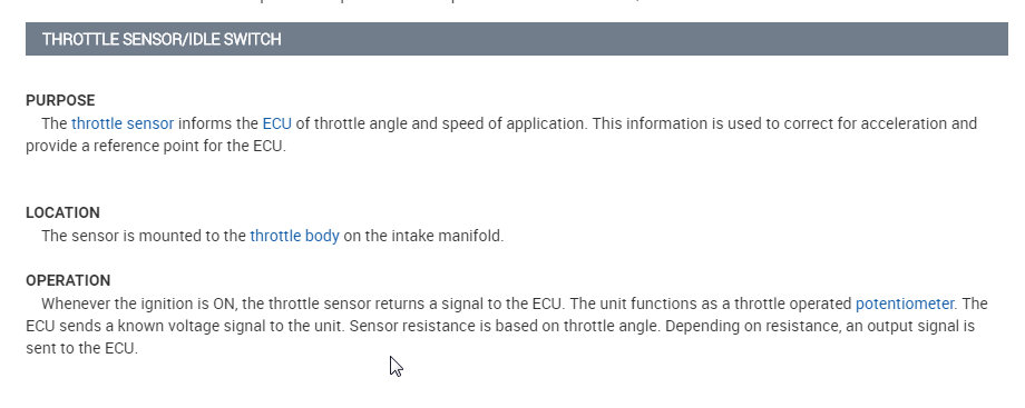

This sounds like either a fuel issue or an input sensor issue like a throttle/idle switch.
First thing is let's check for codes. If there are no codes then I would suggest start narrowing this down by checking fuel pressure. If fuel pressure is okay then we need to test the throttle sensor.
This is a potentiometer sensor which means if we monitor the voltage it will increase and decrease as we operate the throttle blade. If the voltage gradually increases and decreases then it is operating properly. If it jumps around or skips up and down quickly then the sensor is most likely the issue.
However, I included the process on how to adjust it. We should perform this as well before replacing it. Let me know if you have questions. Thanks
