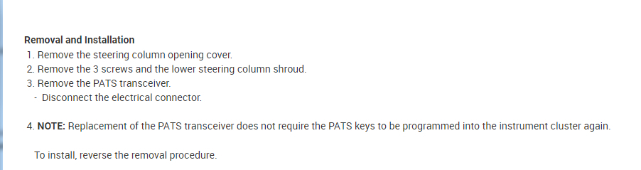

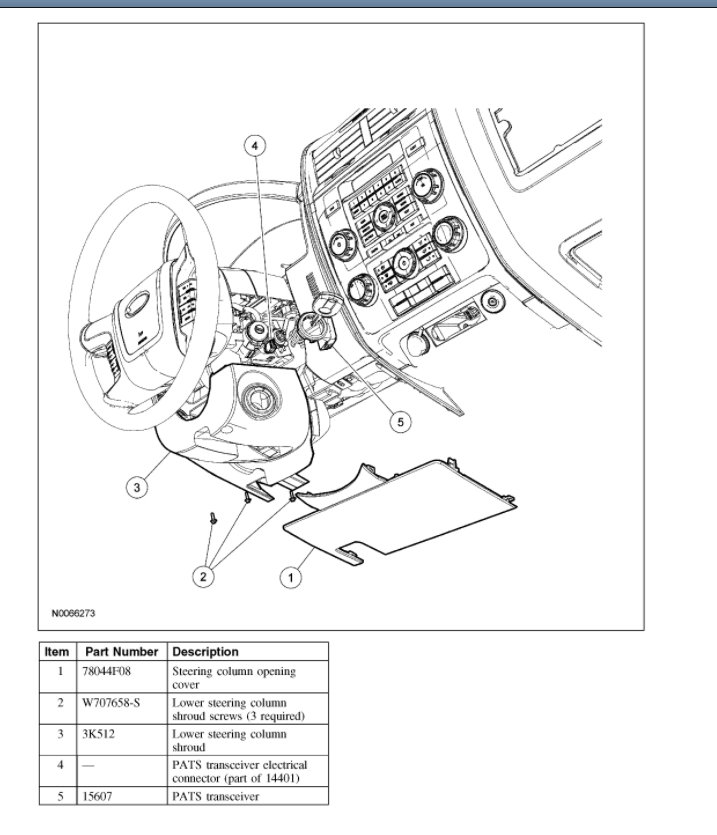

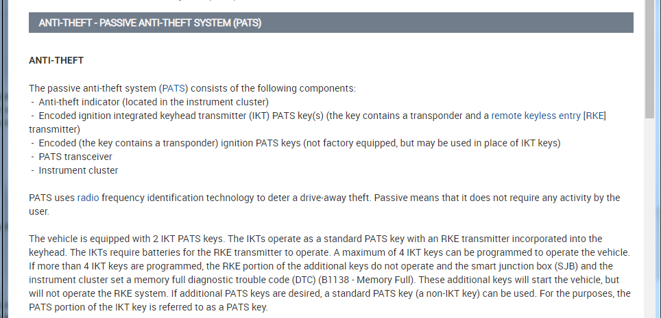

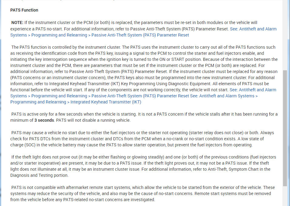

Unfortunately it may be cheaper to fix the transceiver then try and bypass it. I attached the info below on how this works. There is no way to bypass it other then to get a PCM that has this system deleted. The reason is, the way it works is the transceiver picks up the key code and then sends it to the cluster and then the cluster sends a signal to the PCM if the code is correct. Then the PCM gets the correct signal and it starts the vehicle.
So if you get a PCM that has this system deleted then it doesn't matter what signal the cluster sends as long as it gets the proper ignition signal.

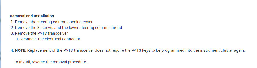

However, if it were me, I would just repair the transceiver if this is all that is wrong. I attached the process below for your review.
Also, we should check for codes just to be sure this is the issue. Clearly it is probably the issue but it doesn't hurt to make sure.
Let me know what questions you have. Thanks

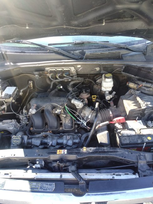

Thank you for the response that really helped a lot. I tried to rebuild the coil for it like I saw in a video but it never kicked over. I also looked into maybe pulling a fuse lol and didn't work. so I just need to find the exact part for it works right away but before the ring coil broke before starting it. Is have to like jiggle or shake the components being the left side of steering wheel below the light lever to start it. I believe it's the starter but I could be wrong but together I have about $75.00 I can spend on fixing it so if anyone can point me in the right direction to being able to fixs it with the right parts I'd greatly appreciative. it I'll post some pics of what I'm working with thanks in advance.
