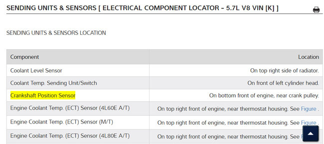

The only things my moderately experienced self can conceive of is either the distributor itself isn't functioning, or the crankshaft position sensor is bad. This is where it gets weird...
I can't find it. Anywhere. I've found diagrams saying it should be behind the harmonic balancer at around the 7 o'clock position, or behind/beside the starter itself (I did find something there but it's not the sensor, from what I can tell. Single wire (now, I think,) only).

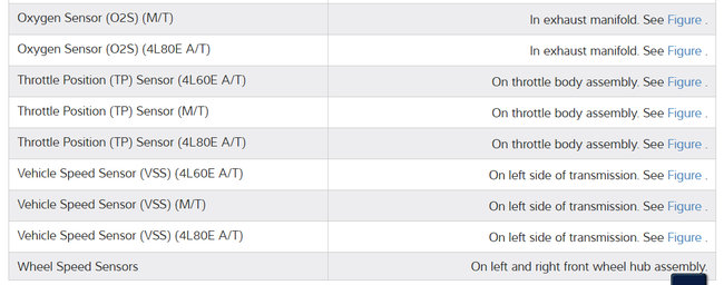

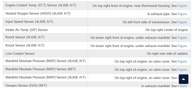

I have included the full list of your vehicle's sending units and sensors in the diagrams down below for you. Please go through this guide and get back to us with any questions you may have or tell us how everything turns out.
Thanks,
Alex
2CarPros
Sep 12, 2019 at 7:50 PM
MAELSTROM669
  • 7 POSTS
Where did you send that?
Sep 12, 2019 at 10:09 PM
SCGRANTURISMO
  • 4,897 POSTS
Hello again,
I am so sorry, I forgot to send those. Here they are. Again, sorry.
Thanks,
Alex
2CarPros
