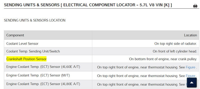

SCGRANTURISMO
  • 4,897 POSTS
I have included the full list of your vehicle's sending units and sensors in the diagrams down below for you. Please go through this guide and get back to us with any questions you may have or tell us how everything turns out.
Thanks,
Alex

SCGRANTURISMO
  • 4,897 POSTS
Hello again,
I am so sorry, I forgot to send those. Here they are. Again, sorry.
Thanks,
Alex
