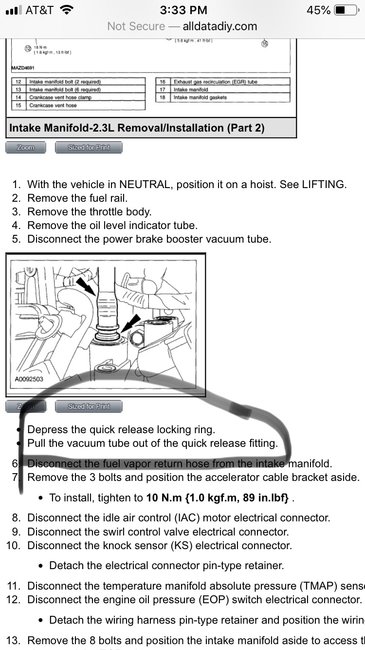

I don’t know what are how to look this locking ring part up?
I have a picture attached.
Where on earth can you find this information? I see everything about tools and disconnecting the quick connect but nothing about buying the cheap plastic fittings.
They look almost what like the pneumatic push lock fittings have inside (the blue plastic ring)

It’s about the quick disconnect fitting as I posted in the op. Where can they be purchased or found or part # for that matter
image attached on first post locking ring.

if you look at picture it shows you. This is where the brake booster hose connects to the intake manifold.
I have no idea what procedure you are looking for?
The only diagram I could pull up to show reference of what I am doing was the intake manifold removal procedure.

Okay, thanks. Now I know you are doing an intake.
That fitting has a collar. You push the collar down and the line should pull out. The collar has to be equally depressed all the way around.
You cannot get just the collar. You have to buy the whole piece.
