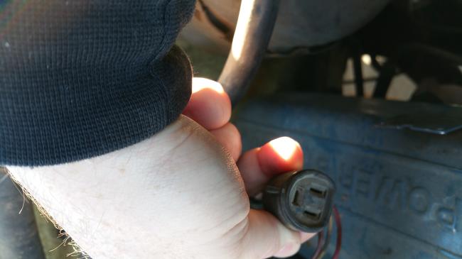

Help, I can't find the ends for these two loose wire connectors.
FORD76460
  • 1976 FORD F-250
  • 7.5L
  • V8
  • 2WD
  • 53,000 MILES
I've searched all over the truck and can't find where the other ends to these wires go. Also, I would like to know what they are. See pictures.
Friday, March 6th, 2015 AT 2:53 PM
3 Replies
HMAC300
  • 48,601 POSTS
Only one pic came through and it's a three wire one with only the connector showing and your fingertips lol. Where is it exactly or close to. And what color are the wires. If it is the color of the wires and points to the electronic ign module and the connector is on the fender well then it to the module which you probably don't have as it may have points in the dist which some person prior to you owning it did.

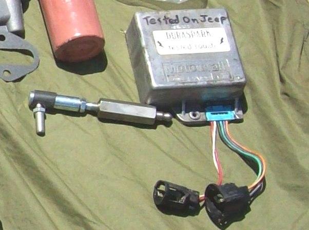

CJ MEDEVAC
  • 11,005 POSTS

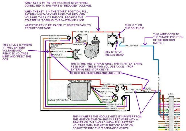

THIS IS A PIC OF THE SPARE IGNITION MODULE FOR MY JEEP CJ-5 (JEEP USED FORD IGNITION SYSTEMS FROM 1979-1989 ON CJs AND EARLY WRANGLERS)
THERE WERE 3 SIMILAR CONNECTORS
2 HOOKED TO THE MODULE
1 HOOKED TO THE DISTRIBUTOR
MY LAST PIC IS HOW IT ALL GOES TOGETHER ON THE JEEP
