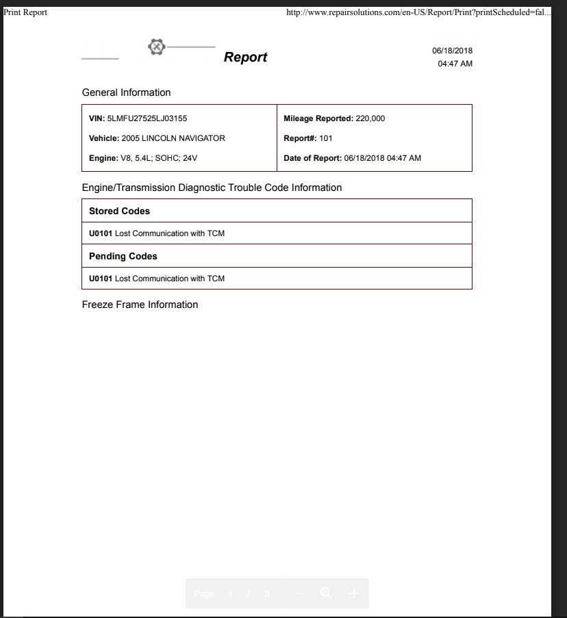

My vehicle was running well. Heck, I just came for Waco a day ago.
The last drive was a short drive to the store. On the was back I ran over a railroad track
that was bumpy as heck. Soon after rolling over this bumpy bumpy ride (I did not slow down much) thought I could roll right over.
After rolling over the tracks I lost power, tapped on the gas but no go, I could only go about five to seven miles per hour, slow for about one block until I got to my house. That is when I cut the engine.
I noticed that the "check advancetrac" symbol came on solid after I went over the train tracks.
Now it just will no say any thing when I attempt to turn the key to turn it on.
Things i have verified:
The Battery: all lights come on, the horn honks, the lights in the cab do not go dim with attempting to start.
The starter: I ran a wire from the starter solenoid(thin wire) to the positive of the battery it started with low idle but with no thrusting power. I put it in gear and it goes very slow forward and backward.
I thought it may be the collision airbag sensor. I read somewhere that it might be in collision mode. I do no know, I am reaching.
I am also reaching out to all who might know what I can do to DIY and or who might have a resolution, solution, and just plain old fix.

Yes, I have retrieved the codes and here are the results below.

Okay, this usually means you have a fuse out or the PCM has failed and needs to be replaced. Here is a guide to help you test for power at the fuses and the 28, 9 and 27 fuse locations:

It sounds like the starter relay or the fusible link has gone out. Here is a guide and the wiring diagrams so you can see where you are losing power. Start with the trigger from the ignition switch.
