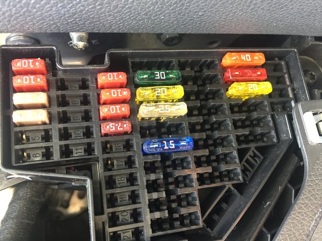

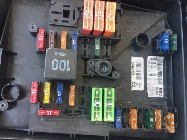

Hi Roy,
The test light has finally arrived.
Great bit of kit pointed out why the car won't start but still don't know where the problem lies.
Test light shown.
No power to fuse at the top and bottom of fuse panel at the side of dash (photo attached).
No power to the 4 fuses either side of the 100 relay in engine compartment (photo attached).
What next please?

Can you tell me what the fuses control? It should be on the cover for the fuse block. That way, I can get a diagram of the fuse block to find out what powers those fuses.
May 26, 2020 at 11:16 PM
LONE RANGER
  • 10 POSTS
Roy,
My apologies I did a light test on the fuses with the ignition off and the result was what i posted to you earlier.
i have now carried out another light test with ignition on and all fuses working sorry for the school boy error .

May 27, 2020 at 1:35 AM
LONE RANGER
  • 10 POSTS
The result from ignition off related to engine management system, engine control module. With ignition on all fuse okay does this mean that the ECU is okay or is this just wishful thinking by me?
