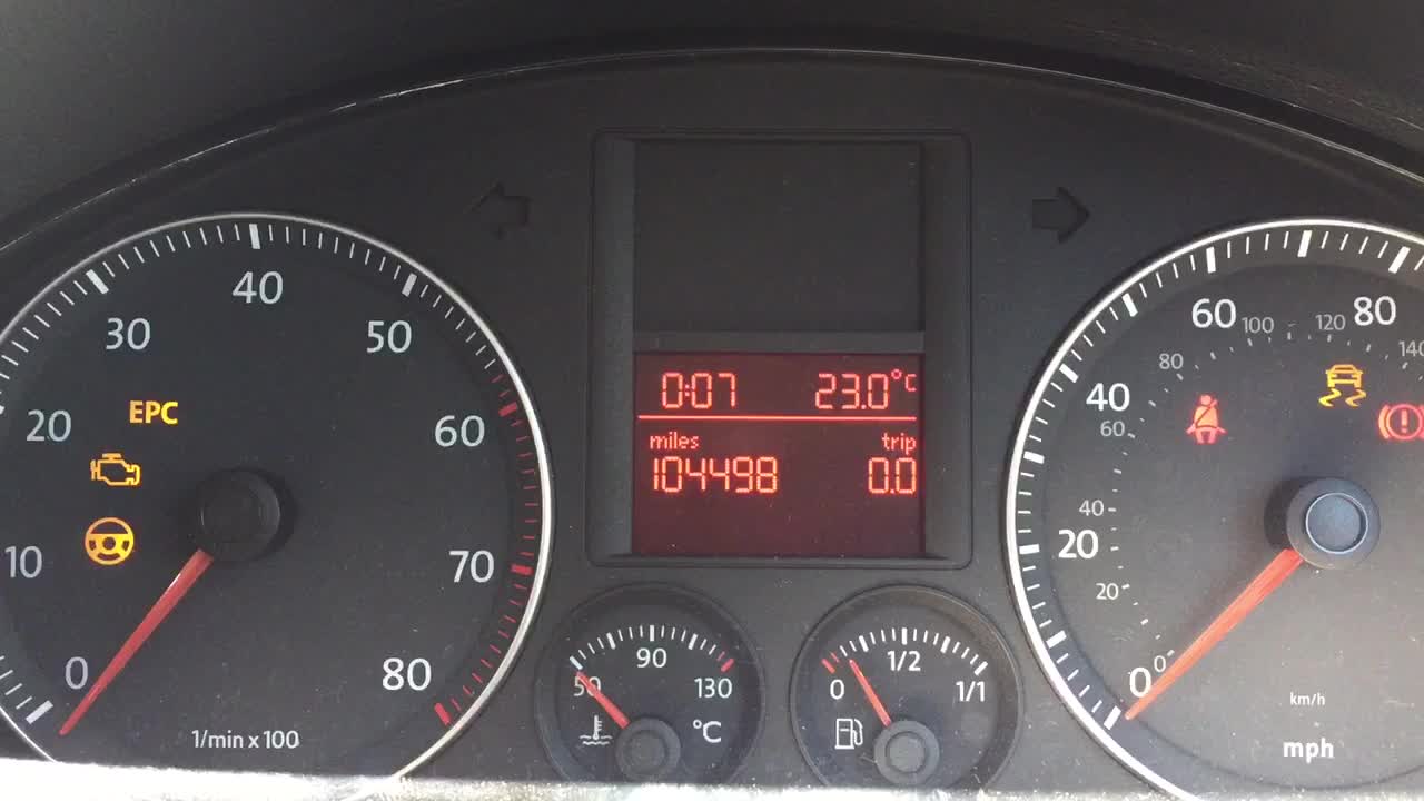

car cranks over won't start, no wipers front or rear, no washers front or rear, no main beam flasher, no hazards, no horn and no interior light. Also, anything connected with steering wheel/column not working. fault codes 17089, P0685, 0883 and 0576. Please help I need to get my daughter's car back on the road.

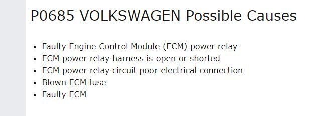

The 685 seems to be the key. This is for the power control relay and that controls power to all the modules which explains why you have all these failures.
Check all your fuses for power on both sides with a test light to be sure power is available.

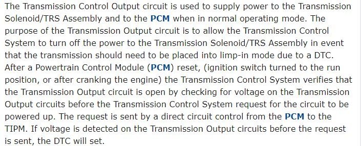

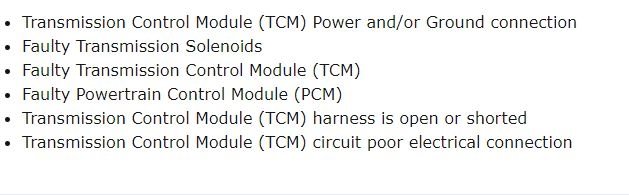

Are you having any issues with the transmission? The 883 is about voltage to the transmission control module.
I do not have immediate access to wiring diagrams for you. I will keep searching and will update when I get the diagrams.

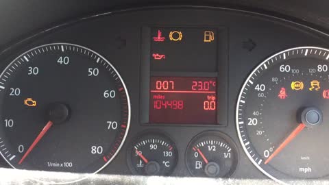

Okay, a couple questions.
1. When you crank it, does the tachometer move up a little showing RPM? That will tell me if the crank sensor is working
2. When you turn on the key, does the fuel pump run?

1) Yes, slight movement on tachometer, please see video attached.
2) Yes, i can hear the fuel pump engage.

Okay, I do not see any RPM reading at all. This indicates to me that the crank sensor is not working.
https://www.2carpros.com/articles/how-a-crank-shaft-angle-sensor-works
I am having trouble finding information for this engine. I will see what I can find for the crank sensor. I will update when I get more information.

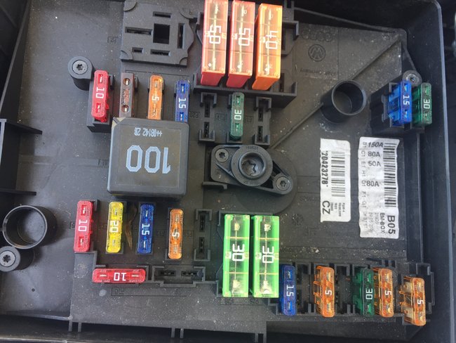

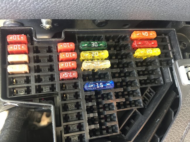

Hi Roy,
The test light has finally arrived.
Great bit of kit pointed out why the car won't start but still don't know where the problem lies.
Test light shown.
No power to fuse at the top and bottom of fuse panel at the side of dash (photo attached).
No power to the 4 fuses either side of the 100 relay in engine compartment (photo attached).
What next please?
Alex

Can you tell me what the fuses control? It should be on the cover for the fuse block. That way, I can get a diagram of the fuse block to find out what powers those fuses.

My apologies I did a light test on the fuses with the ignition off and the result was what i posted to you earlier.
i have now carried out another light test with ignition on and all fuses working sorry for the school boy error .
