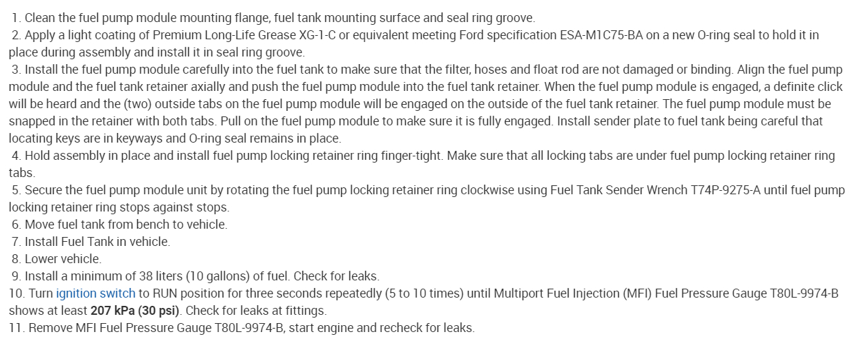

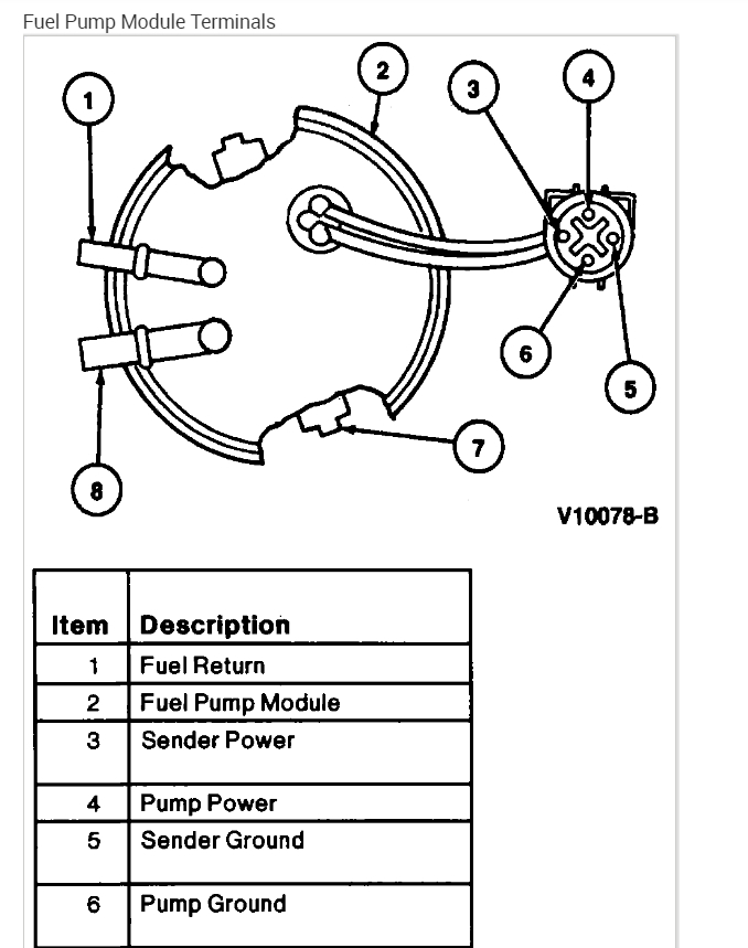

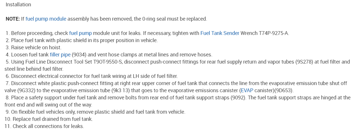

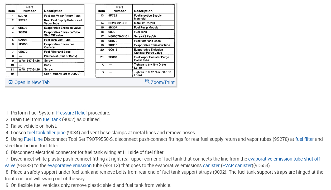

Yep, I have seen a weak fuel pump cause this problem, we should run the codes though, this guide can help:
If no codes are present, we can do a fuel pump pressure test, you can rent a fuel pressure gauge from the auto parts store for free or cheap.
Key On Engine Off 35 - 45 PSI
Key On Engine Running 30 - 40 PSI

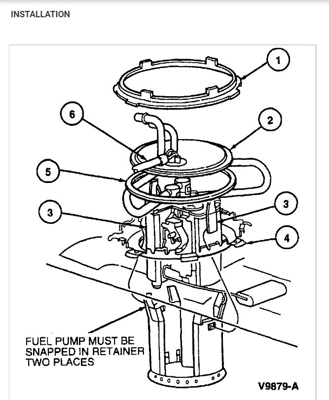

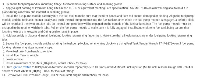

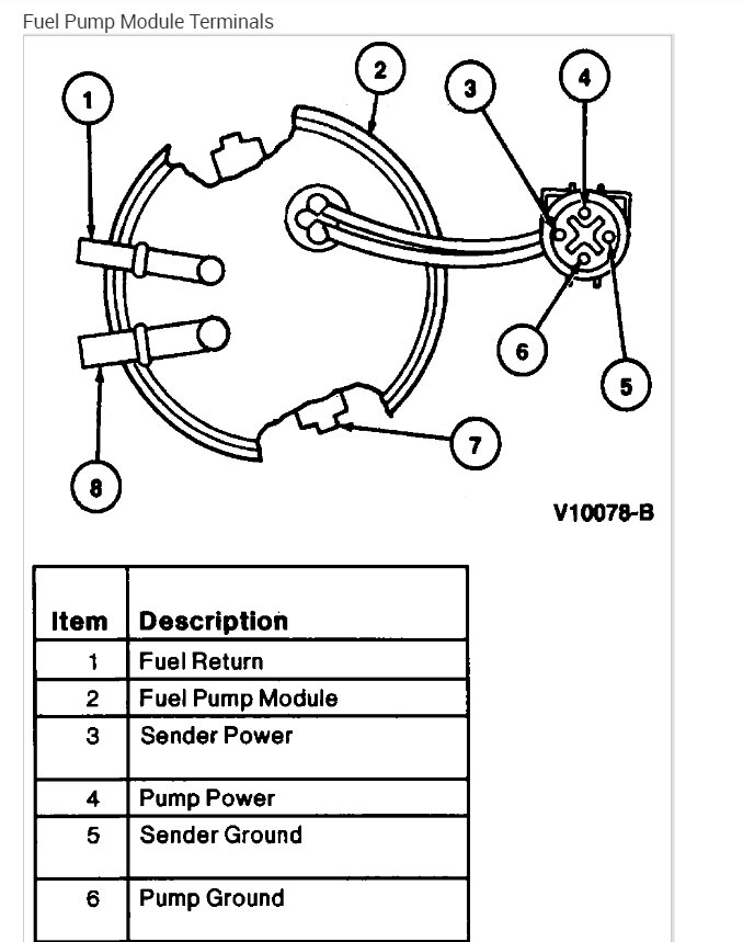

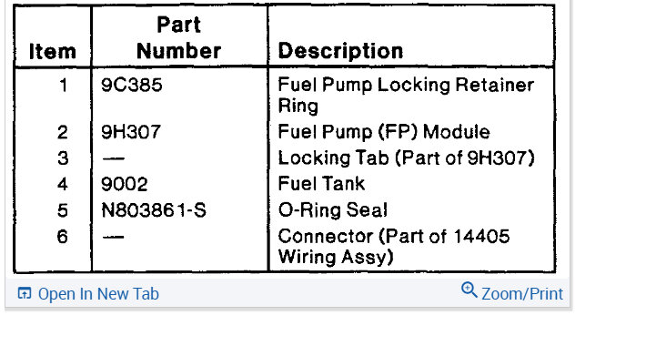

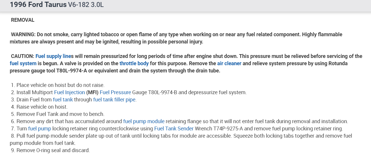

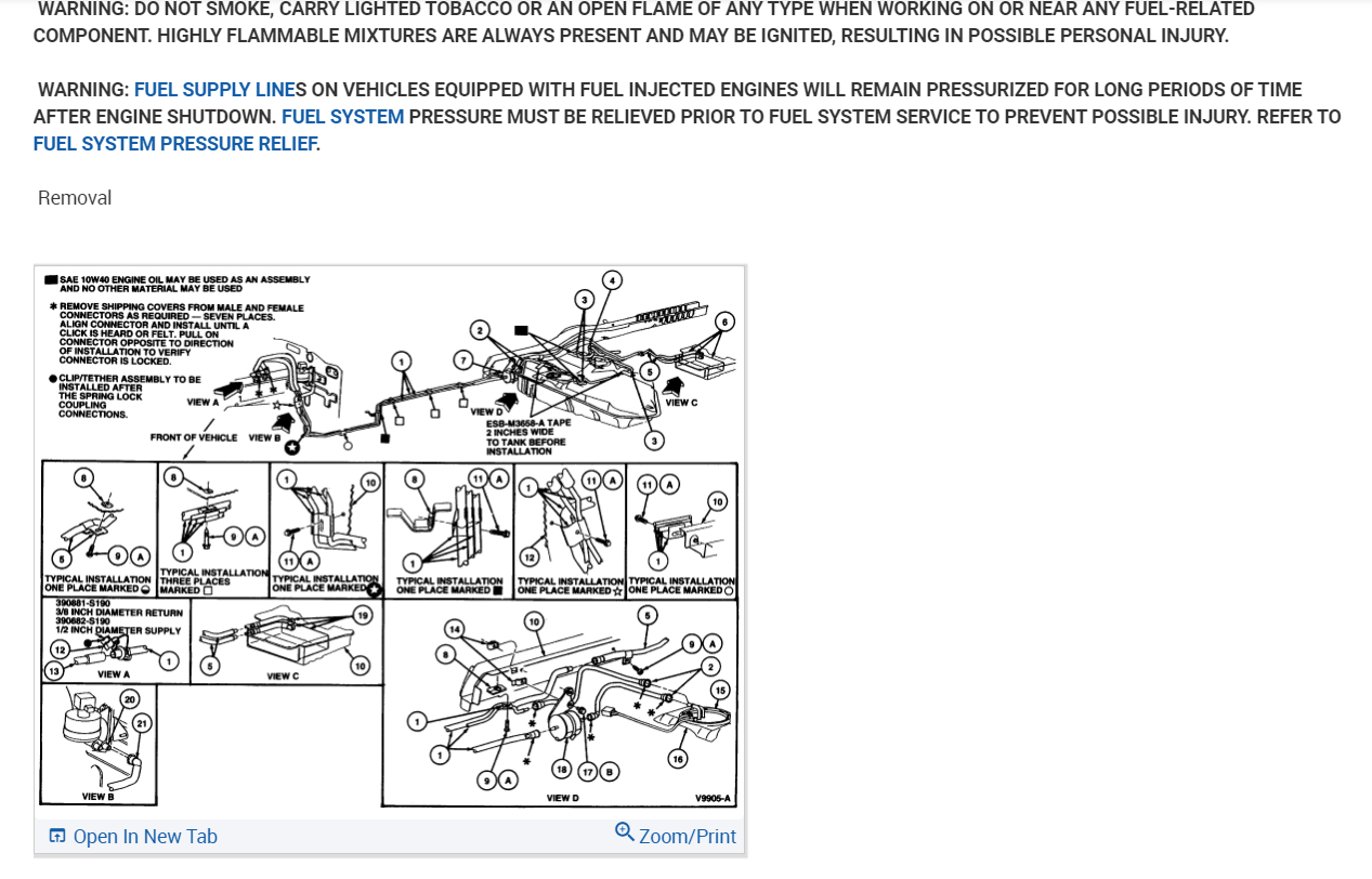

Here is how to change the pump out in case you need it. Check out the images (below). Please let us know what happens.
