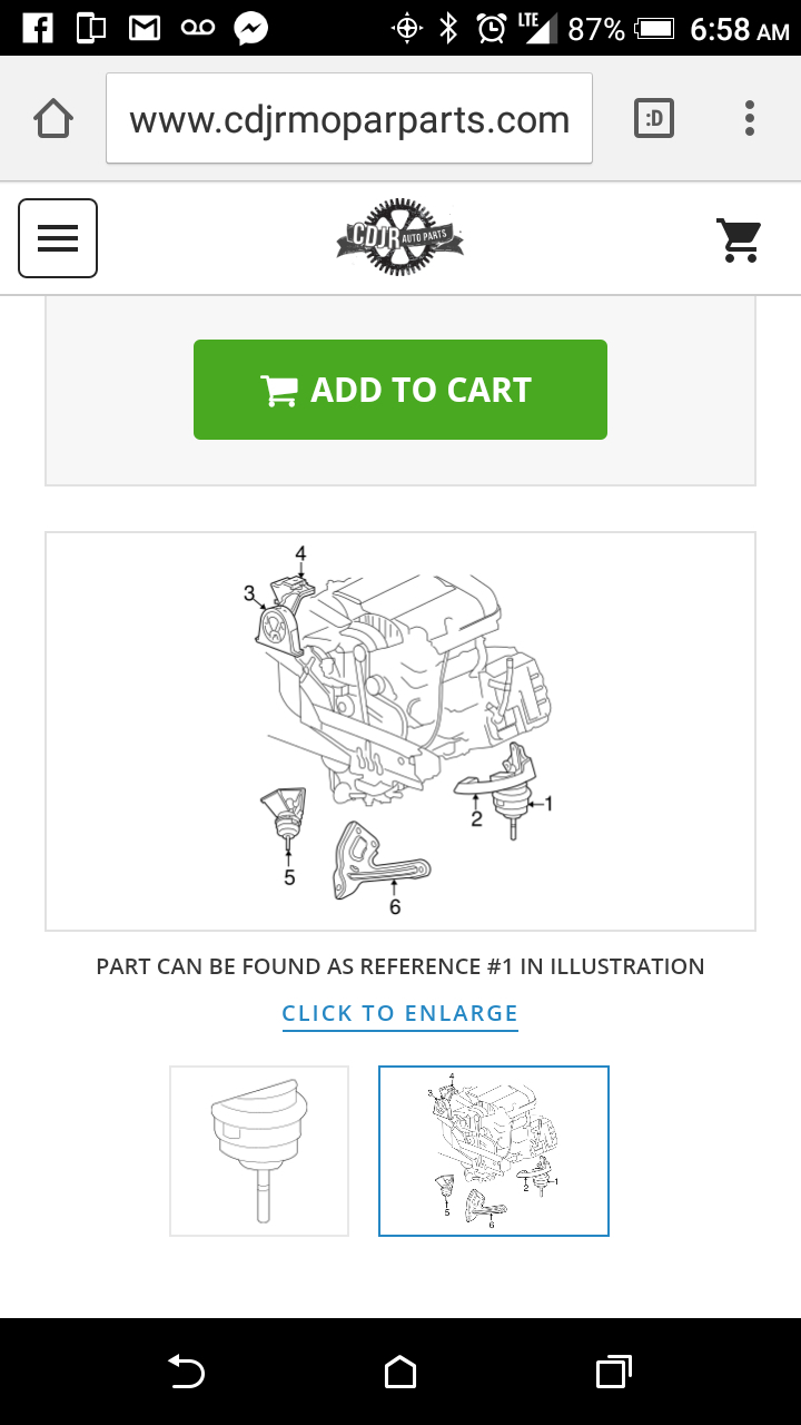

Okay, here is a lady question for you. My mechanic says order all mounts and transmission mount. They are all broken except the right. The problem? Not one site mentions a left. Not on the four liter all wheel drive. Only front rear and right! Also, the transmission mount? With or without a bracket. Some say 3-8 or 4.0 Some say 4.0 only. I am so confused. And too poor to order the wrong thing with my little girls Christmas money! Please do not tell me to get rid of it. I own one thing in the world, this car. And I Love her. Look at it this way, even if I never manage to fix it, I can live in it after I break myself trying. Help me so I can commit to hitting the proceed to checkout button on the correct parts. Thanks in advance.

for the 4.0L there are three mounts. A left, right and upper that is all our manual shows the right and left support the transmission/engine combo. if they are not hydraulic they are less than $20.00 each approximately, but if hydraulic they are about $160.00 each.

Thanx so much! Y'all have truly helped me. Maybe I can use this promo on this bracket I'm about to ask you about. We know my 4-0 is very heavy 4500 lbs! And the trans are know hard sifters. So when looking at the Chrysler diagram I noticed that the lower mount has a bracket. Now. If all my mounts are broken. And my engine has shifted until it's binding up the wires to my turbine sensor and causing it to sporadically throw a code while driving, then I'm thinking ,no way that lower bracket isn't broken! I'd hate to pay 300$ to have it all torn down and my mechanic say, ya need that there bracket! So what do y'all think? Here's a pic. Chrysler parts guy says, I doubt you need the top one. Well don't doubt my lbad luck buddy! it's shifted so bad you can't get the oil dipstick out!

brackets normally don't break unless about 30 yrs old or been in an accident. I wouldn't worry about the bracket and like dealer says top mount is probably not broken. I doubt broken mounts would cause a code but I've seen stranger things.
