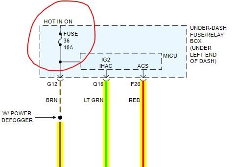

So drove my car a couple hours straight my dash was hot couldn’t turn on heat or air. no lights on panel, no A/C or heat to access. it’s like no power is getting to the panel. what can I do?
Oct 6, 2019 at 11:15 AM
  • 110,194 POSTS
Welcome to 2CarPros.
The first thing I need you to check is the fuse. It is located under the dash. See pic 1 for location, fuse number, and amperage requirements.
