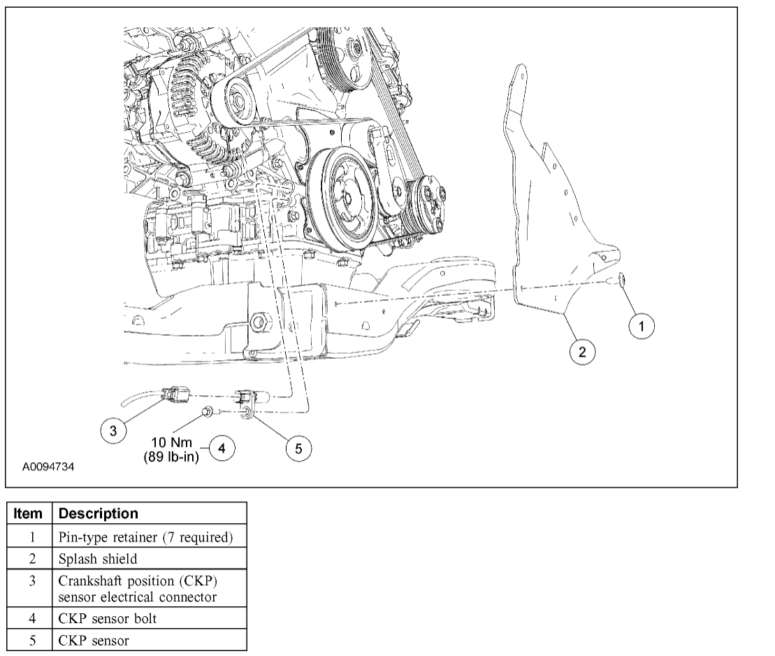

Engines just stalls. I have to pull over turn the car off for five minutes.
Aug 7, 2017 at 9:43 AM
  • 55,721 POSTS
This sound like a classic crankshaft angle sensor that is going out. Here is a guide the will show you what you are in for when doing the job and some diagrams (Below) of what it will be like on your car.
You may need to jack the car up to do the job and here are some more guides to give you additional alternatives.
and
https://www.2carpros.com/articles/engine-stalls
Please let us know what happens, we are interested to see what it is.
