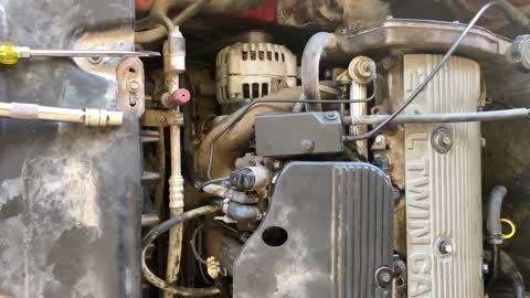

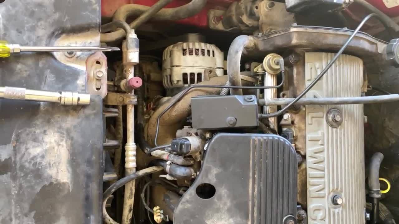

I have something going on with my aunts car. It need plugs and valve cover gasket. Car run good for being so old. after putting new plugs and changing gasket now you start the car rpm's going up and down then shuts off. any help would be great.
Oct 19, 2020 at 3:25 PM
Good morning,
I heard a noise in the video that I did not like. Recheck your work and make sure the parts under the cover are secure.

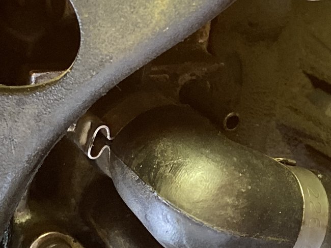

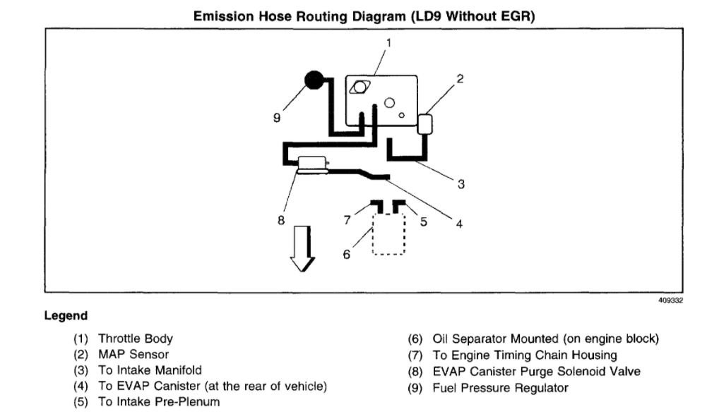

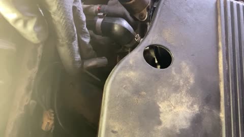

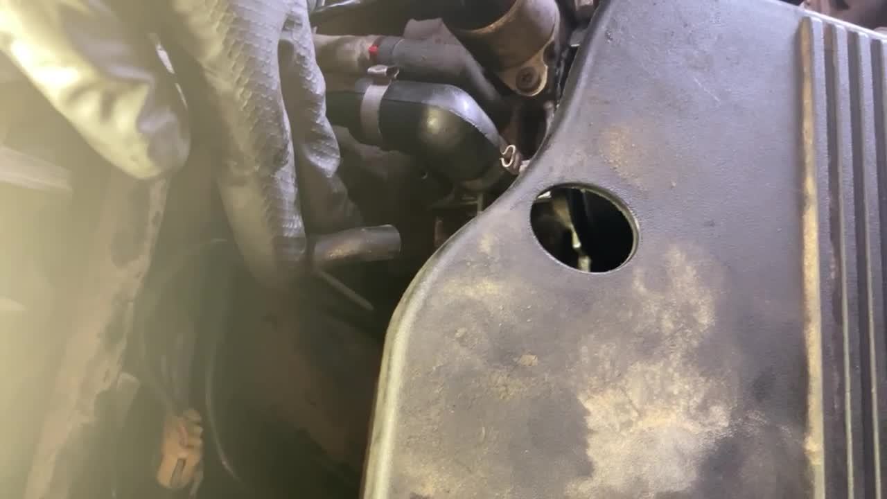

What does this go to???
Oct 20, 2020 at 12:37 AM
I cannot see what you are talking about at all.
Can you be more specific?
Oct 20, 2020 at 12:40 AM
JAY RUSSELL
  • 14 POSTS

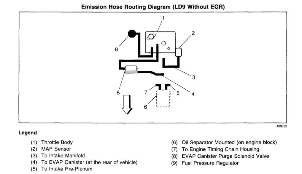

That is where the gray vacuum hose plugs into on the throttle body.
Oct 20, 2020 at 12:45 AM
You are missing a vacuum line there. You need to find the line and reconnect it.
I attached a vacuum diagram for you to view.
Oct 20, 2020 at 12:52 AM

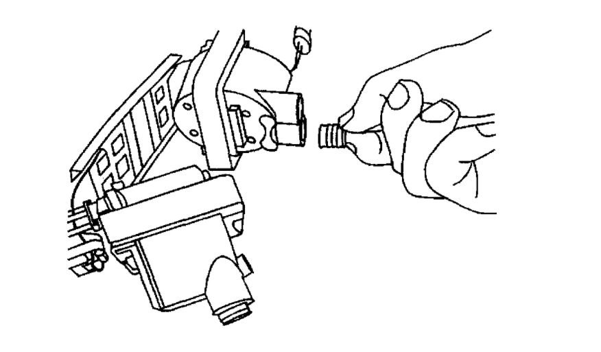

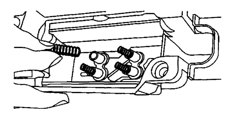

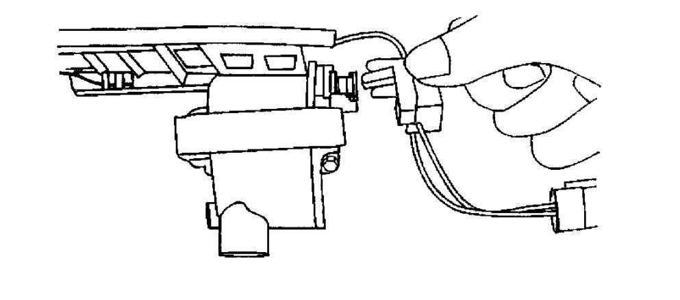

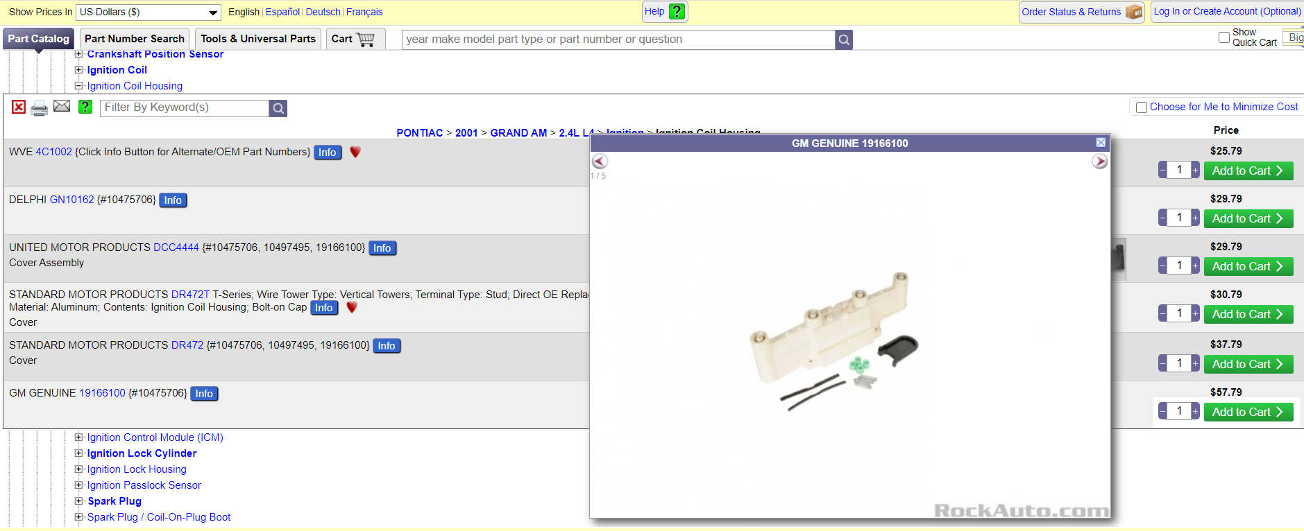

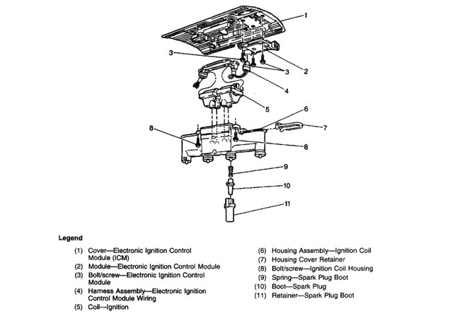

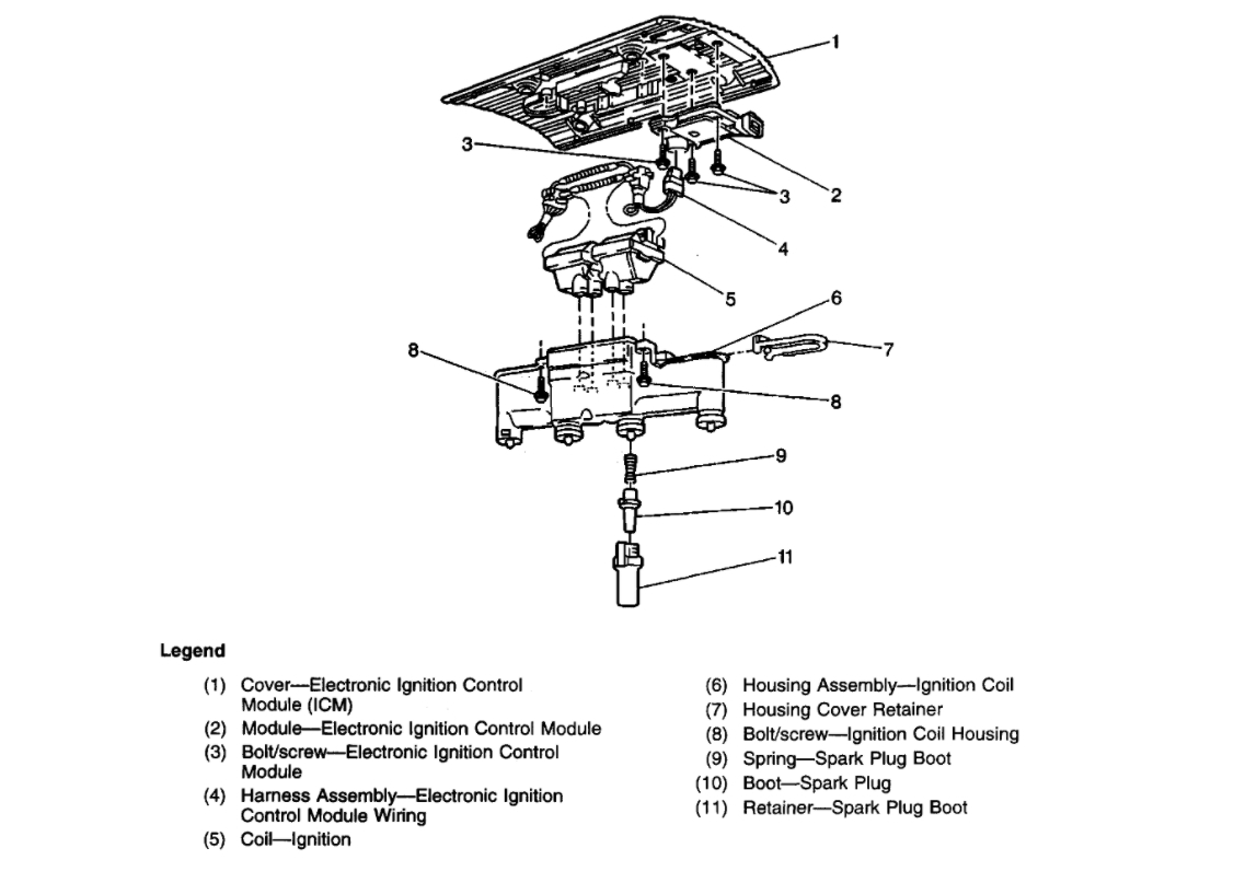

Just to be sure, I posted a picture of the coil housing.
Did you replace this as it is critical.
Oct 24, 2020 at 9:13 PM

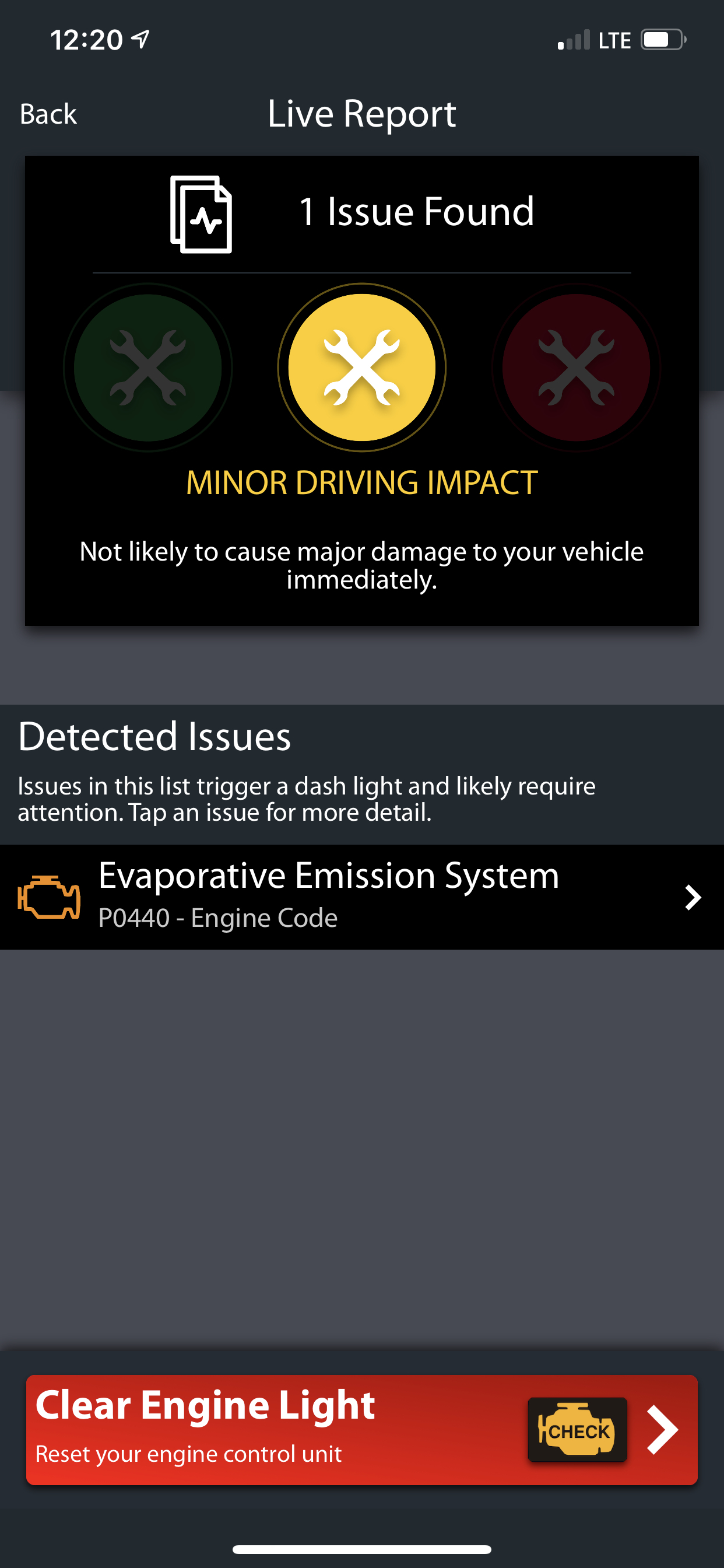

Okay, so I was driving and the service engine soon came on then it gave me this code.
Oct 30, 2020 at 3:28 PM
What is the code number?
Evap code will not cause this issue.

That’s the only code I got and it don’t make a lock of sense to me you think you will be getting codes of some kind when driving the car. I know it uses a lot of gas and you can smell it bad.

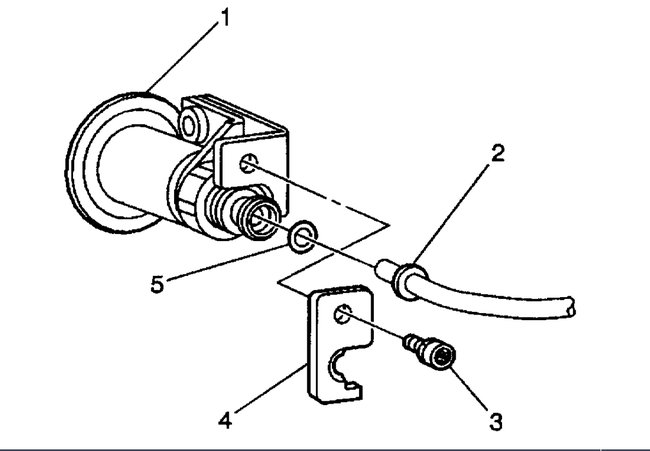

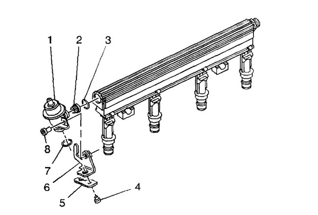

I have found that there is fuel coming out the pressure regulator not a lot but it’s coming out.
Nov 2, 2020 at 2:04 PM

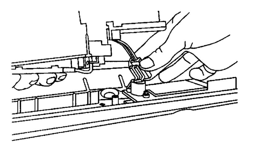

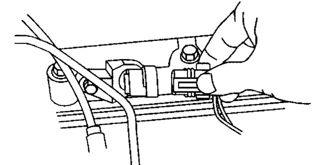

There should be 0 coming out.
Replace the pressure regulator.
1. Remove the fuel rail assembly.
2. Remove the attaching screw (8) from the pressure regulator.
3. Remove the pressure regulator assembly (1) from the fuel rail.
Twist the assembly back and forth while pulling.
FUEL RAIL ASSEMBLY REPLACEMENT
REMOVAL PROCEDURE
1. Relieve the fuel system pressure. Refer to Fuel Pressure Relief Procedure.
2. Remove the air cleaner outlet resonator.
3. Disconnect the fuel pressure regulator vacuum hose.
4. Remove the camshaft position (CMP) sensor connector.

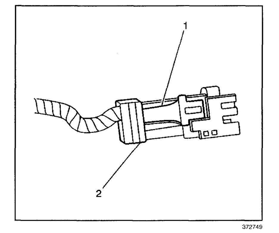

5. Pull up the lock release (2) of the fuel injector connector.
6. Depress the lock tab (1) and lift the connector from the injector.

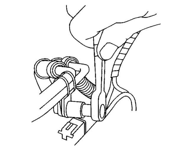

7. Disconnect the fuel feed pipe from the fuel rail. Use a backup wrench on the fuel rail inlet fitting to prevent the fitting from turning.
8. Remove the fuel pipe retainers.

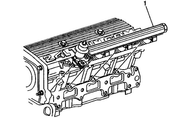

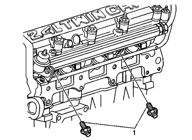

9. Remove the fuel rail attaching bolts (1).
10. Lift the fuel rail assembly (1) from the cylinder head.
11. If the fuel rail is not being replaced, go to the installation procedure.
12. Remove the fuel return pipe bracket screw (3) and the bracket (4).
13. Remove the fuel return pipe (2) from the fuel pressure regulator (1).
14. Remove the fuel return pipe. Discard the O-rings.
15. Remove the fuel pressure regulator.

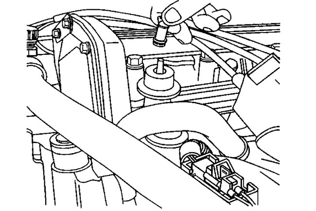

16. Remove the fuel injectors.
Nov 2, 2020 at 8:06 PM
