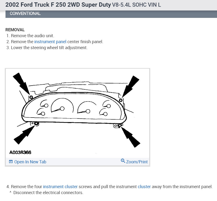

All of my dash instruments do not work
5.4L • V8 • 4WD • AUTOMATIC
DENNIS TRAVIS
However, all of the warning signs are lit up. my power windows do not work, gas gauge does not work, but blinker does.
Oct 17, 2019 at 7:56 AM
  • 55,770 POSTS

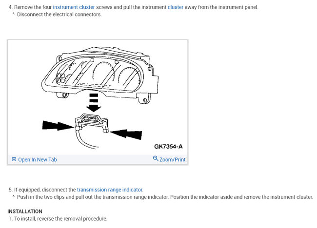

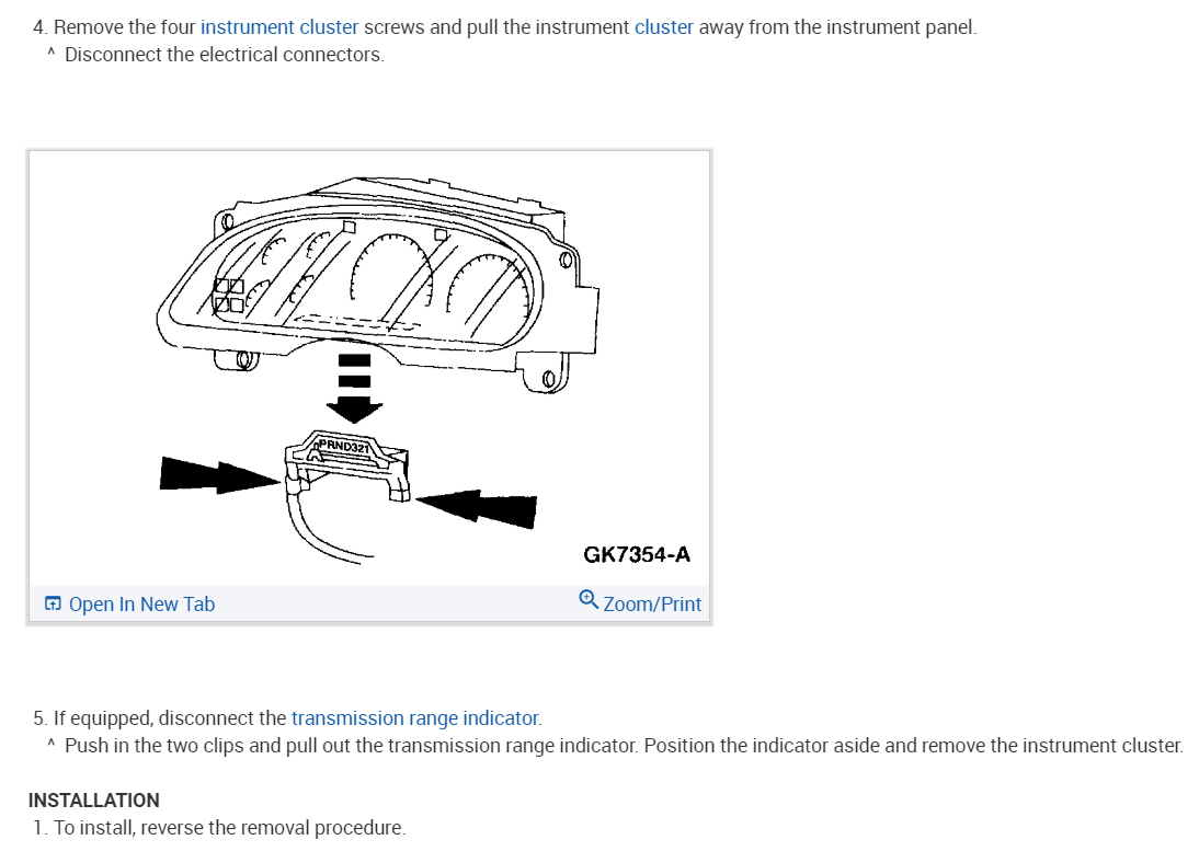

This is common when the cluster goes out. here is a video of the job being done on a similar car with instructions on how to change your out in the diagrams below:
