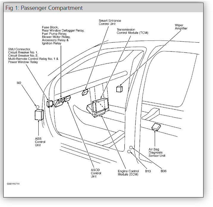

My car has no power to the horn, wiper's, windows, dome light, A/C and wont start. but has a good charged battery.

There is an accessory relay that needs to be checked. here is a guide and the location of the relay:
Check out the diagrams (below). Please run this test and get back to us.

Where is it on the diagram? it does not say.

Oops, wrong diagrams I updated it. please recheck and get back to me.

Put new battery and still nothing works. but taillights stay on. disconnected negative and still stops running.

All fuses are good. would it be the anti theft shutting ever thing down and if so how do you by pass it?

Can you please check the accessory relay? Here is a guide:
Please run down this guide and report back. This relay controls the accessories in question.
This guide will help reset the security system:
https://www.2carpros.com/articles/how-to-reset-a-security-system
