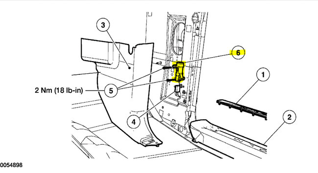

2 days ago, my truck shut off on the highway. I had to pull it home and know my truck starts and shuts right back off. I have replaced the fuel pump and filter, the oil and filter, Park plugs and wires, new battery, and I have replaced the fuel pump control module. please help.

Okay, when it stalls, pay close attention to the tachometer to see if you notice it drop before the engine shuts down.
Also, I want you to try locating the inertia switch and resetting it. This switch automatically shuts down the fuel pump in the event of an accident. If I recall, they are bypassed in the start position and then power travels through them when the key returns to the run position.

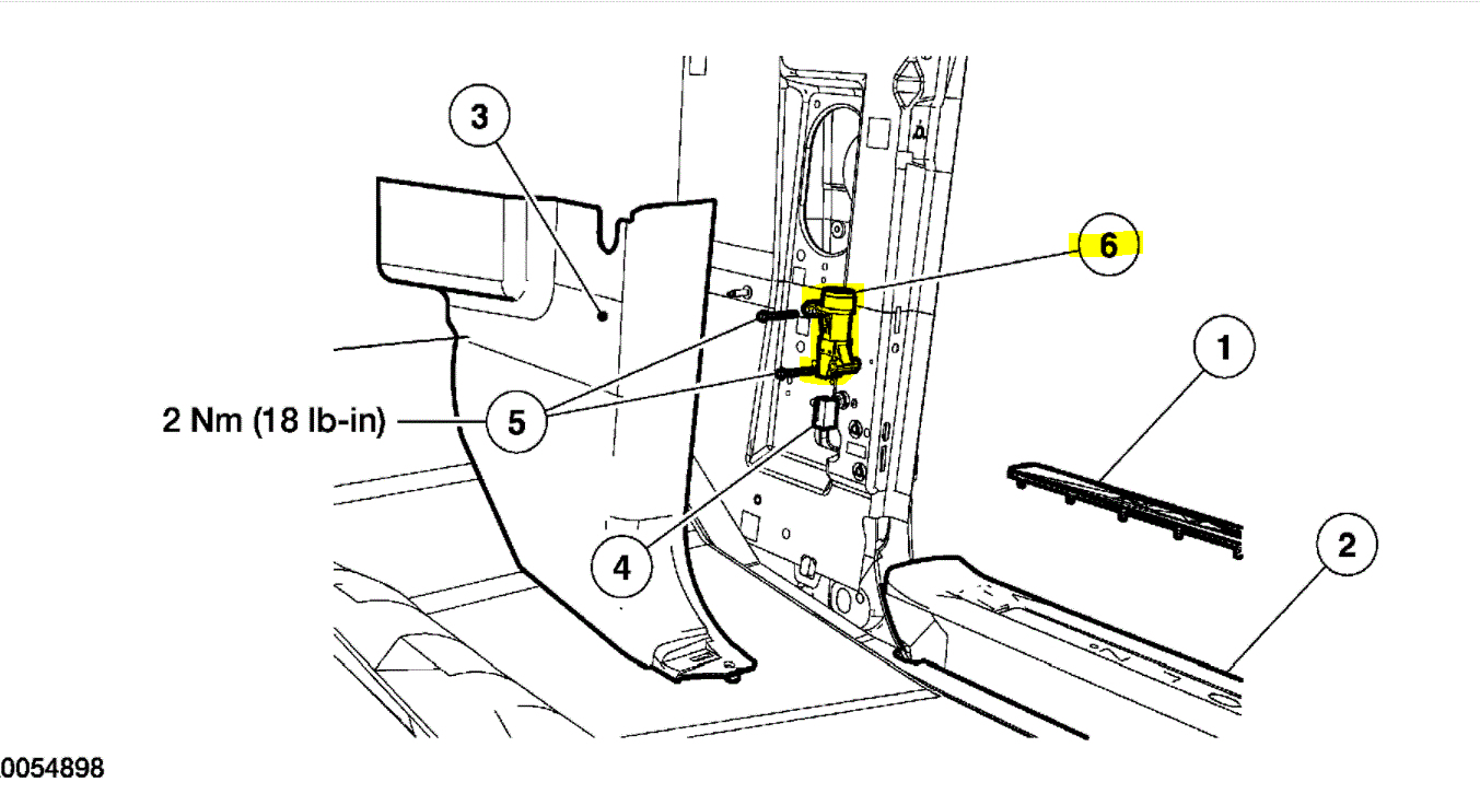

The switch is located on the passenger side behind the left kick panel (where a passenger's right foot would lean.). See pic 1 below.
There is a reset button on it. Press it and see if it changes anything.
See pic below.

Quick question does the fuel reset button supposed to be popped up or is it supposed to be pushed in?

I believe it should be pushed inward. Have you already checked it? If it was already in, you wouldn't be able to reset it.

The button is popped up I can press it down.

Yes, press it down and see if it changes things.

No still didn't change anything.
