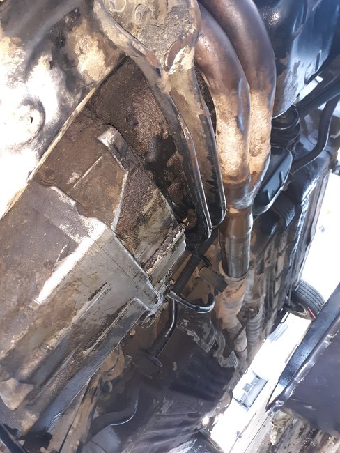

So are still having trouble finding the oil leak. Pretty steady drip, and he checked the sensor that's right above the oil filter and it is okay. Problem is he took off the distributor to make sure that wasn't leaking and now the car wont start again. Ugh.. this car is becoming so much work.
Sep 30, 2020 at 3:49 AM
Can you attach a picture of where you see the leak?
PURRFECT312
  • 20 POSTS
I have attached a few photos. Let me know .
I need to see more around the area it is leaking from. That just shows it is leaking.

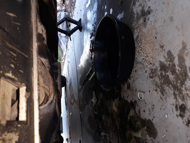

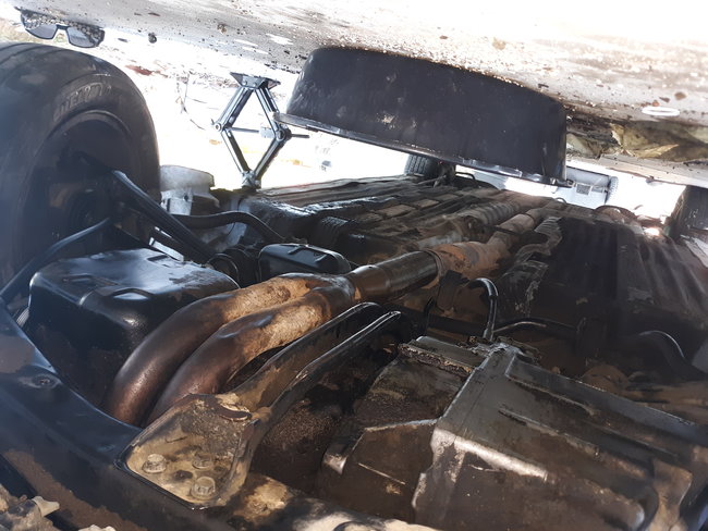

PURRFECT312
  • 20 POSTS
Okay, give me a few for that, lol. I don't normally crawl under the car. lol
PURRFECT312
  • 20 POSTS
Sorry they are not the best .
Sounds good. I will be here.

Did you see the pics? Sorry I'll try to get better pics .
Okay, did you use new head bolts when the head gasket was replaced?
Make sure the valve cover gasket is not leaking at the corners.
Did you put in a new o-ring at the distributor?
