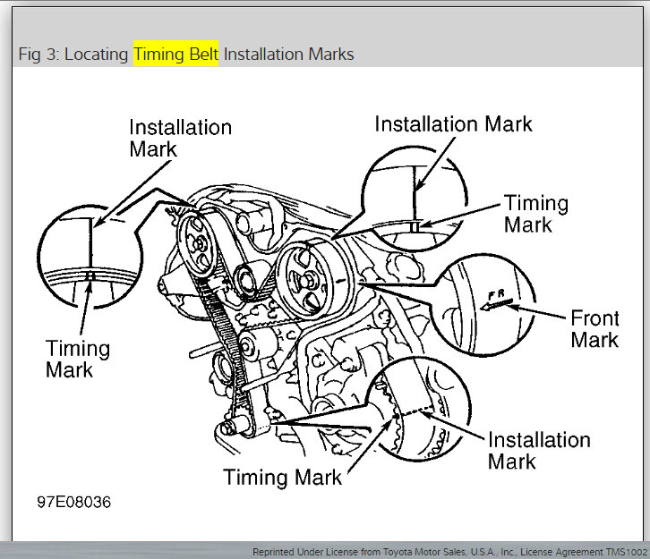

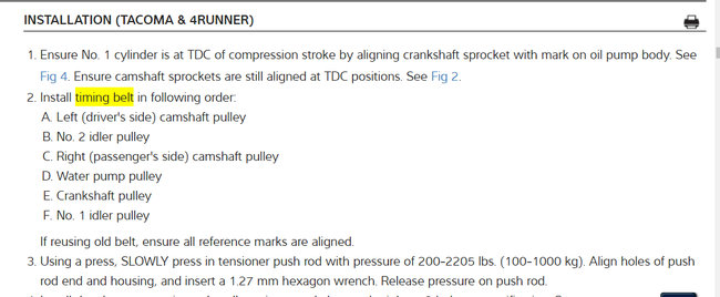

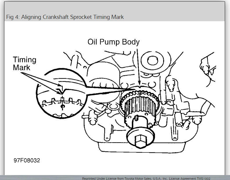

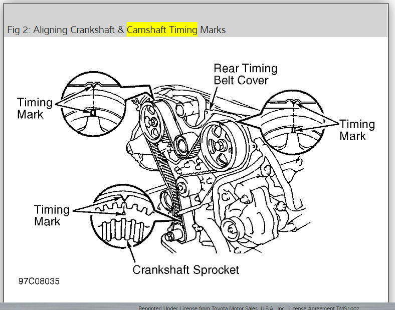

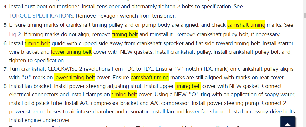

i need help setting my exhaust timing mark without moving the other timing marks. Help ASAP!
Apr 21, 2019 at 8:33 PM
SCGRANTURISMO
  • 4,897 POSTS

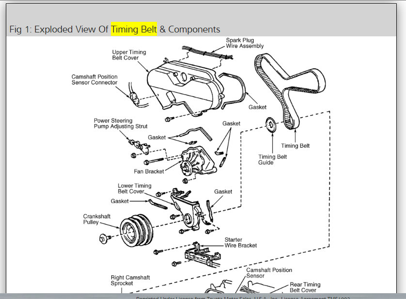

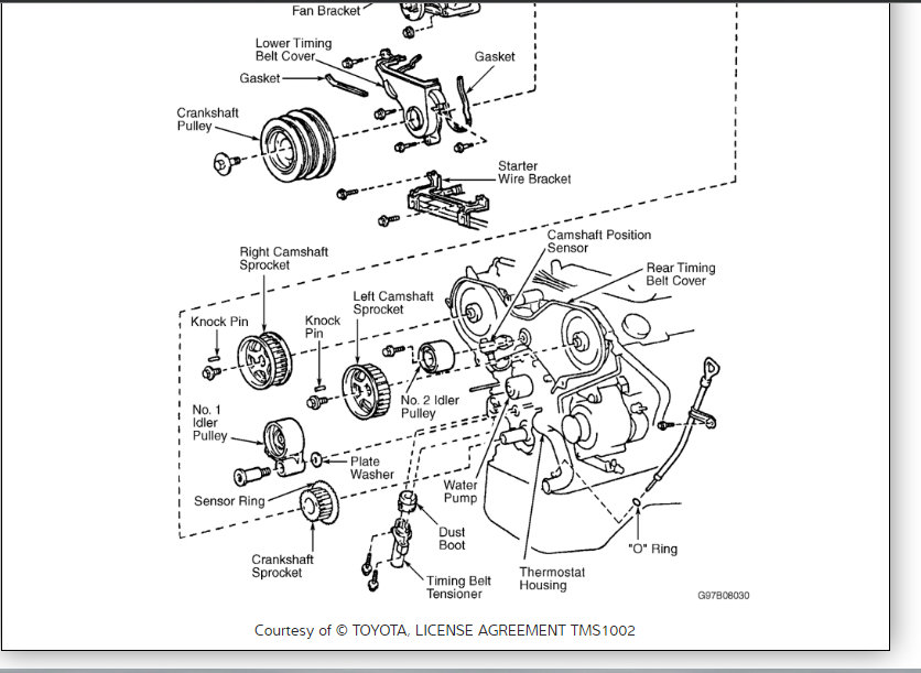

I have included the factory directions for the timing belt installation in the diagrams down below. Please go through them and get back to us with what you are able to find out, please. If you have any other vehicle questions, please feel free to ask. It's what we are here for.
