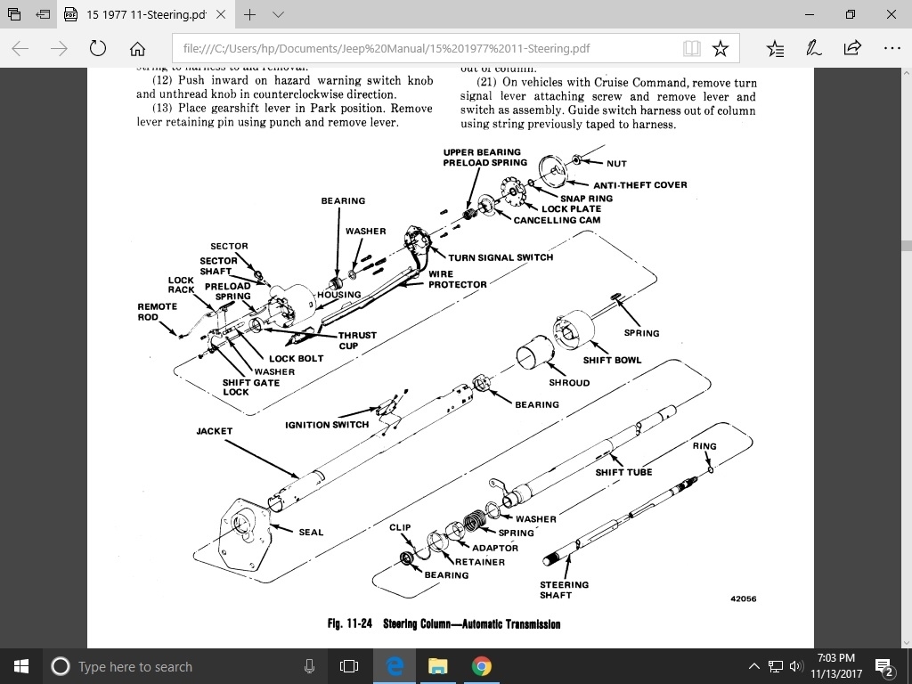

For a Jeep of that vintage you are probably going to need to find a salvage yard or go to one of the aftermarket companies like Novak or Lokar and get one of the cable kits they sell. Eliminates a lot of extra parts.

Take a look here, there are some pictures in there showing the stock column shift linkage. Personally I'd switch it to a cable system.

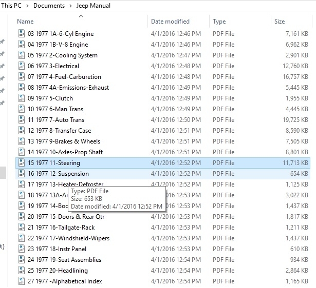

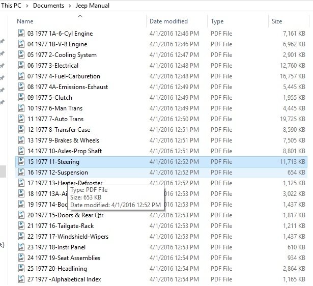

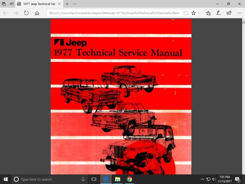

I have the whole '77 AMC Manual on disc (now on my computer), I also have a really worn '79 AMC 2" thick paper manual.
I seldom see automatic CJs, but I don't think quadratrac changed over the years.
Having an AMC manual is the cat's meow, even with an older one, much of the stuff didn't change. By '79 the fuse box changed not much else, not until they stuck a computer in 'em and a T-4 (4 spd) and T-5 (5 spd) tranny. But still most of the other stuff did not change.
I'm not Bill Gates by far,
If you really gotta have it.
If you can tell me how to do it (exactly) if it can be done.
I'll send you the '77 manual
Or at least the steering, auto tranny, quadratrac sections
They are PDF files
I'm a PDF (pretty dumb feller) when it comes to sending lots of pics or anything else in Yahoo email.
Let me know the plan, I'll try to comply.
