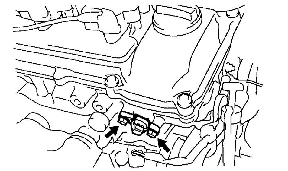

Location for camshaft position sensor.
Nov 17, 2019 at 9:58 PM
Good afternoon.
It is on the side of the head. I attached a picture for you to view.

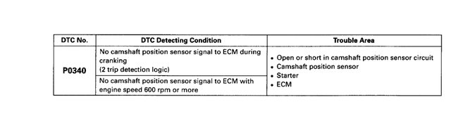

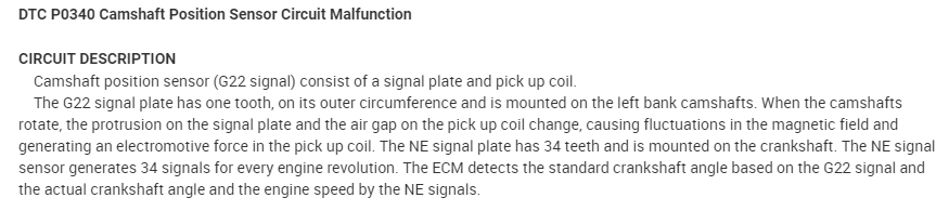

Thank you so much. I'm replacing it because I've had a lot of trouble with rough idle in and then the coats at po340 and when I pull my camshaft sensor off it still runs.
Nov 18, 2019 at 6:00 AM
Okay, that is most likely not the reason for the rough running at all. As far as removing the connector, it will stay running. That is not a test.
Did you check the code after doing that or was the code present before you removed the connector?
