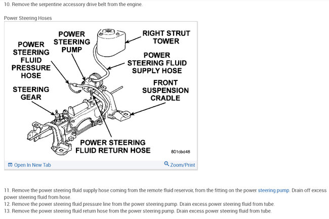

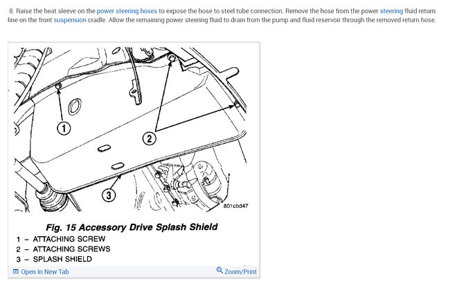

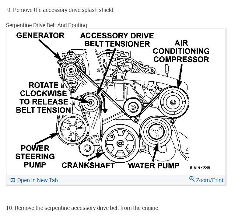

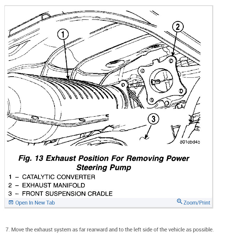

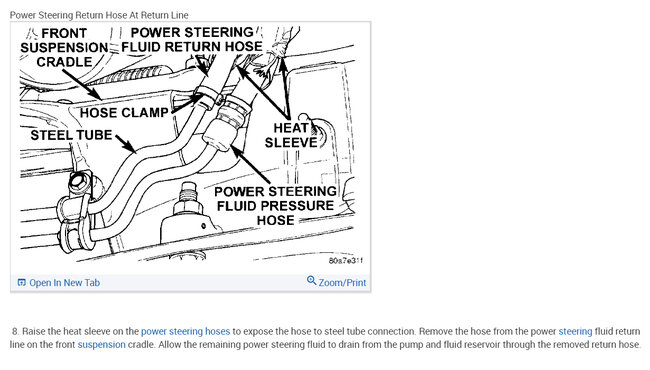

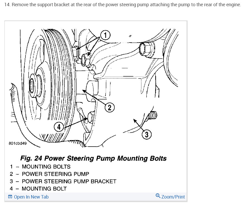

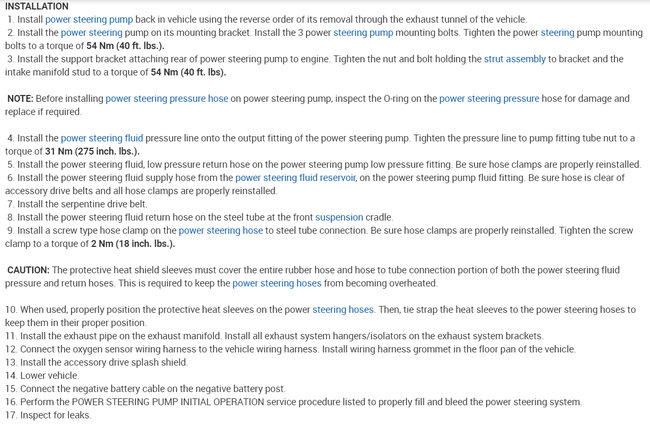

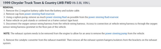

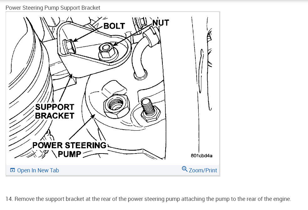

What size nuts and bolts do I need for power steering pump bracket?
Aug 10, 2023 at 12:58 AM
  • 55,412 POSTS
It looks like the nut and bolt size is 15mm, here are the instructions on how to change the pump out in case you need them. Check out the images (below). Please let us know if you need anything else to get the problem fixed.
