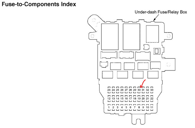

my son was messing around under my steering wheel and now my heater, my ac, car seat warmers, mirrors don't work.
Nov 19, 2023 at 2:10 PM
  • 55,433 POSTS
Sure, there is a 7.5-amp fuse under the dash #30 that sounds like it went out or was removed. This fuse runs all three systems that are not working. here is a guide to help you test for power and to see if the fuse is good or not:
Here is the location of the fuse. Check out the images (below). Let us know how it goes.
