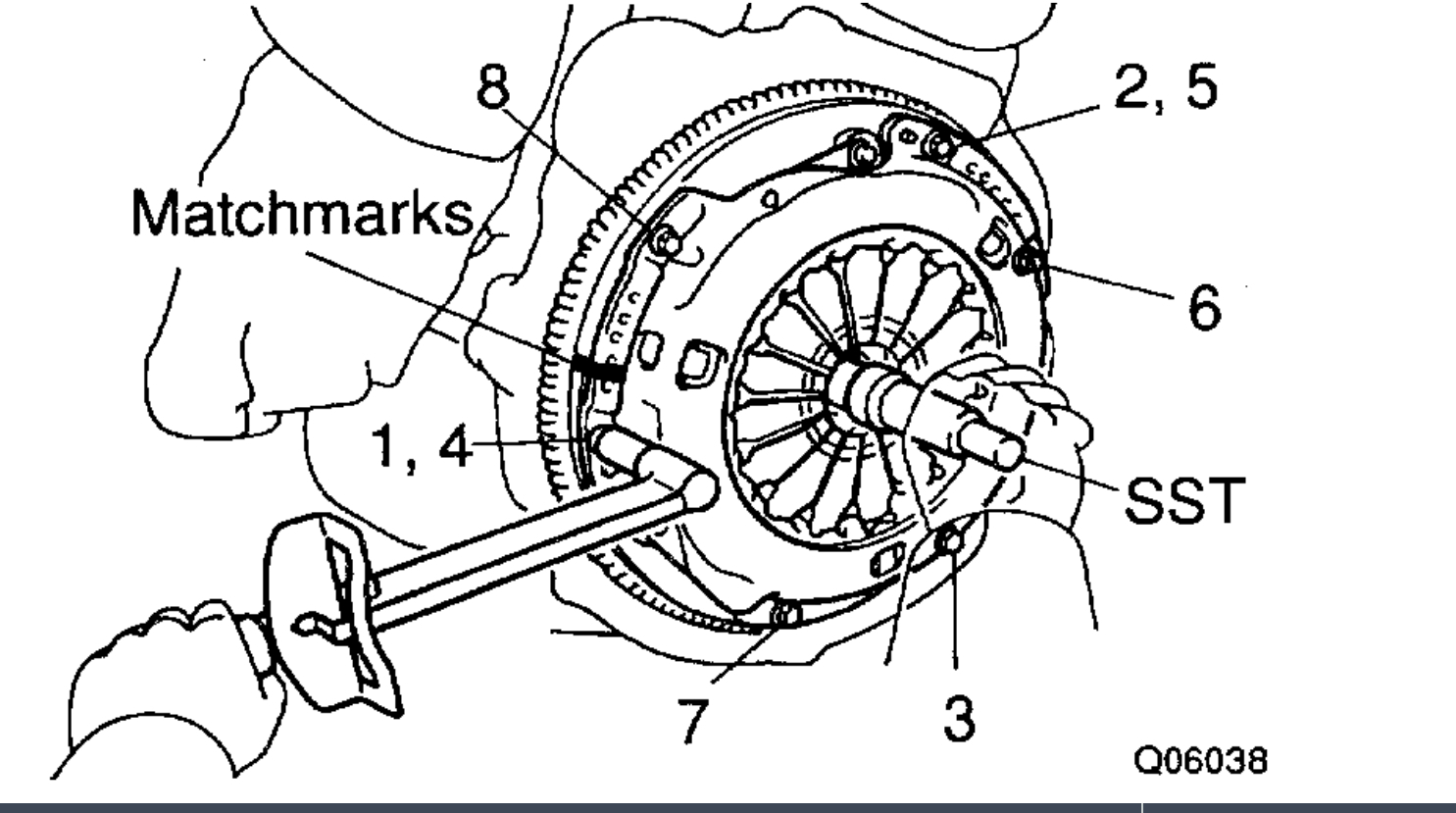

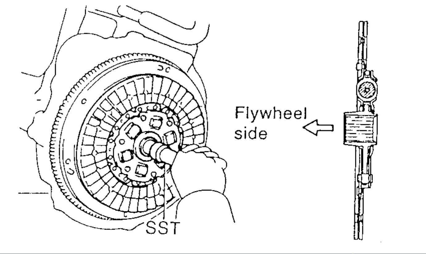

I have the vehicle listed above with diff lock. I have it all the way down to changing the clutch I just took the old clutch out and I did all this with the motor still in the car. I only pulled the transmission but I noticed that it doesn't have a pilot bearing when I pulled it apart but one came in my clutch kit. so is it supposed to have one or not ? Also If not I do not know how I would go about using the align tool because it's supposed to slide into the pilot bearing. any help would be awesome. thank you

No, there is no pilot bushing for this. I attached the alignment procedure for aligning the disc and plate below along with the procedure for the clutch replacement.

CLUTCH UNIT INSTALLATION
1. Install clutch disc and clutch cover on flywheel.
a. Insert Special Service Tool (SST) 09301 - 00220 in the clutch disc, and then set them and the clutch cover in position.
b. Align the matchmarks on the clutch cover and flywheel.
c. Temporarily tighten the topmost bolt from the 3 near the knock pins.
HINT: Temporarily tighten the No.3 bolt.
d. Torque the bolts on the clutch cover in the order shown.
Torque: 19 N.m (14 ft. lbs.)

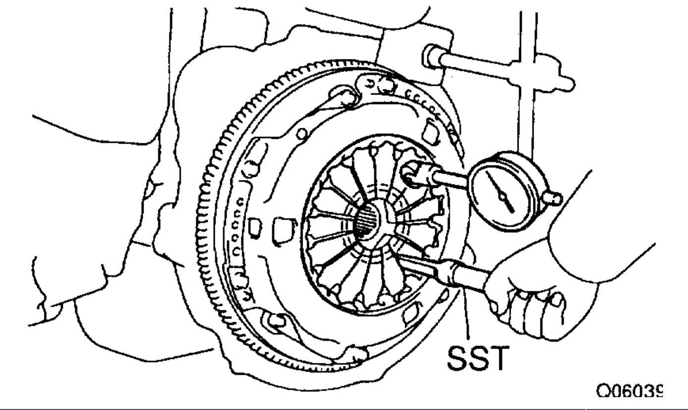

2. Check diaphragm spring tip alignment.
Using a dial indicator with roller instrument, check the diaphragm spring tip alignment.
Maximum non-alignment: 0.5 mm (0.020 in.)
If alignment is not as specified, using SST 09333 - 00013, adjust the diaphragm spring tip alignment.

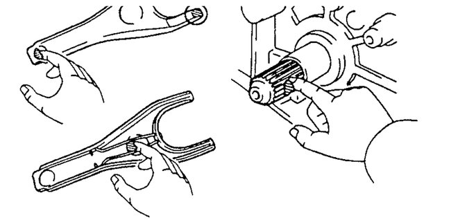

4. Install release bearing and fork to transaxle.
Install the bearing to the release fork, and then install them to the transaxle.
