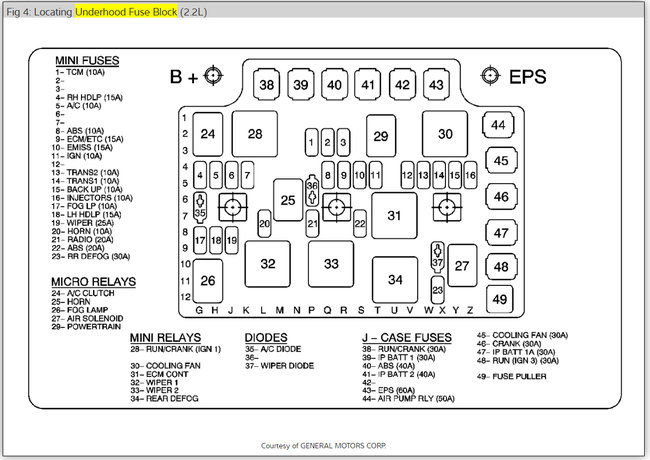

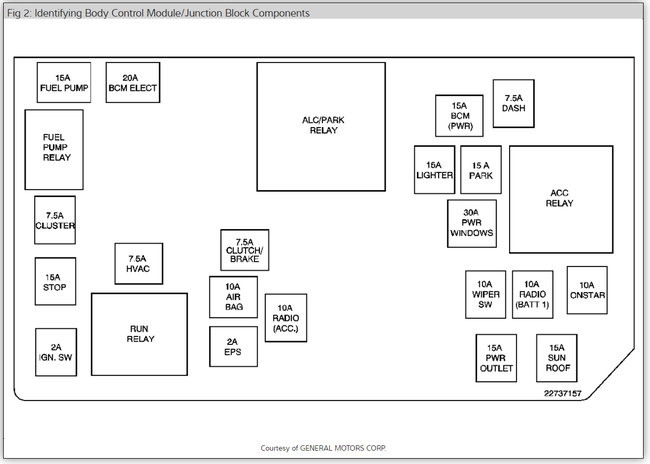

I was coming home from work and my dash lights and rear running lights are not working. I have changed the all the bulbs in the tail lights and still nothing
Oct 12, 2018 at 12:39 AM
  • 54,832 POSTS

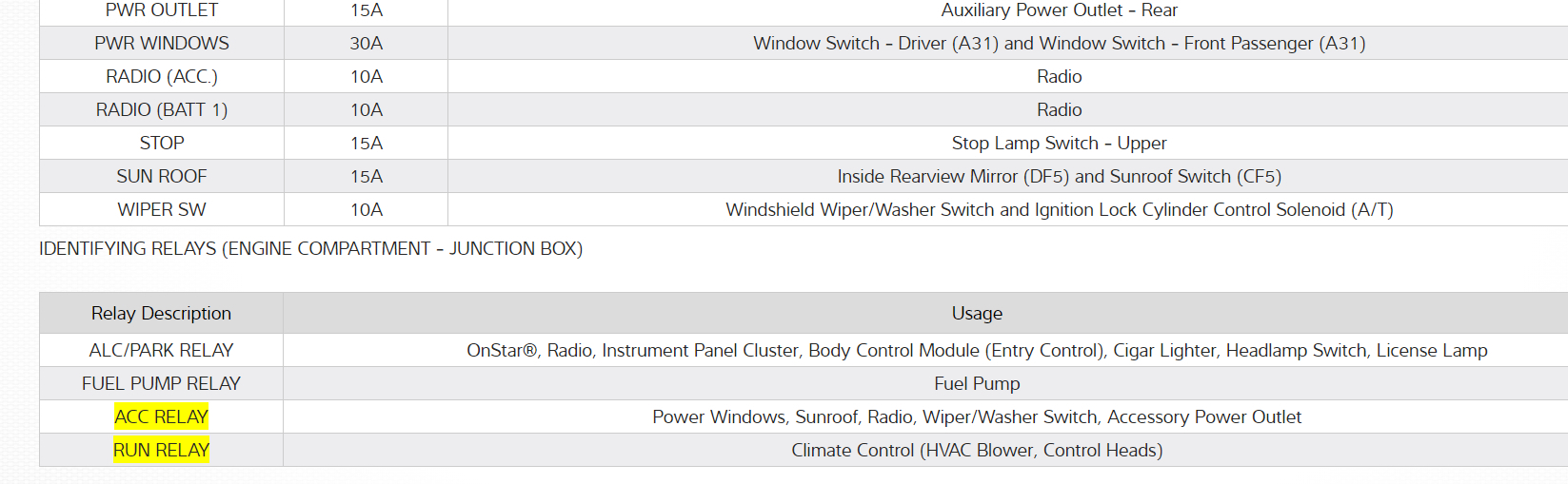

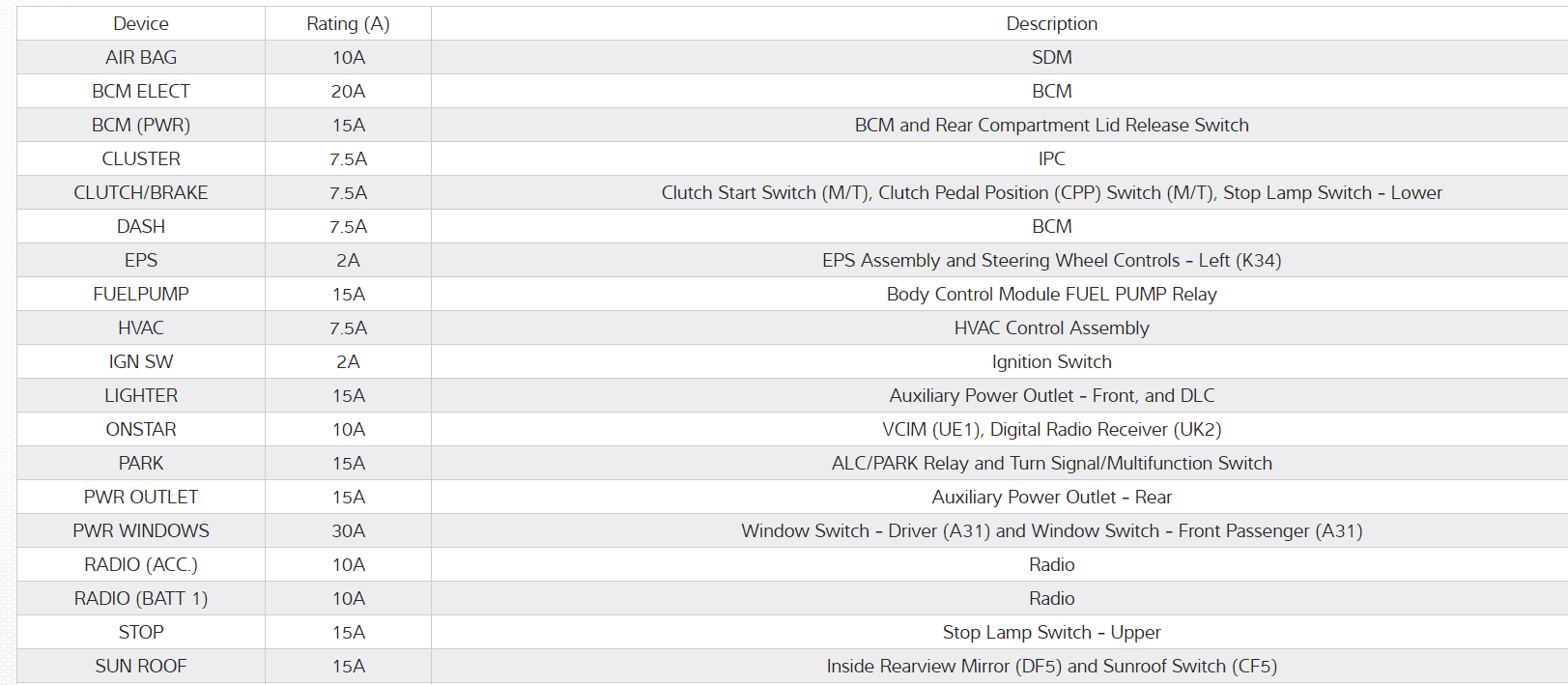

There is an ALC/park relay that needs to be checked also check for power at the park fuse. Here is the wiring diagrams for the running lights so you can see how they work and a guide to help you test the fuse and relay and the relay and fuse locations below:
