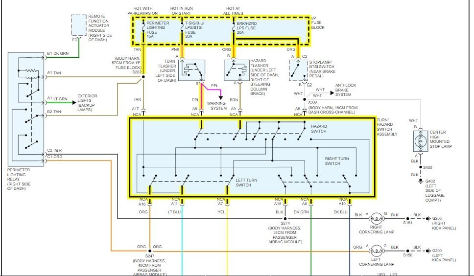

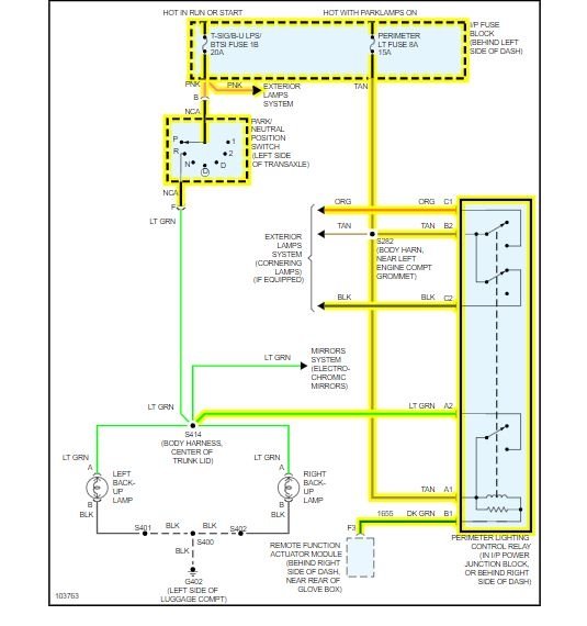

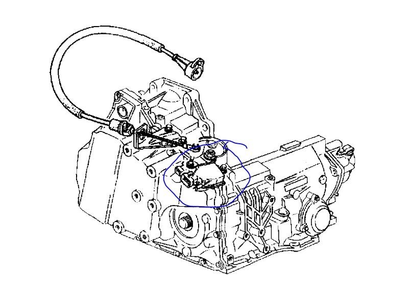

I can't find the reverse light switch. When i go in reverse it blows my turn signal fuse.
Jun 5, 2020 at 9:22 AM
Good afternoon,
I attached a wire diagram for you to view. Please tell me the exact fuse that fails when you put it in reverse.
I also attached the location of the reverse switch location.
