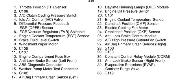

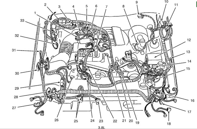

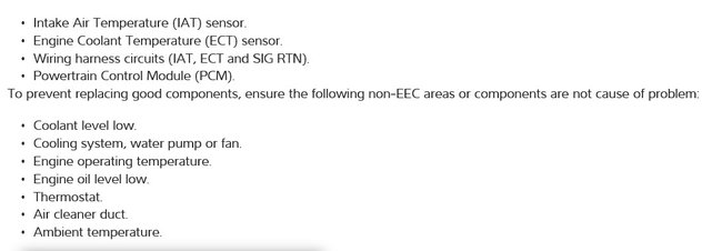

My car is throwing off code p0125 and I am trying to fix it because I need the car for work. I do not know where any of the senors are and money is tight.
Aug 19, 2016 at 2:06 AM
HMAC300
  • 48,601 POSTS
that is an engine coolant sensor maybe, check fluid and see if low if it is then have it pressure checked for a head gasket. see pictures for what to check and where sensors are located.
