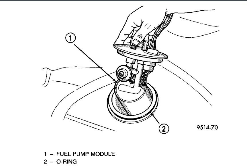

I got it down to a half a tank of gas or a little less a car shuts off at a stop sign or anytime. But starts right back up and goes again.

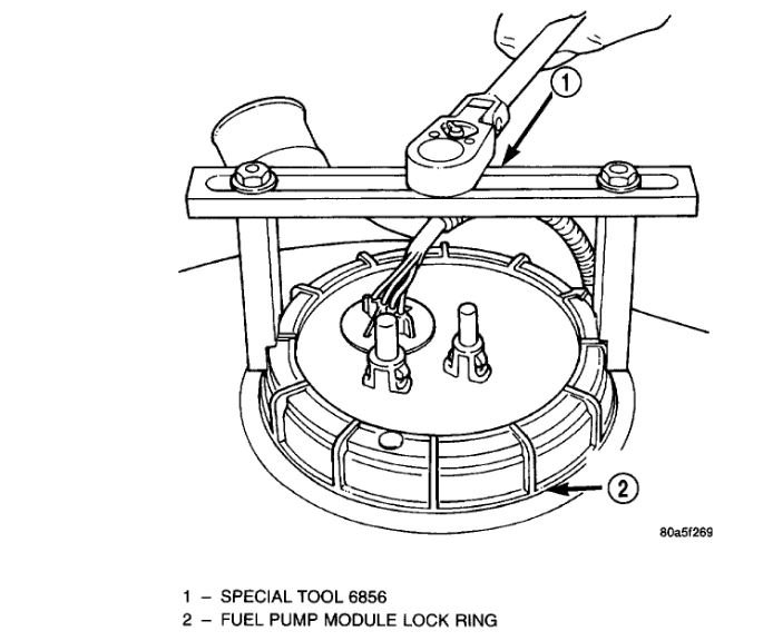

It sounds like the pick up in the fuel tank may be the issue. The hose connecting the pump to the pick up may have a hole in it not picking up fuel when the level gets to that point.
https://www.2carpros.com/articles/how-to-replace-an-electric-fuel-pump

It is, canister type pump.
As long as your driving on highway it's fine until you slow down and stop.

I know the design.
Based on your input from the original post, it indicates it is not picking up fuel.
Can you check the actual pressure?
