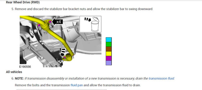

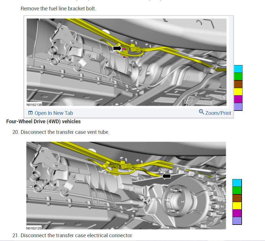

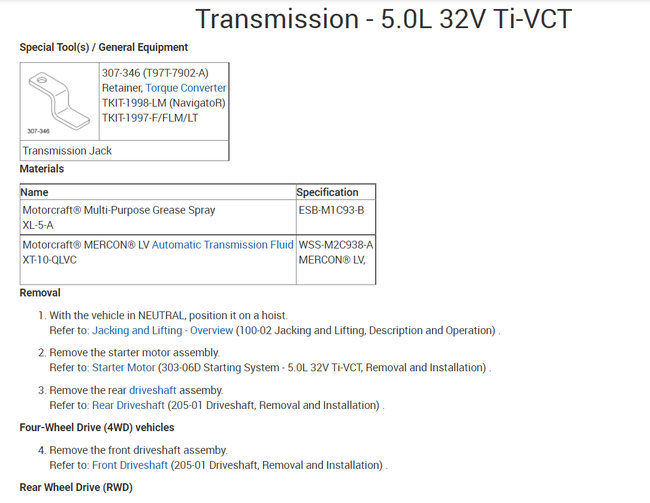

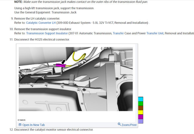

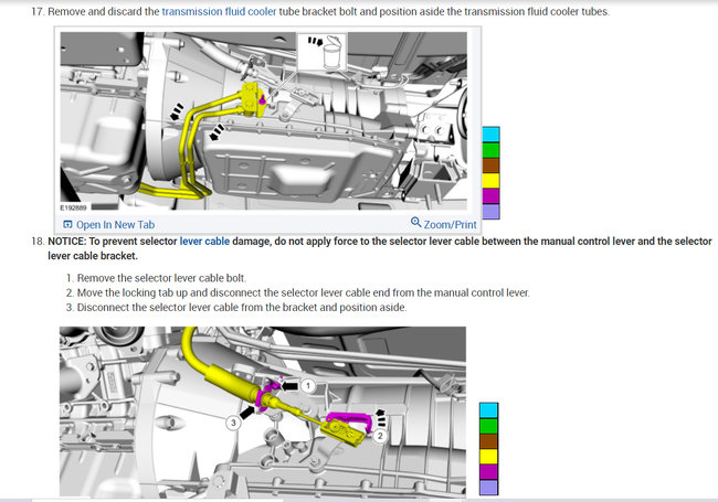

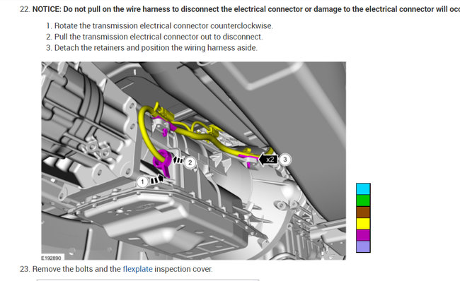

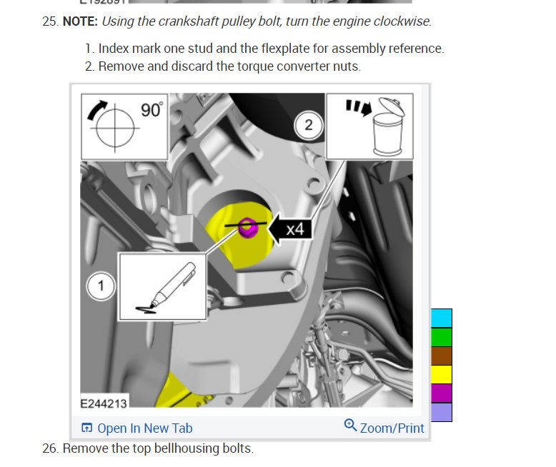

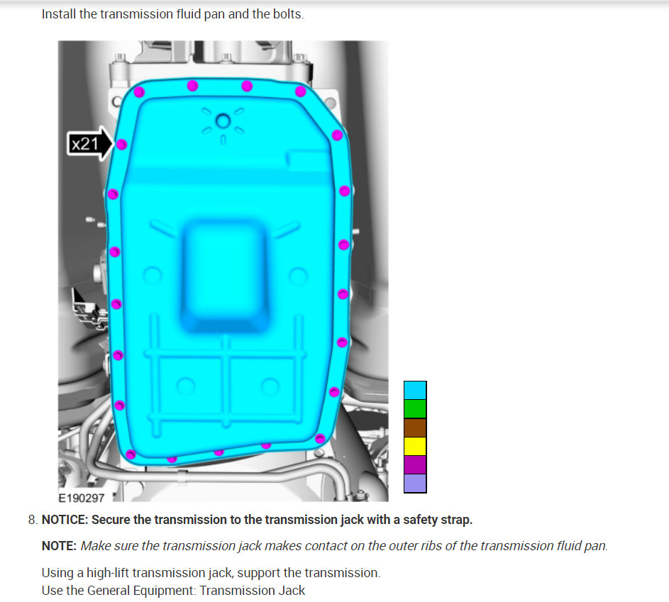

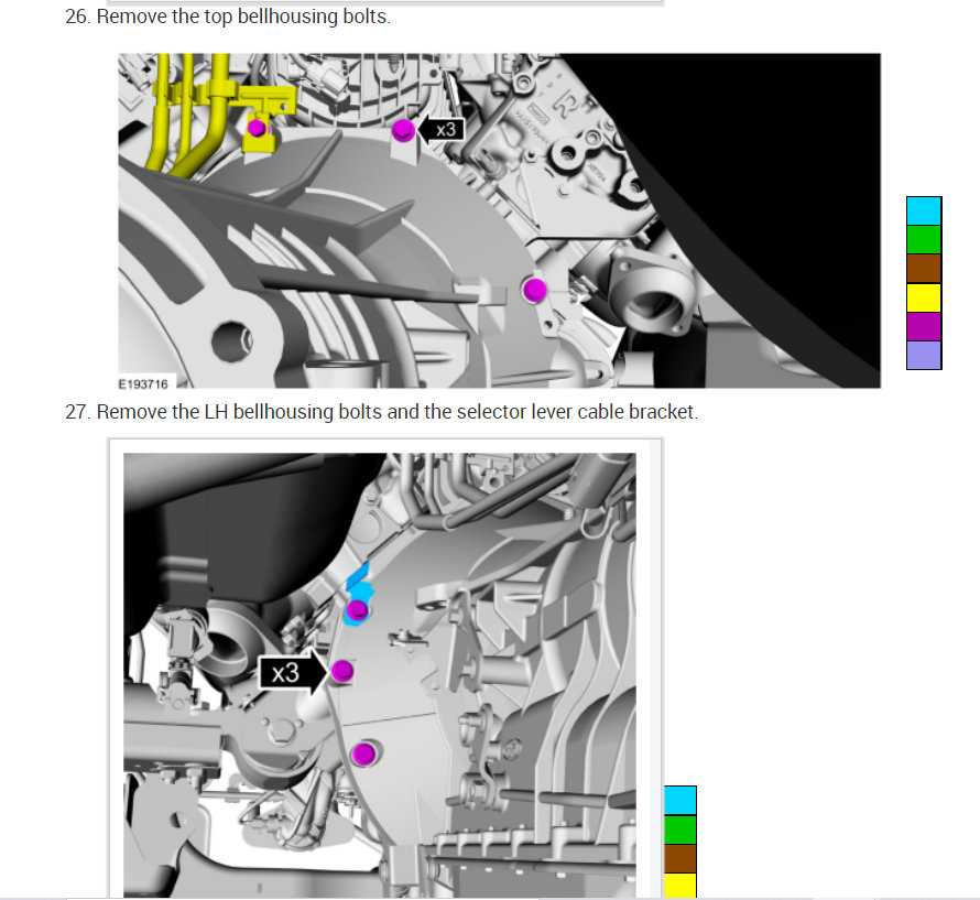

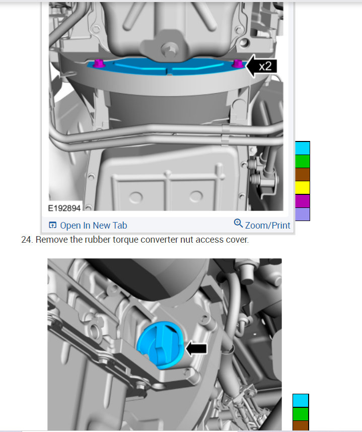

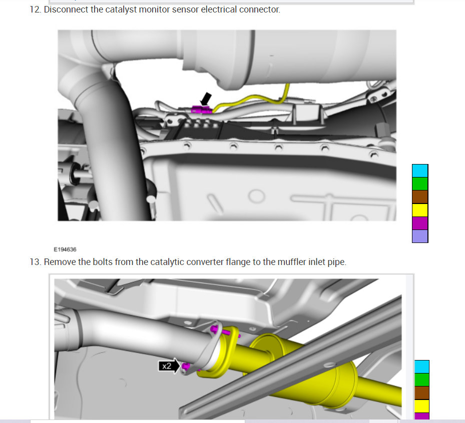

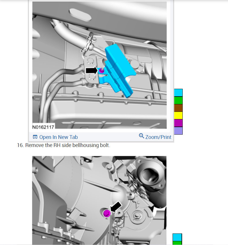

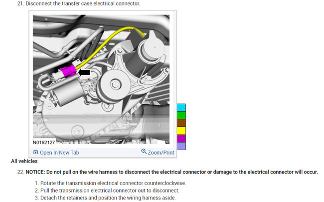

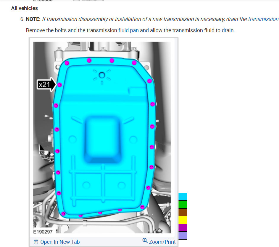

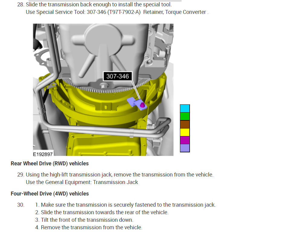

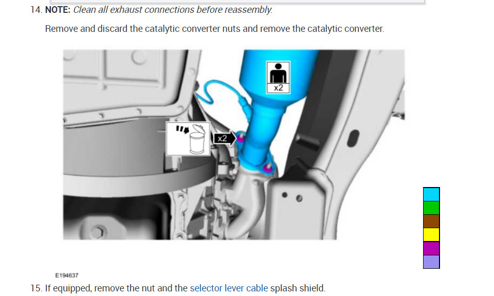

That noise sounds like the torque converter itself. I would have it confirmed by someone. There may be debris in the converter from the original replacement.
Roy I attached below the procedure for replacing the converter itself.
Let us know if you have any other questions.
