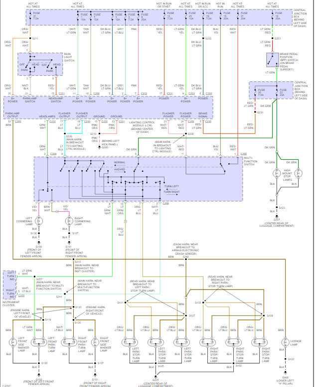

Turn signal don’t work inside and only the passenger signal light turns on but isn’t blinking. Driver side headlight is really dim. Brights just flicker and turn off.

Hi Cmax43, my name is Alex and I will be glad to help you with your problem. This sounds like it could be a problem with a ground wire to your lighting control module. This module is located behind your dash. Here is a helpful link and a wiring diagram for lighting control module: https://www.2carpros.com/articles/turn-signals-not-working-blinker
