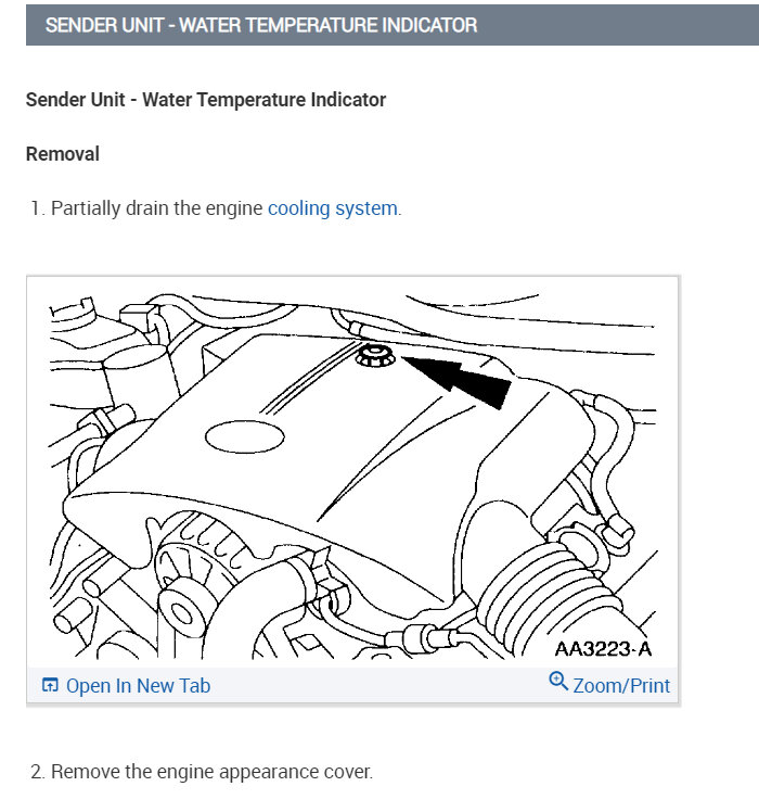

I’ll be driving and my temperature gage is normal then all of a sudden it’s kind of like sputters then temperature gauge max’s out and it shuts off. If I wait a little bit it will start?
Oct 15, 2022 at 2:12 PM
  • 55,859 POSTS

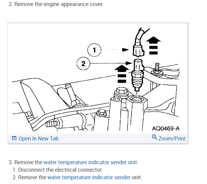

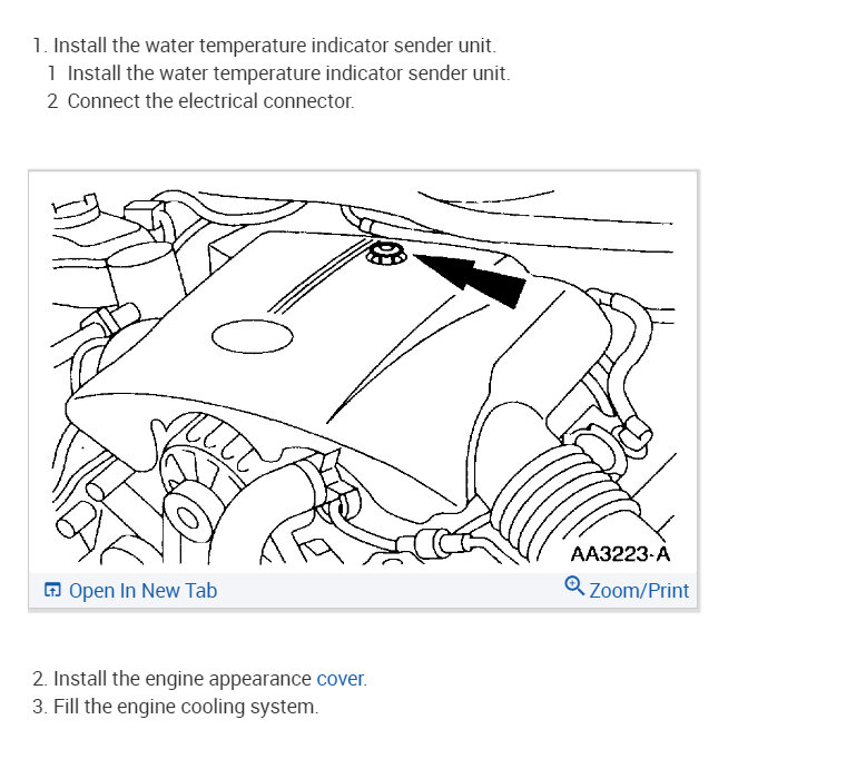

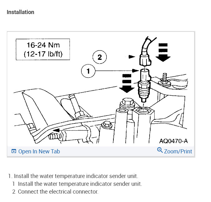

It sounds like the engine coolant temperature sensor is shorting out. here is the location so you can check out the wiring connector and the sensor replacement as well in the images below. Please let us know what happens.
Oct 16, 2022 at 5:55 AM
