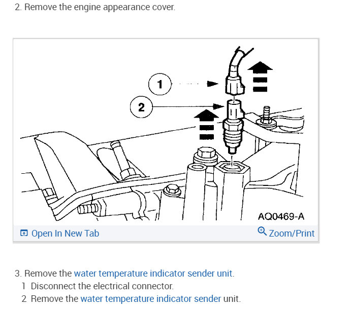

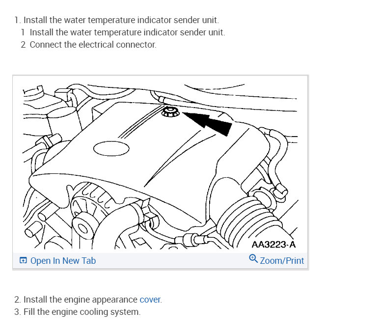

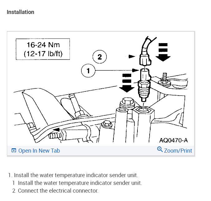

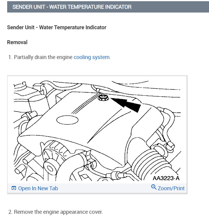

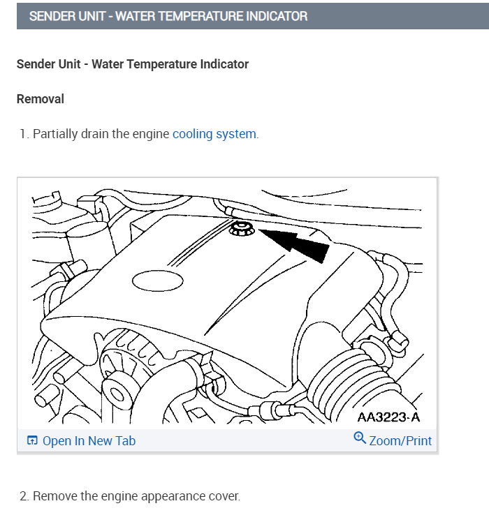

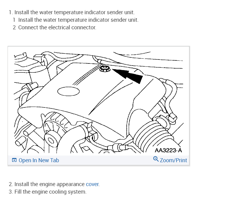

It sounds like the engine coolant temperature sensor is shorting out. here is the location so you can check out the wiring connector and the sensor replacement as well in the images below. Please let us know what happens.
