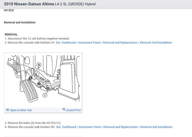

Codes p0Ac4 and p0a94, vehicle shuts off while idling and at high speeds?
2010 NISSAN ALTIMA HYBRID
45,000 MILES • 4.2L • 4 CYL • 2WD • AUTOMATIC
DAUDA
The vehicle shuts off at speeds or sometimes it just shuts off while idling. I have a fault codes of p0Ac4 and p0a94.
Jan 29, 2023 at 1:02 AM
  • 55,433 POSTS

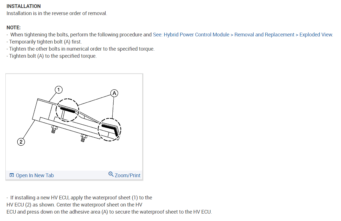

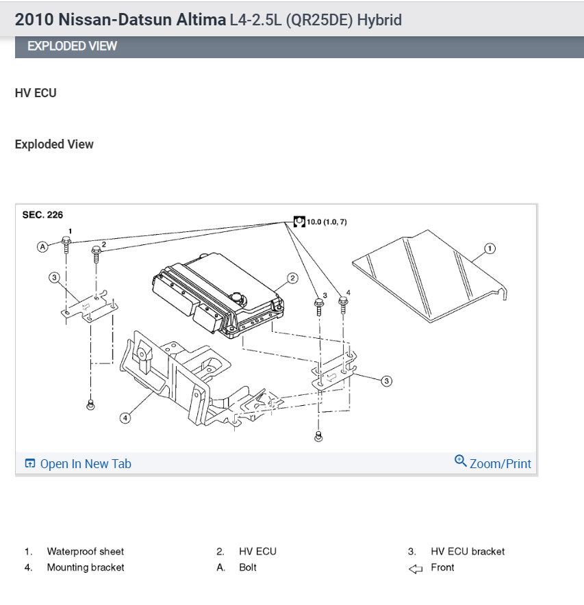

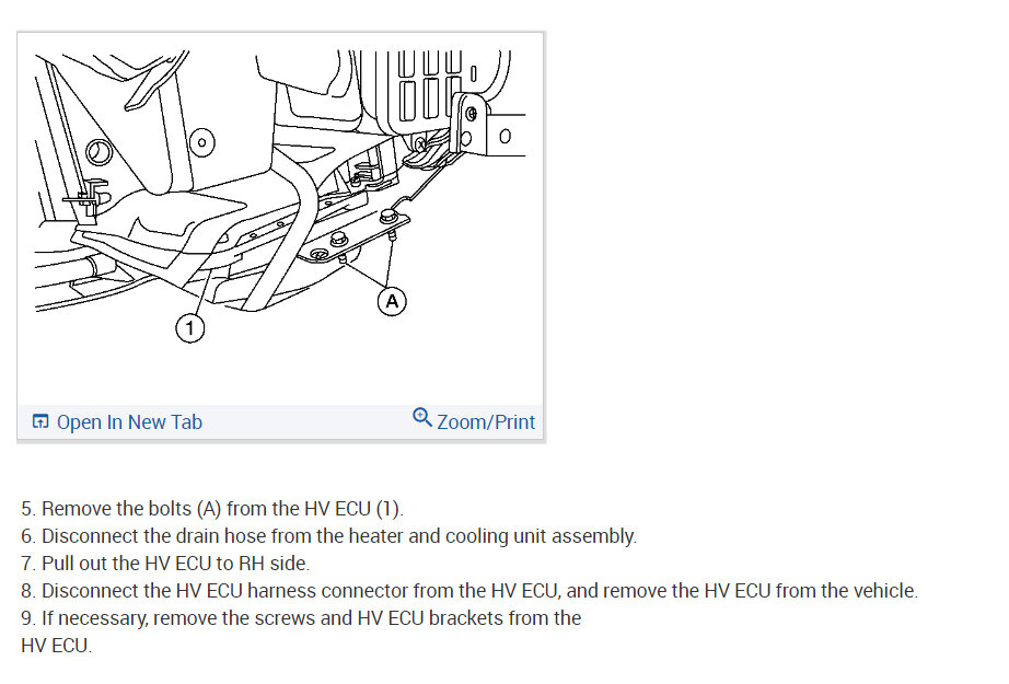

P0AC4 code indicating the hybrid powertrain control module has set an emission associated hybrid powertrain code and P0A94 means the hybrid system control module monitors high voltage going into and out of the inverter. Here is how to replace the module which is easy to do because it-self learns in the images below. Please let us know how it goes.
