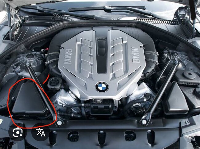

engine parts are missing from it?

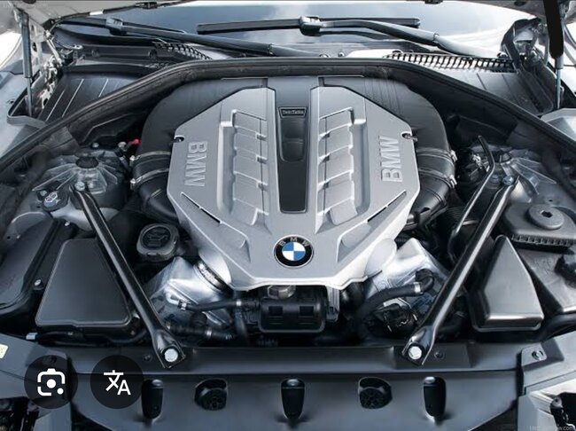

It's a v8 please check the sound of it and let me know is it normal sound or anything is out of normal. Also. I saw some missing parts of engine if you can see how many parts are missing from it and what thing are abnormal from a normal n63 engine for reference I'm providing an engine from a factory new engine and the other cars engine it's driver 87000kms not miles kilometers. please help

The video.

This is brand new engine photo for reference.

It looks like the right-side air duct is missing. If you look in your video the circled part and the duct under it are missing. You can see the open section that it connects to in the video. I would replace that then see what the noise levels are. The open intake leaves a lot of noise in the background, so any odd noises were hidden.

BTW how does the engine sound is it sound healthy or abnormal.

Can't really tell because of the intake noise. I don't hear anything destructive but that doesn't mean much. I would wonder why that part was removed though.
